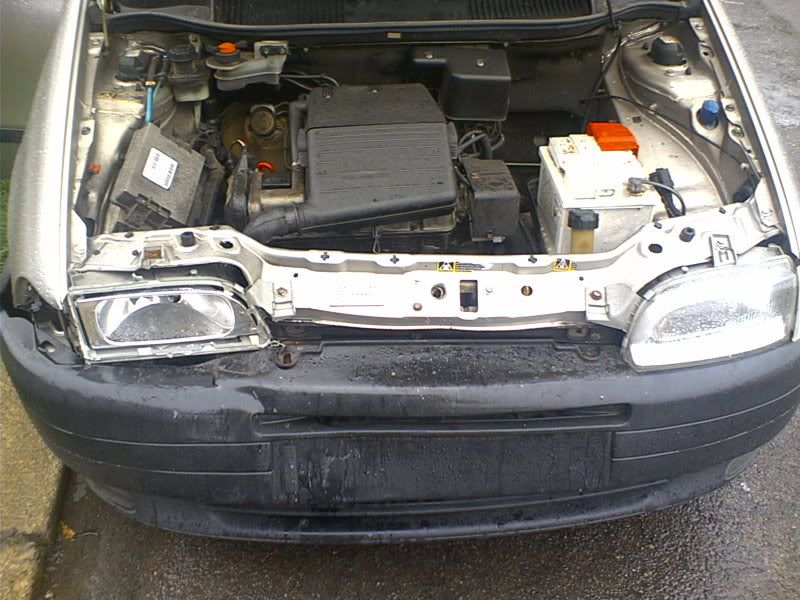

I don't know, I think its an Spi, it has a similar airbox to those that I have seen on punto 55's (definately on Beau's selecta). I'll need to find time when he's in and I'm in, as I see him very rarely even though he's only 100 metres up the road.
Looked similar to this when i had a quick peek under the bonnet one night,
The airboxes on 1.1 Fire Uno and early 55 Punto are AFAIK identical, I also think that the engines (1108 ccm Fire) are identical.
If it is 1.1 Fire 60 Uno, then it is most probably Bosch Mono Jetronic SPI - although I would not bet my life on it, it seems that carbs were used for the British market long after they disappeared from continental Europe.
I would follow the obvious route (either there is no petrol or there is no spark to ignite it), i.e. HT leads, coil, fuel filter/pump, electric connections on SPI module etc. etc.
Do not forget to check the cambelt and cambelt tensioner. If faulty, you will have a reason to adore the Fire engine design - it is cambelt-snappage-proof :cool:.

Yeah I know what i'm checking for, but was having to make a prognosis from not seeing it, and wondered if anything was majorly different to the Cinq or i should be looking out for anything in particular, but guess not if it is SPi.
