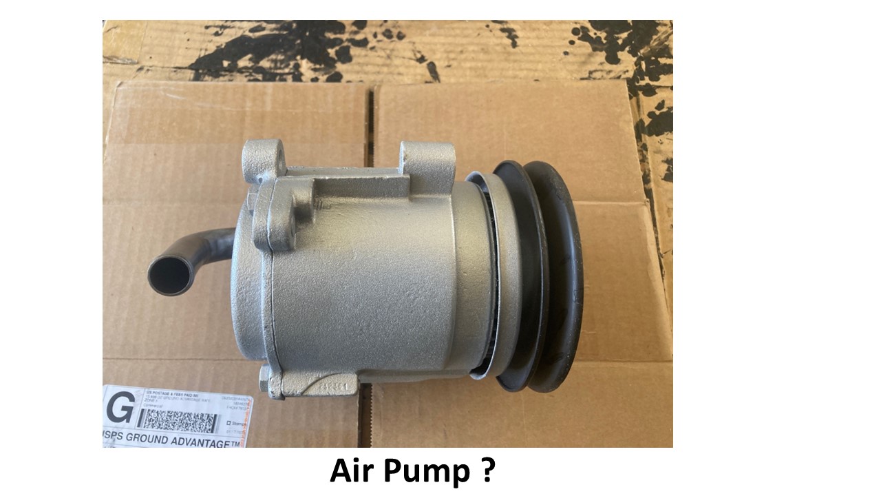

- Air Pump: Anyone know what this does? Does anyone know if I need it here in California? Facing the engine compartment from the front bumper looking in on the left side down low there looks like a bracket that will hold this in place and there is a V-belt that connects this to the engine and a single hose, anyone know where the other end of the hose goes?

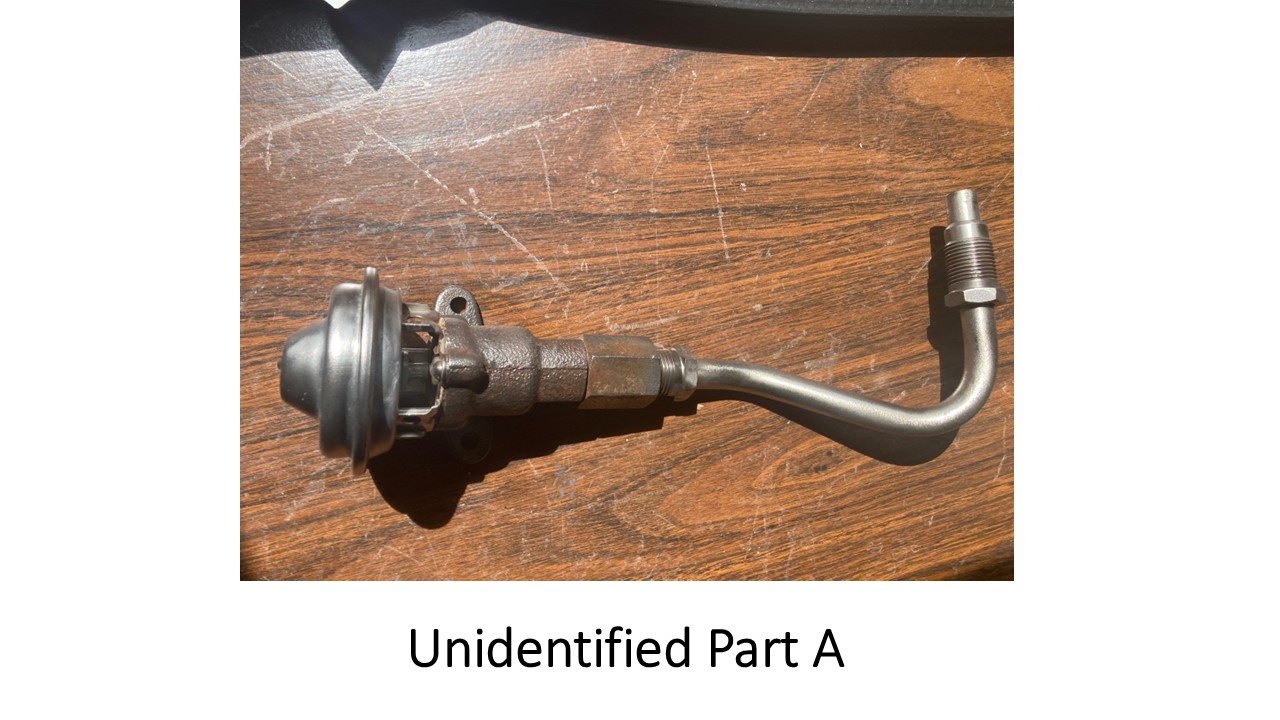

- Unidentified A: What is this and where does it go?

The air pump is part of the emissions control system for exhaust tailpipe emissions

You will need to get advice from US owners as these systems were either not fitted or removed from European cars
