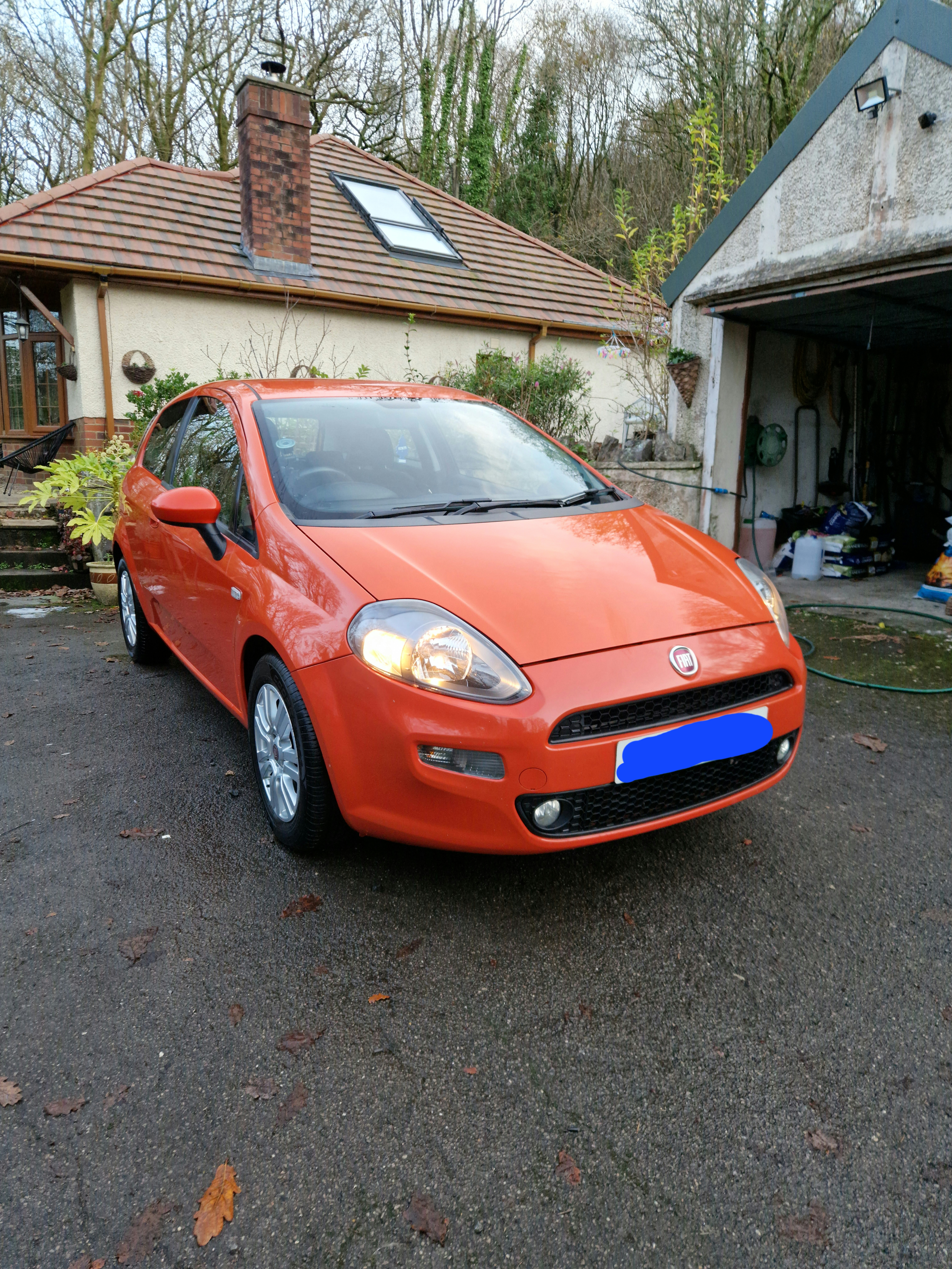

So I have a 2014 punto city and I have always wanted to put the evo front and back bumper on the car now is the perfect time as there is some damage to my current set. Does anyone know if the bumpers are compatible or not?

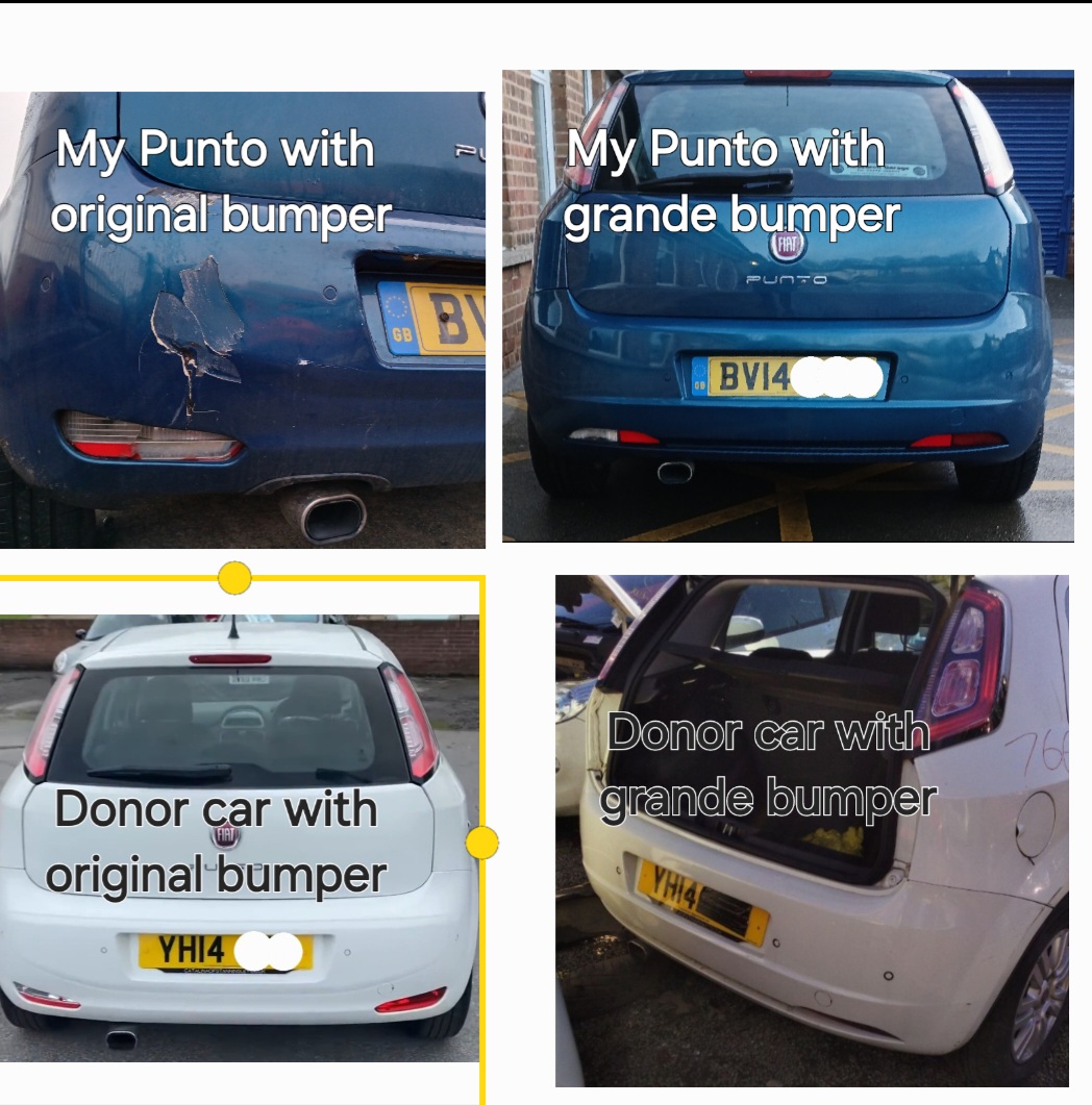

Hi All,
My 2014 Punto Easy got rear ended and now has a Grande rear bumper - aquired off another 2014 Punto Easy that got rear ended and had it changed for a Grande rear bumper. Lol, my quest to get the correct bumper by finding a matching donor car resulted in me getting the wrong bumper 😂😂 I actually found an old for sale ad online for it with the original bumper on!
Yes, the rear bumpers are all interchangeable across Grande, Evo and beyond. The front however, is not due to the shape of the lights - you would need to change those too.

So I have a 2014 punto city and I have always wanted to put the evo front and back bumper on the car now is the perfect time as there is some damage to my current set. Does anyone know if the bumpers are compatible or not?View attachment 465199
