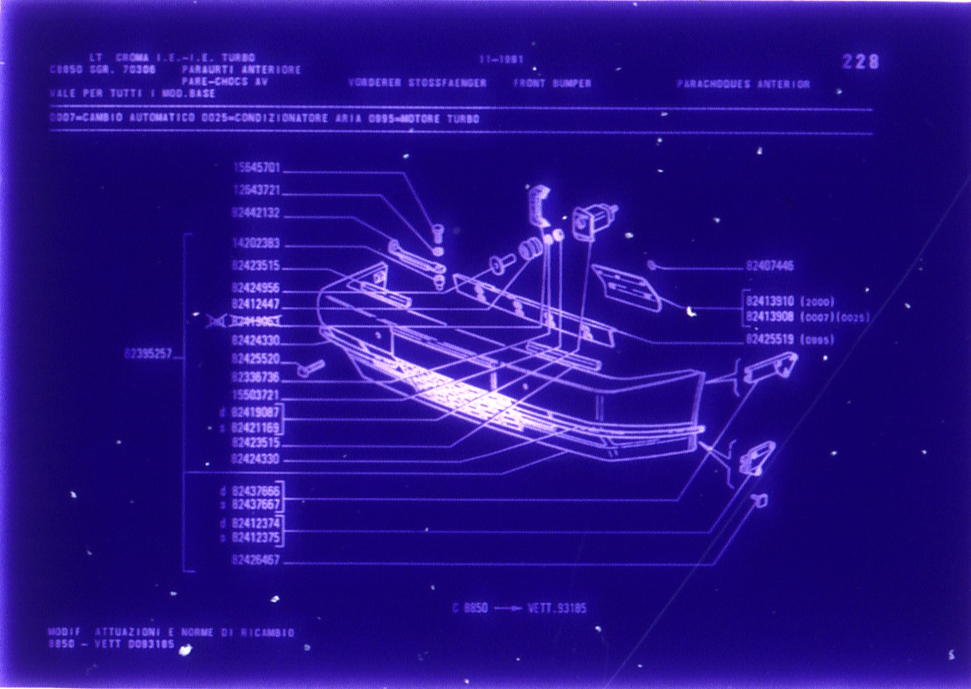

Hi Davren,
I hope that you can help me out, once again…..
I am after:
Gas struts for the tailgate (mechanic tried sourcing them using the product codes printed on the strut body but had no luck….)
Securing clip for the bumper end – front, driver’s side
Silver trim for the bumper/windscreen
Hope to hear from you soon.
Thanks!
These scans from the Croma 154 Micro-Fiche show part numbers. Highly unlikely that anything would be available though.

Hi Davren,
I am after:
Thanks!
Hi,
Thanks for your quick response and effort in finding the part numbers. Not looking good but I will pass them on to our mechanic.
Always worth a go (a search) though….
