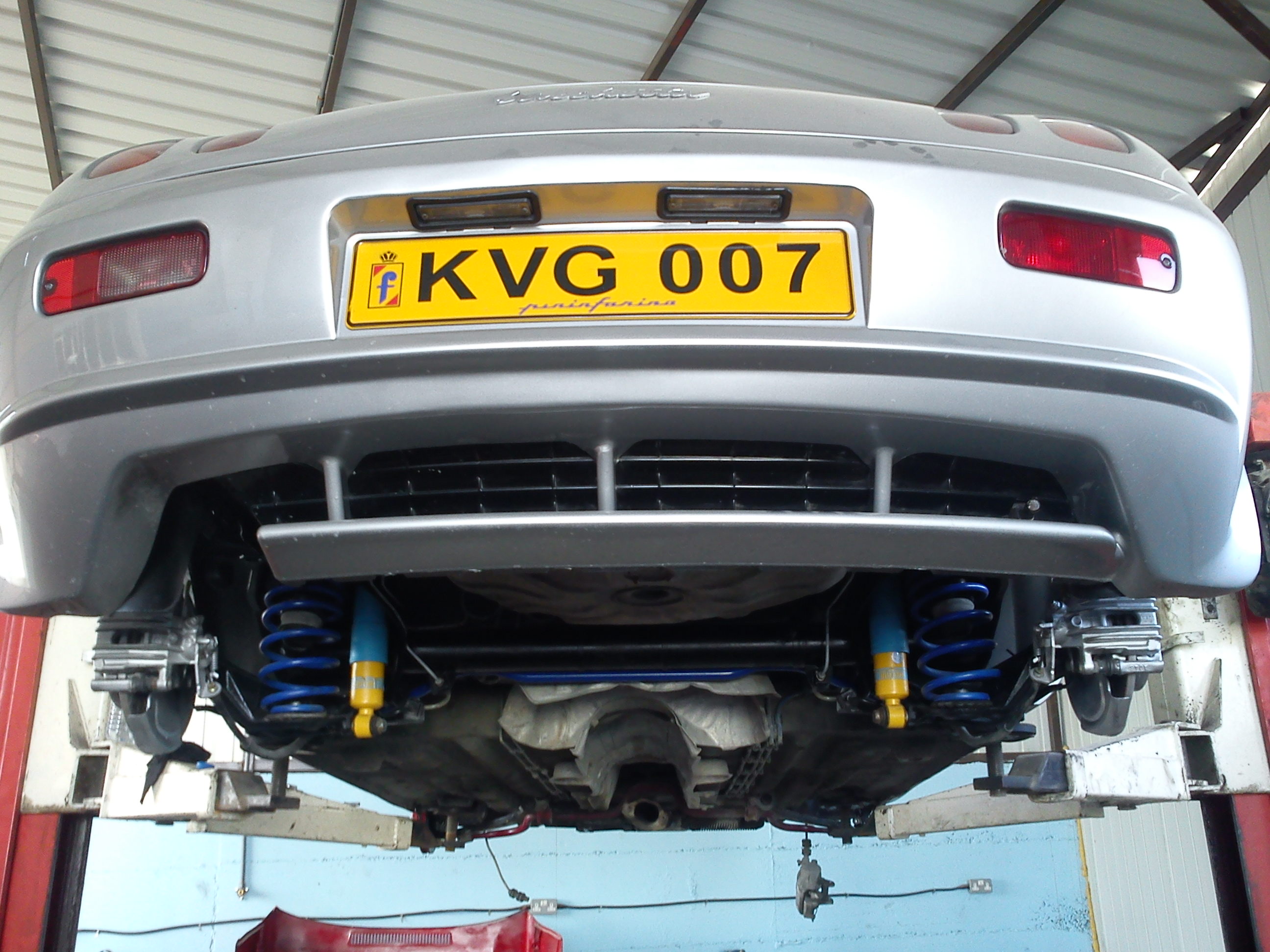

Hiya! Chris,
A strut brace is the silver metal bar you can see in my signiture picture,
It bolts onto the suspension top bolts and is used to help stiffen the vehicle chassis when cornering. Its a worthwhile modification to be had, especially to a convertible vehicle such as the B.
The Anti roll bars i mentioned earlier are the bars on the underside of the vehicle ( the blue & red bars in the pic) which do improove the vehicles handling, The Eibach kit shown are thicker than the standard and help the vehicle to ride flater to the ground, producing less body roll and more grip to the tyres so handling / cornering is improoved.
Also a worthwhile mod, :)
