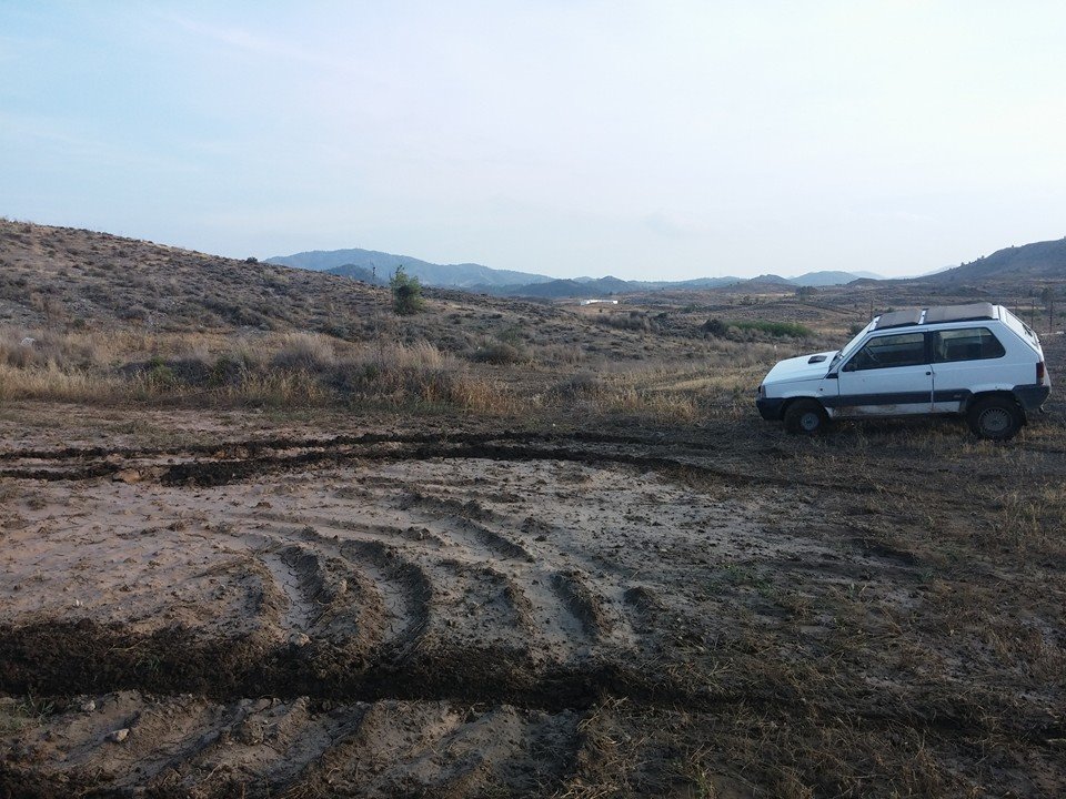

Long time to post an update :)
New tires fitted... 165/70/R13 on the Alfa Romeo 75 13's alloys.
Needed a 3-4mm spacers on the back. No major problems.
Maxsport RB1 Reinforced.
A short video i uploaded a couple of months ago after some summer rain in Cyprus and shortly after i fitted the tires.
