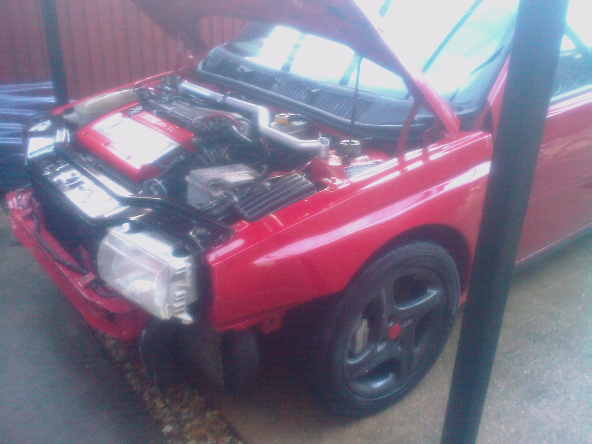

- WELL IT WAS A 1.4S NOW FITTED WITH 20VT

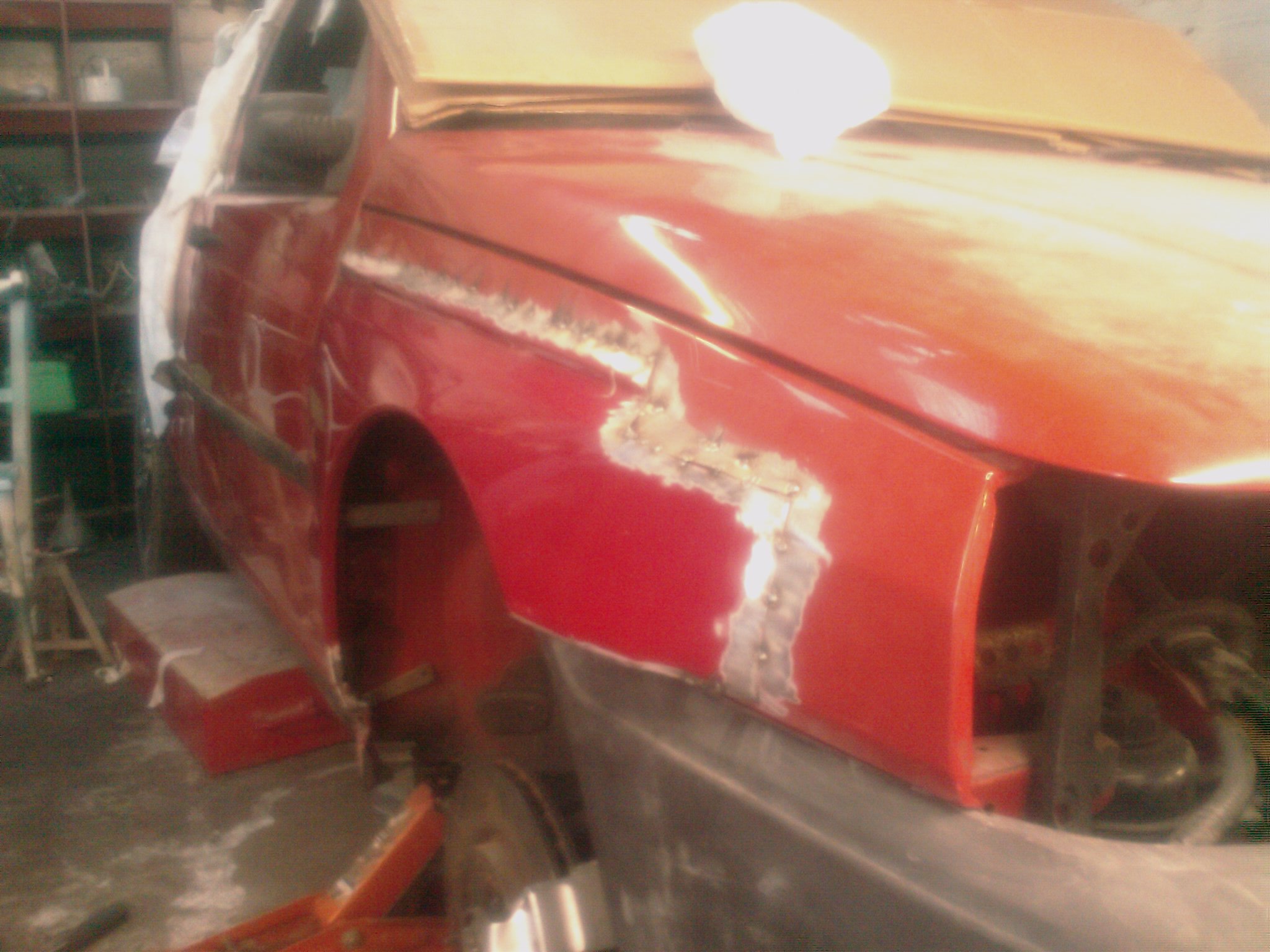

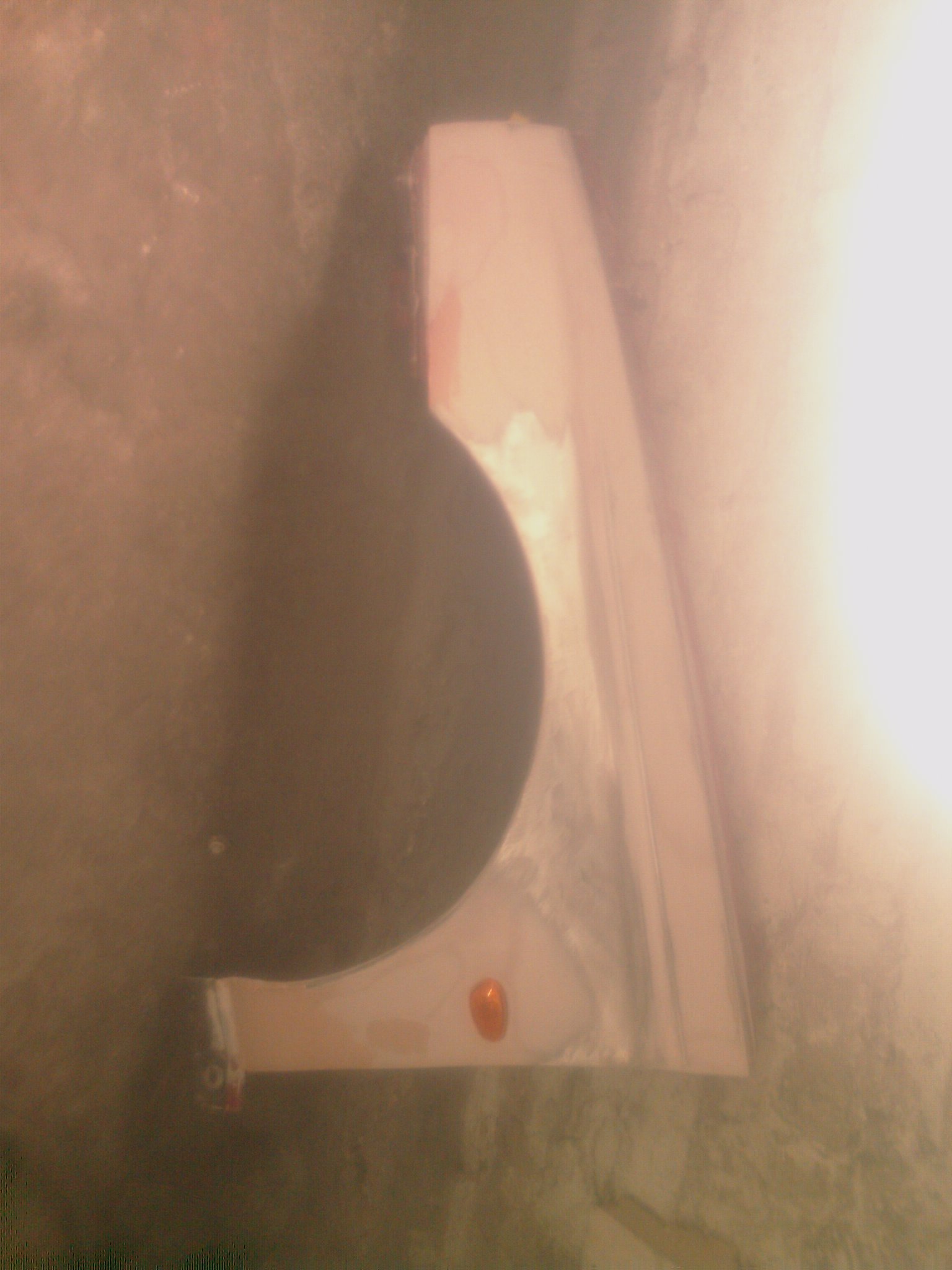

not cost alot im in motor trade so done everything myself lot of time the arches i made fro some alfa 145 wingsnice.. lot of work and cash put into it...
hey, what way you done arches?
to be honest most of it bolts straight on i kept the tipo subframe i did remove it and seam welded it. i used coupe[ wishbones hubs ,legs ,arb,steering rack,throtle pedal,ecu . wiring loom , fuel pump,gearstick n cables, renewed all brake pipes , did the engine wiring myself with some advice of the fccuk members ,done full paint job myself thats what i do for a living ,fitted aftermarket rev counter , made the wings from alfa 145 because the 20vt has a wider front track and the wheels stuck out quite a bit ,i refurb the wheels and painted them matt black and the bumpers same ,i done it all on a very small budget i already had the engine box wiring some of the suspension wheels exhaust brakes i brought cam belt sterring rack gearstick rear springs wishbones paint ecu i think in total it cost me about 500 including buying the tipo and then lots of hours but i was all worth it i do own a coupe 20vt thats why i chose to go with 20valve engine as the 16v one has been done quite a lot if anyone interested in doing this to there tipo i would be happy to help where i couldVERY NICEHow bigger job was it ? What did you have to change front end wise ?
thanx m8 i will be taking it to some showsThe car looks awesome mate really good job well doneMaybe see you at some car shows soon? maybe Auto Italia gaydon on 6th september im definately going
