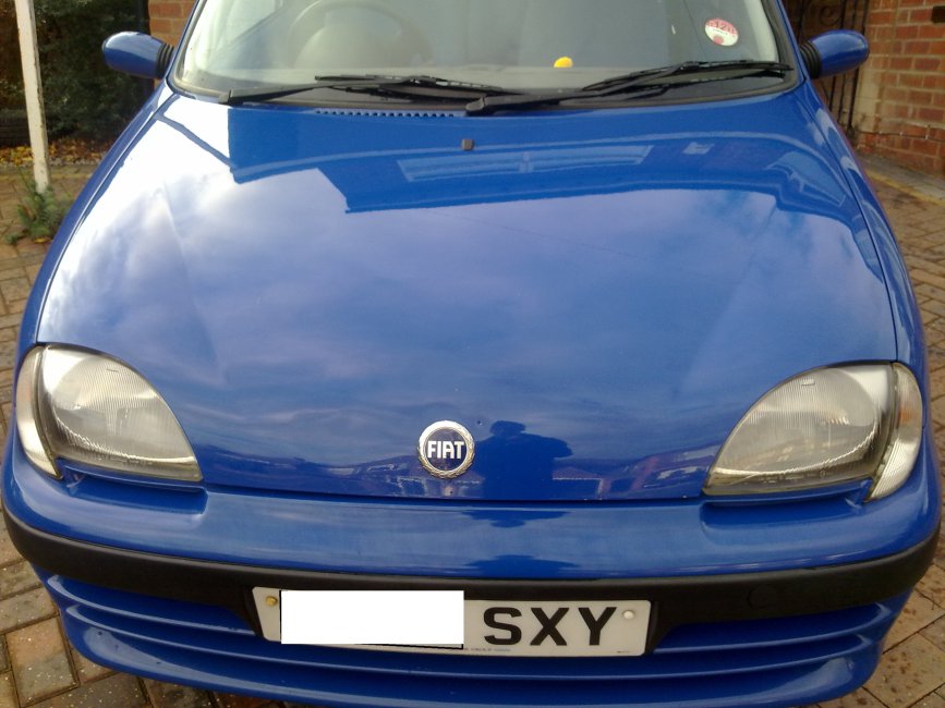

Seicento  My Pretty standard Blue Bug...
Not Modded at all.... all though electric sunroof ! FTW !
Nothing planned apart from some bits and bobs to keep it happy....
Would like an induction, but seen as im only young insurance is already high enough...
Would like to change the exhaust tip..but whats the point ?
Only on a tight budget, as still a full time student... So most things are out of the equation..
oil filter + oil changed is next on the list to do, dont think its been done in a looong while !
Also thinking about selling this at the end of the insurance year, and then getting a sporting ? Opinion ?
Its pretty much the only car i can afford the insurance for, and i've grown fond of other sei's on the road
Looking at the quotes for next years insurance, Drops to around £1400ish Third Party only, ( its at £2500 atm lol). A seicento Sporting gives my premium next year £2100.... so gunna stick with my bugg.
Seen as im sticking with it --> Induction kits are they worth it ?
