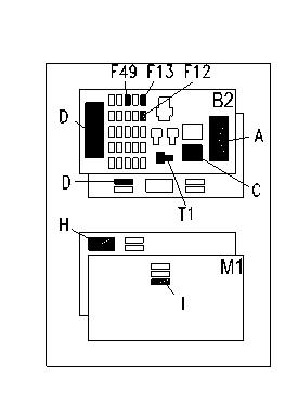

i have just had a look over the car and they are the dip beam lights i have looked over all the lighting fuses and they are ok does any one know what relay operates the lights?
It's relay T1 on the body computer fuse panel.

when i was turning the lights on there was a nocking coming from the relay is this a sign it is broken?i have now taking hte switch out was hardest thing i think i have every done it was realy stiff. but when i took the realy out it looked as if one of the legs has snaped off:bang: it has 4 legs is this the correct amount? worried now lol because it is starting to look expensive

What engine is this as each car can have different wiring diagrams? I'll post up a wiring diag
Check for power at fuses 12 and 13 as they are downstream from the relay. remove the fuse and check for power on one side of the fuse holder. Power there shows power is getting to and going through the relay so you can dismiss switches and relays after that
