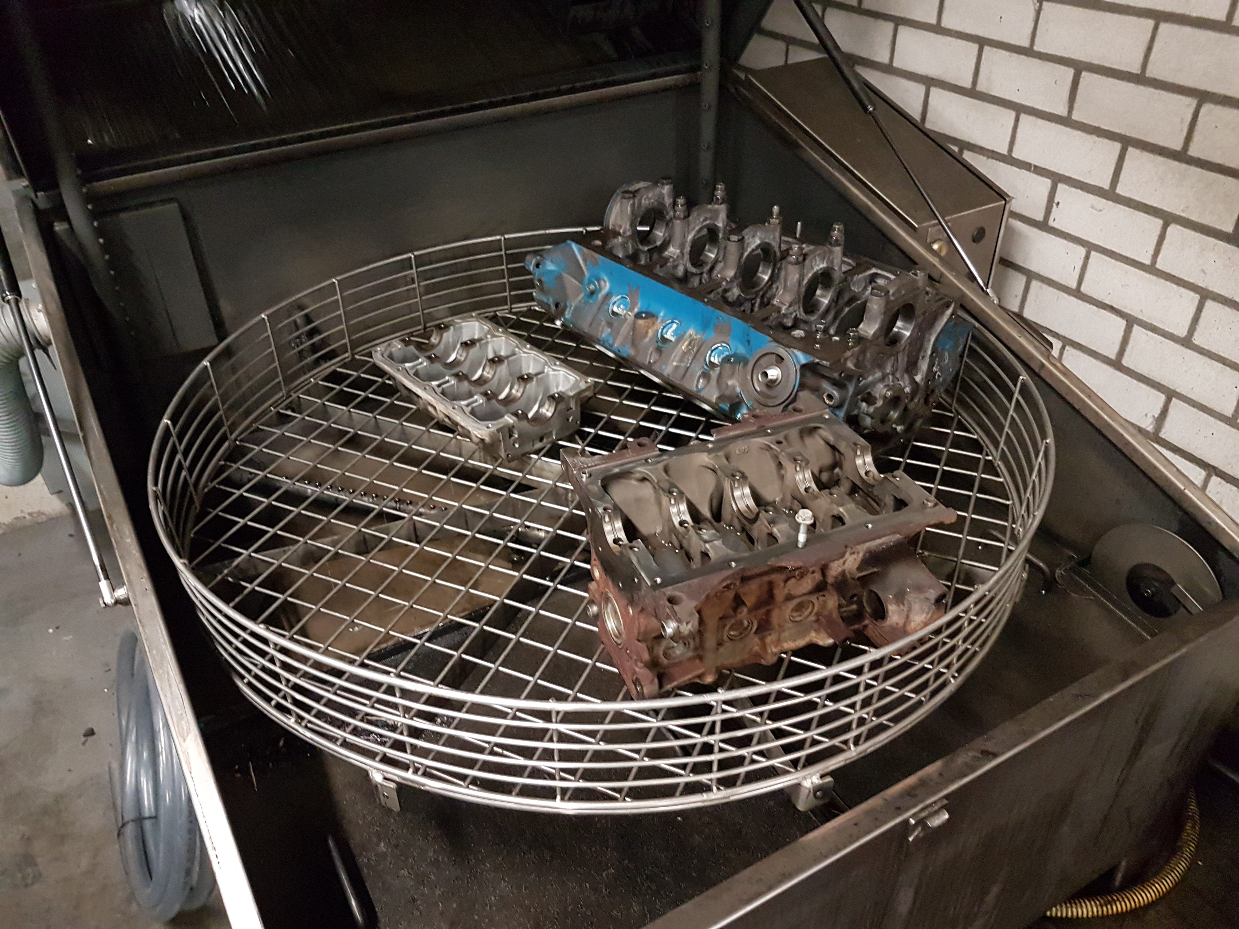

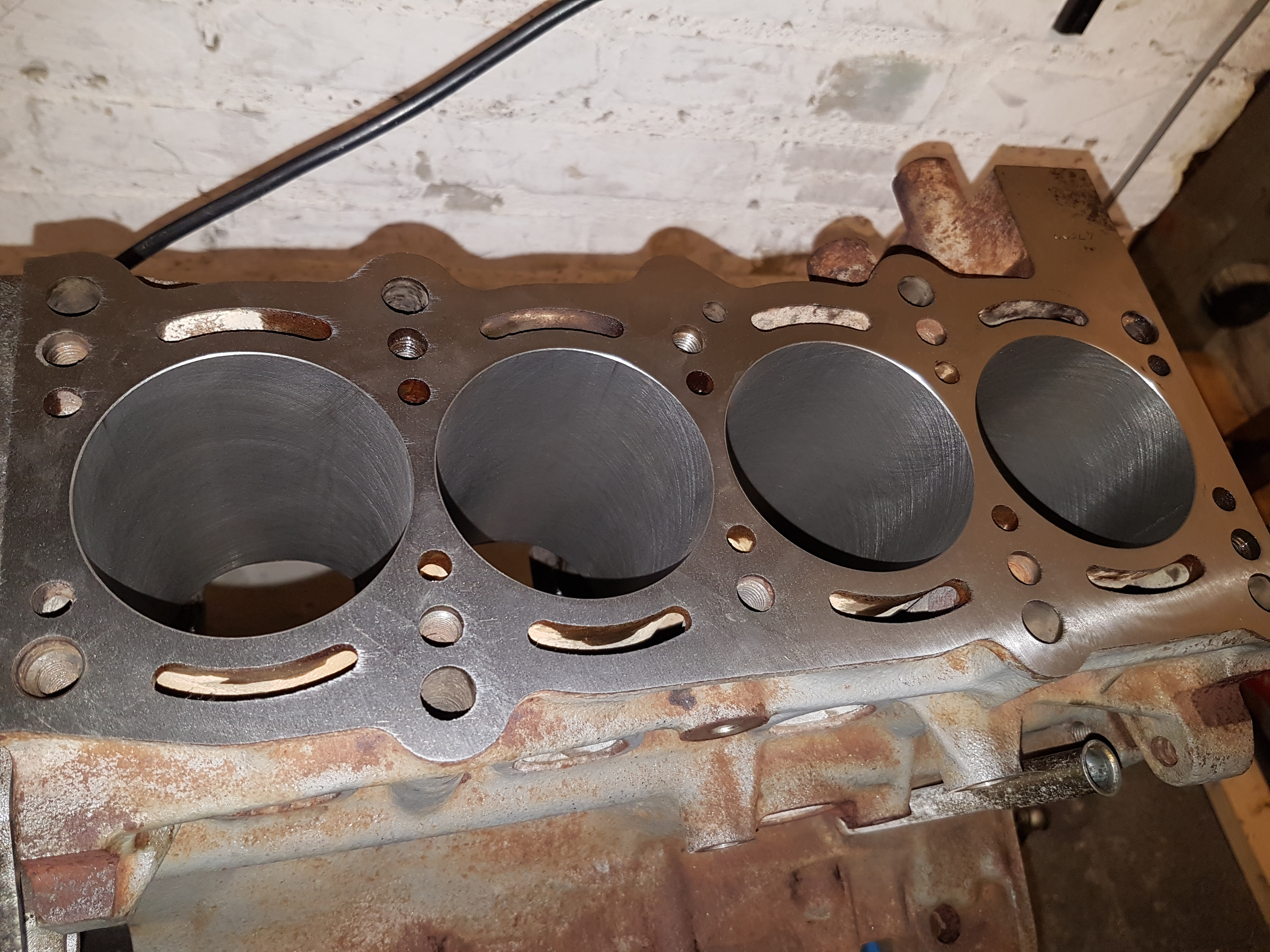

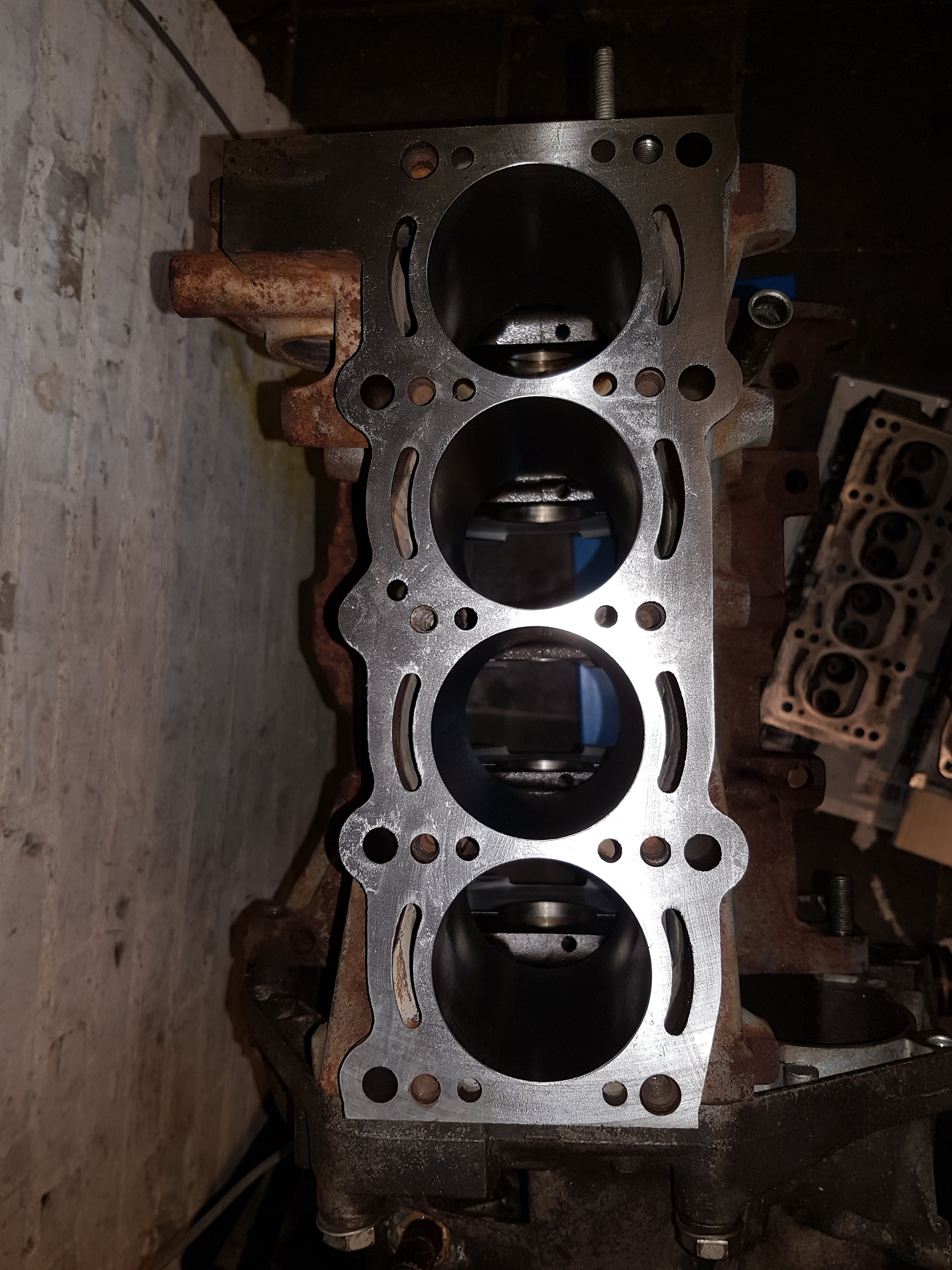

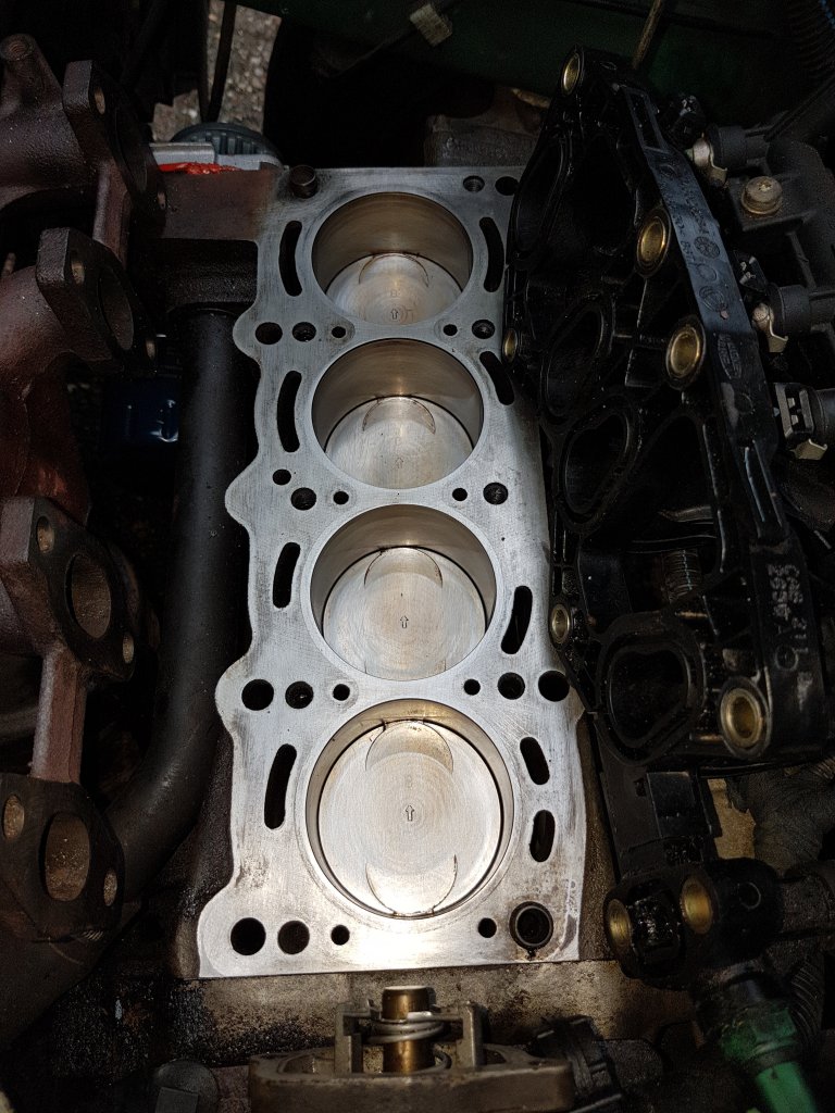

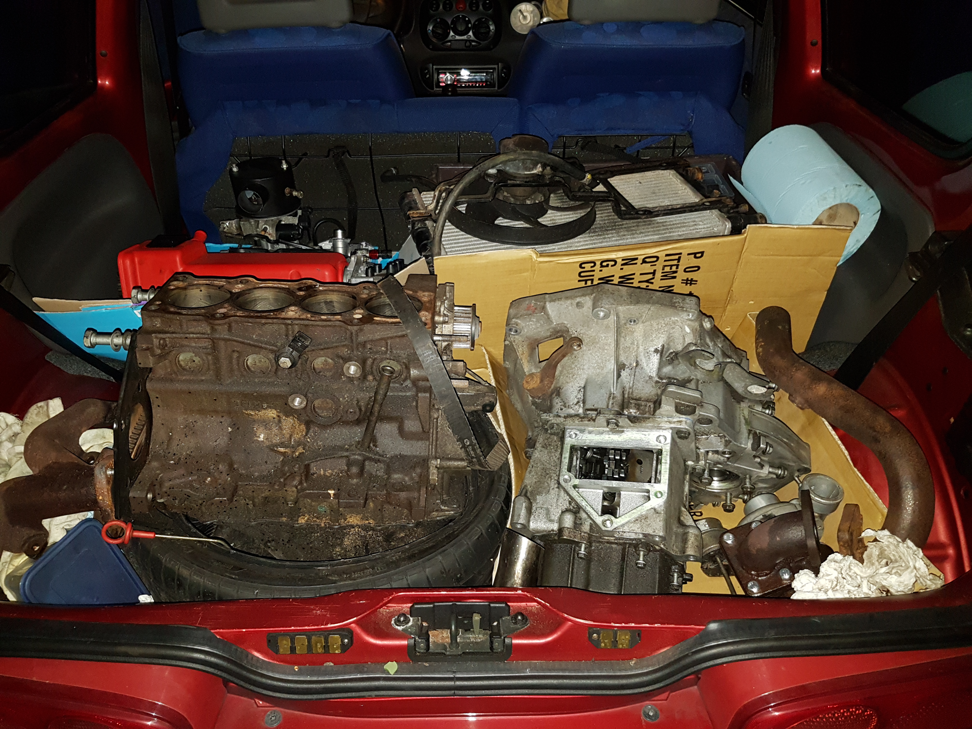

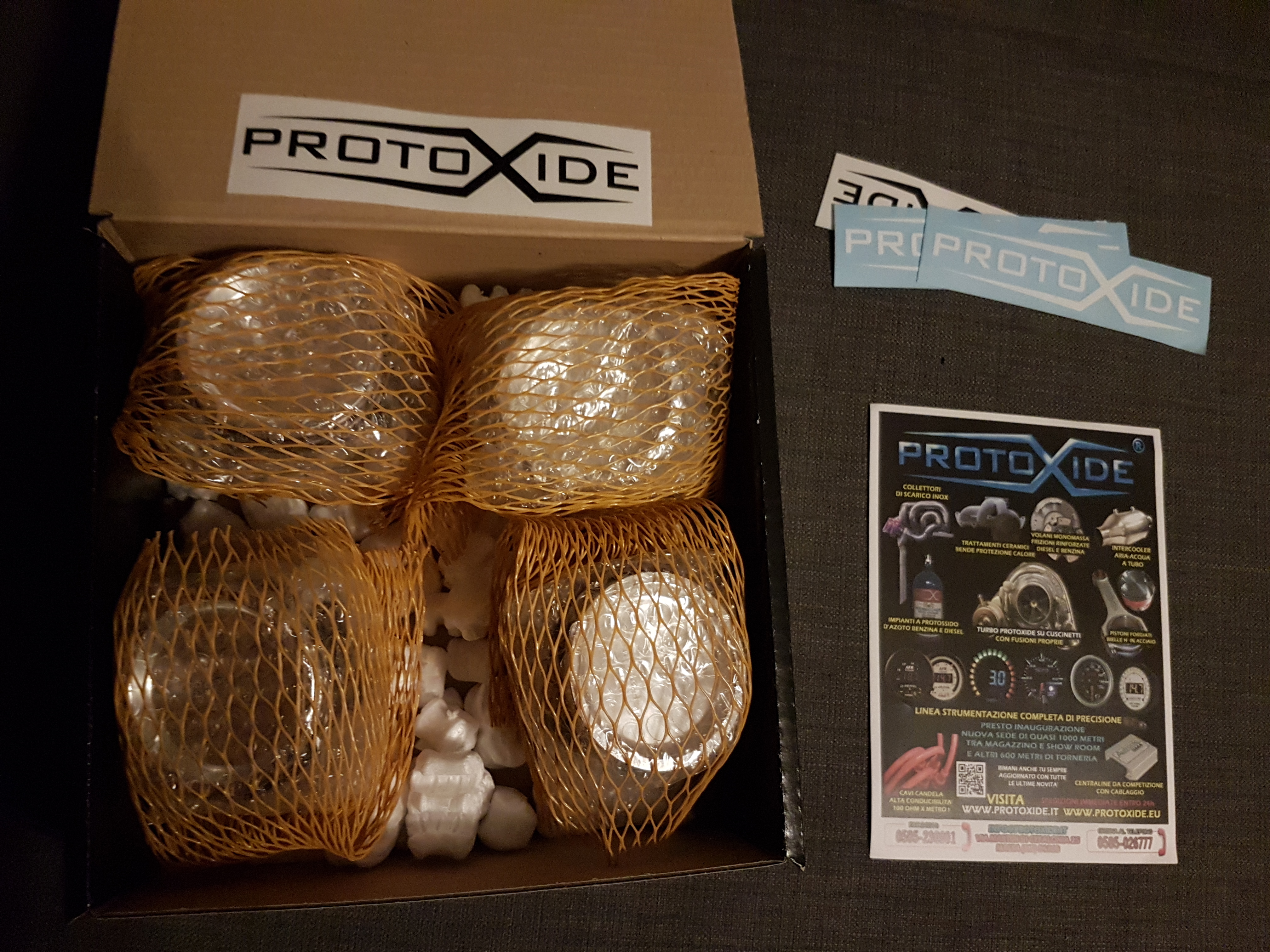

Today I picked up the freshly machined parts, and boy do they look sweet...

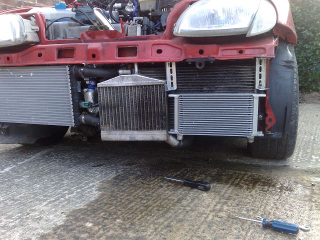

Also blu73, On one of your replies I noticed a dual radiator setup. Would you mind me asking why and how you did this?
on that car there is the stndard engine rad, the intercooler for the turbo is front centre, oil cooler at front on right and behind that is the air-conditioning condenser. ;)

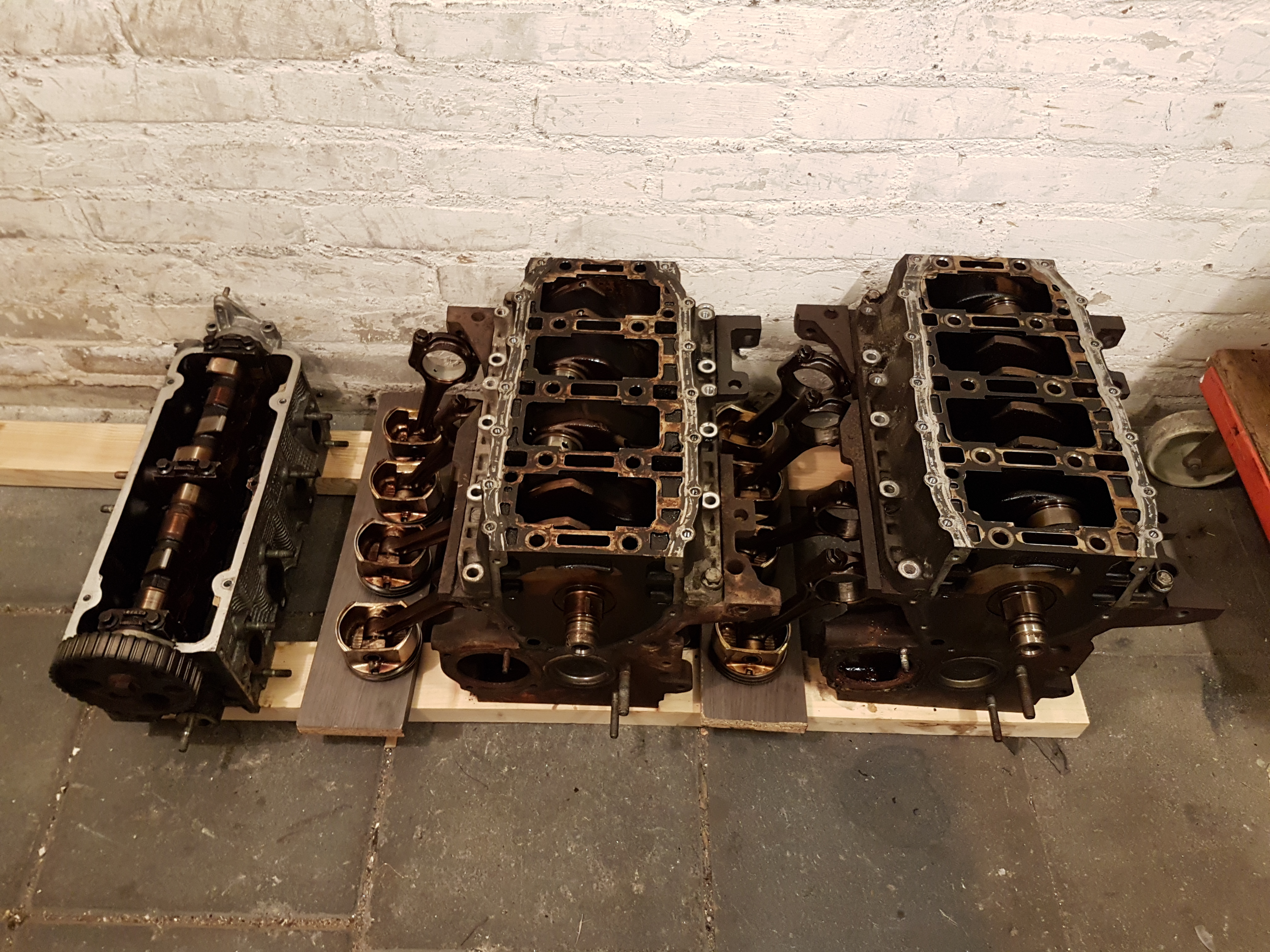

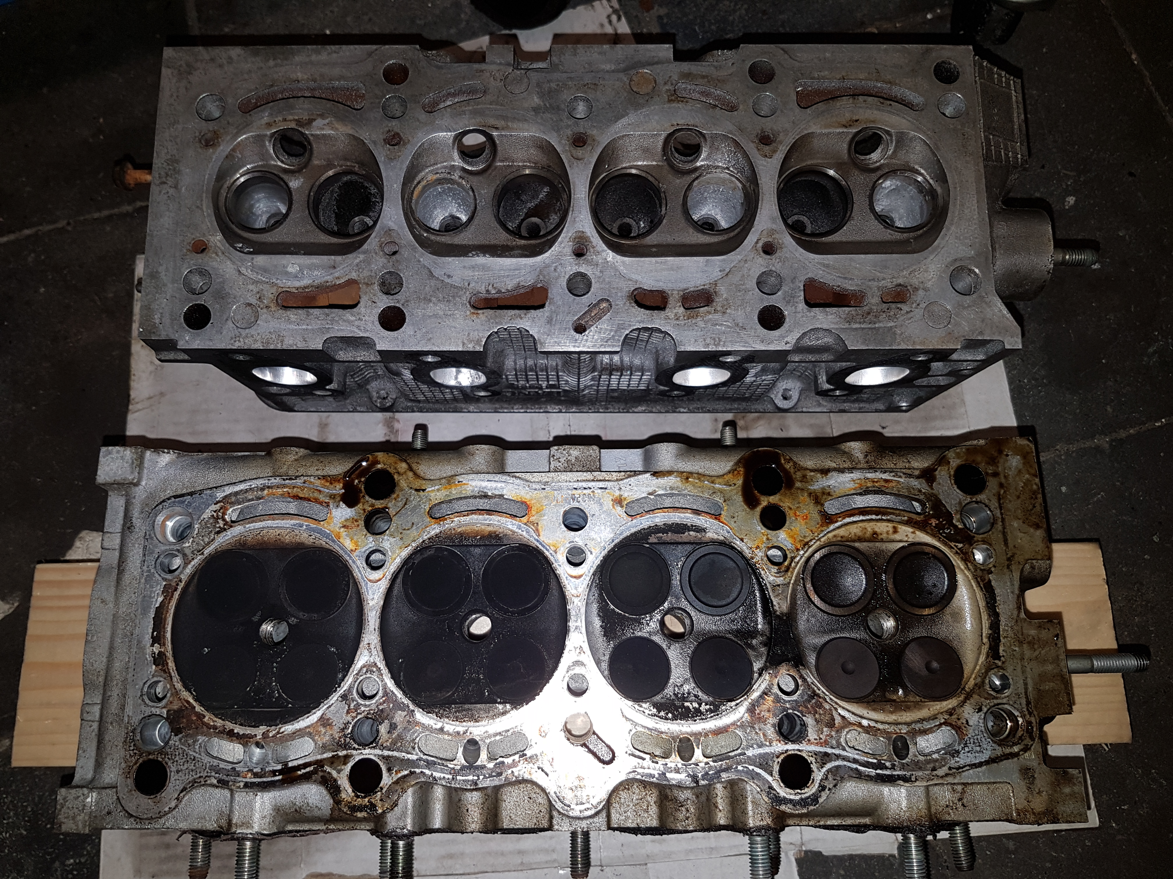

Did some more checking today, and the only thing that MIGHT become an issue is that the water passages of the 8v head are narrower. To increase flow I could modify those passages, but the rest seems to be matching just fine.
Attached are some pics from a mk2 sei 8v and punto 16v block (both 1.2), and both a mk1 p75 1.2 8v head next to the original head from the mk2 punto 1.2 16v head.
