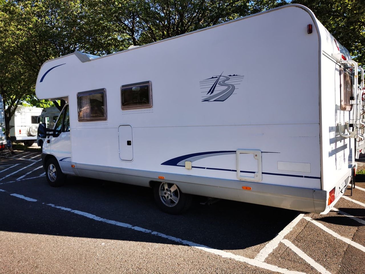

A photo of a Burstner A625 of that vintage. looks like 5x130 wheels to me
