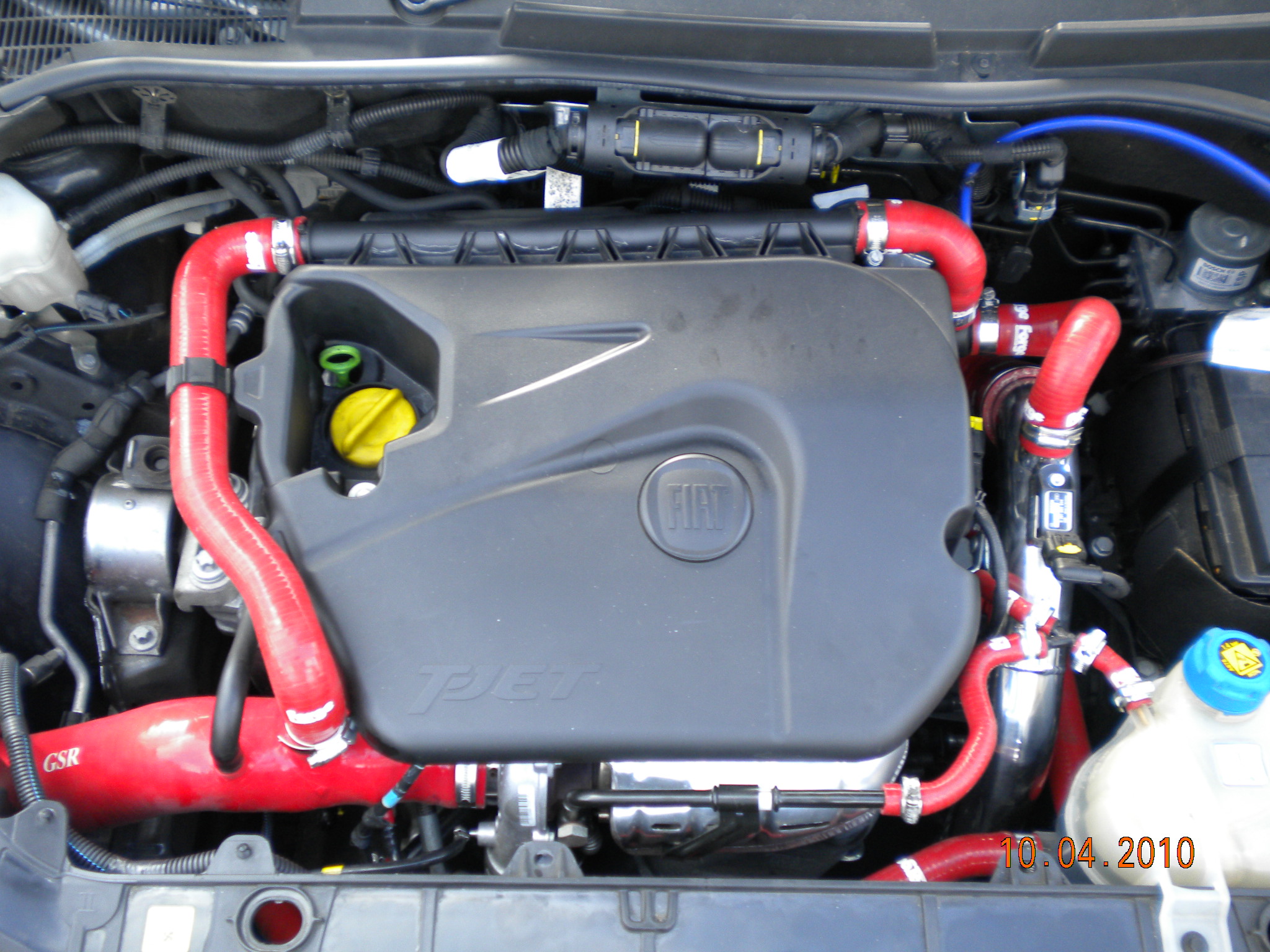

Next i got a Red GSR induction, not any power gains but the sound is worth it ;)

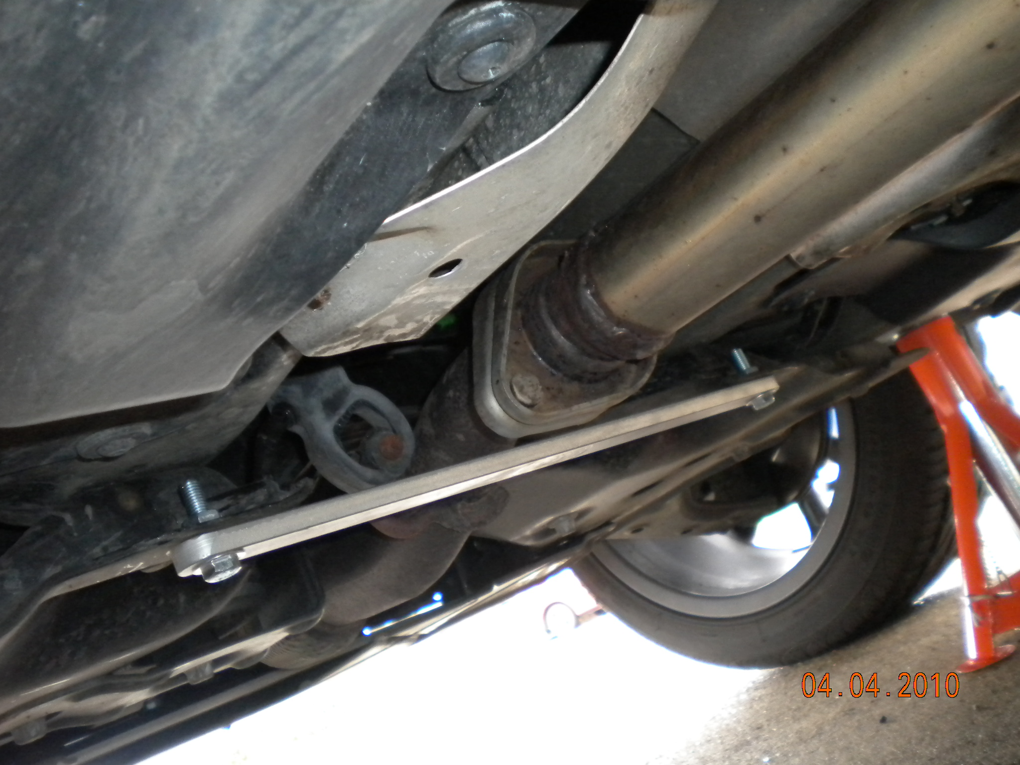

Subframe braces! weather stayed rain free yesterday so i pulled my finger out and got them on :D
Lovely and shiny
first long bar brace on, i did do it up more after ;)
the smaller bar i had to use different bolts i had laying around as i lost one of the bolts supplied lol fail!

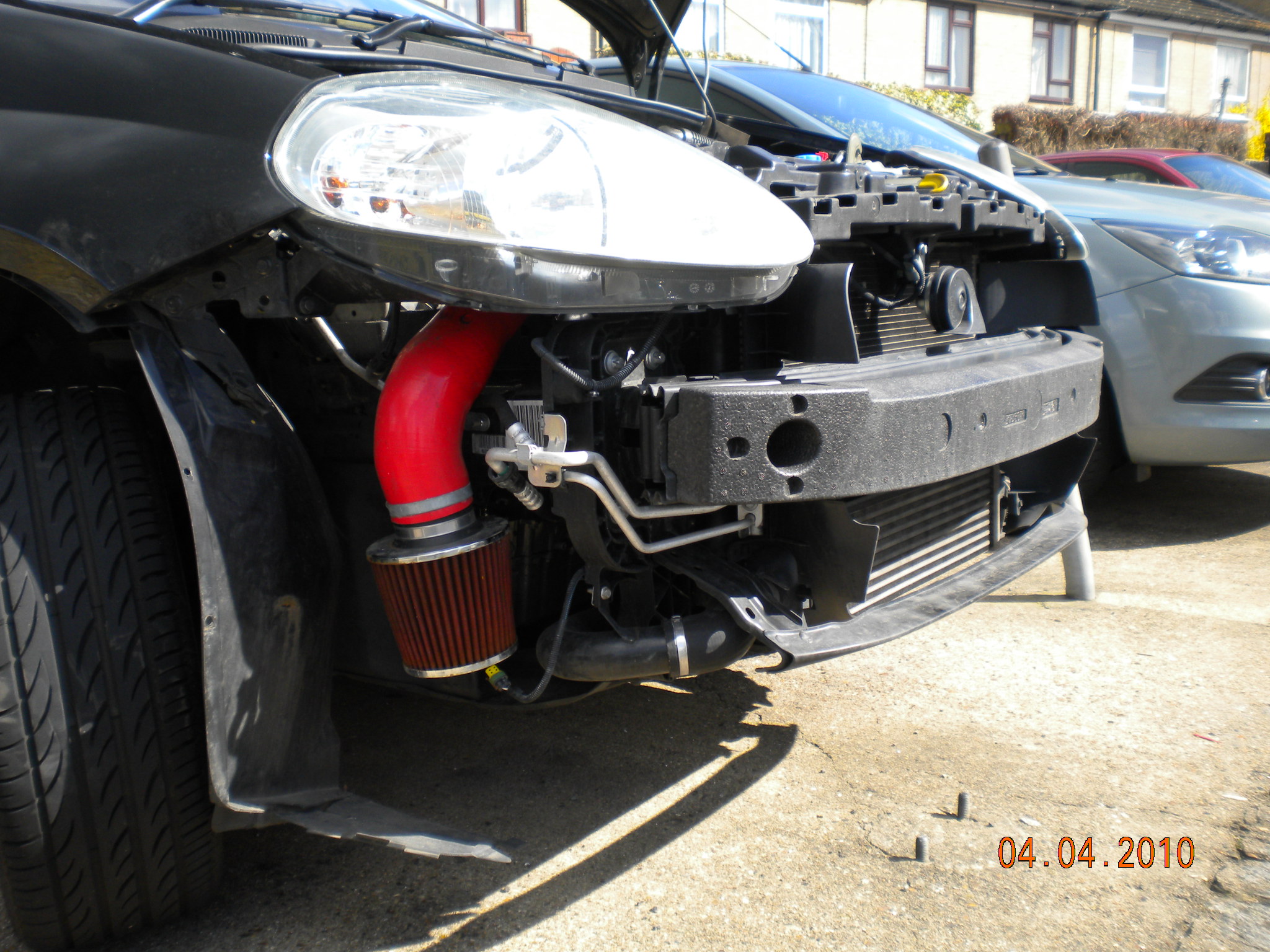

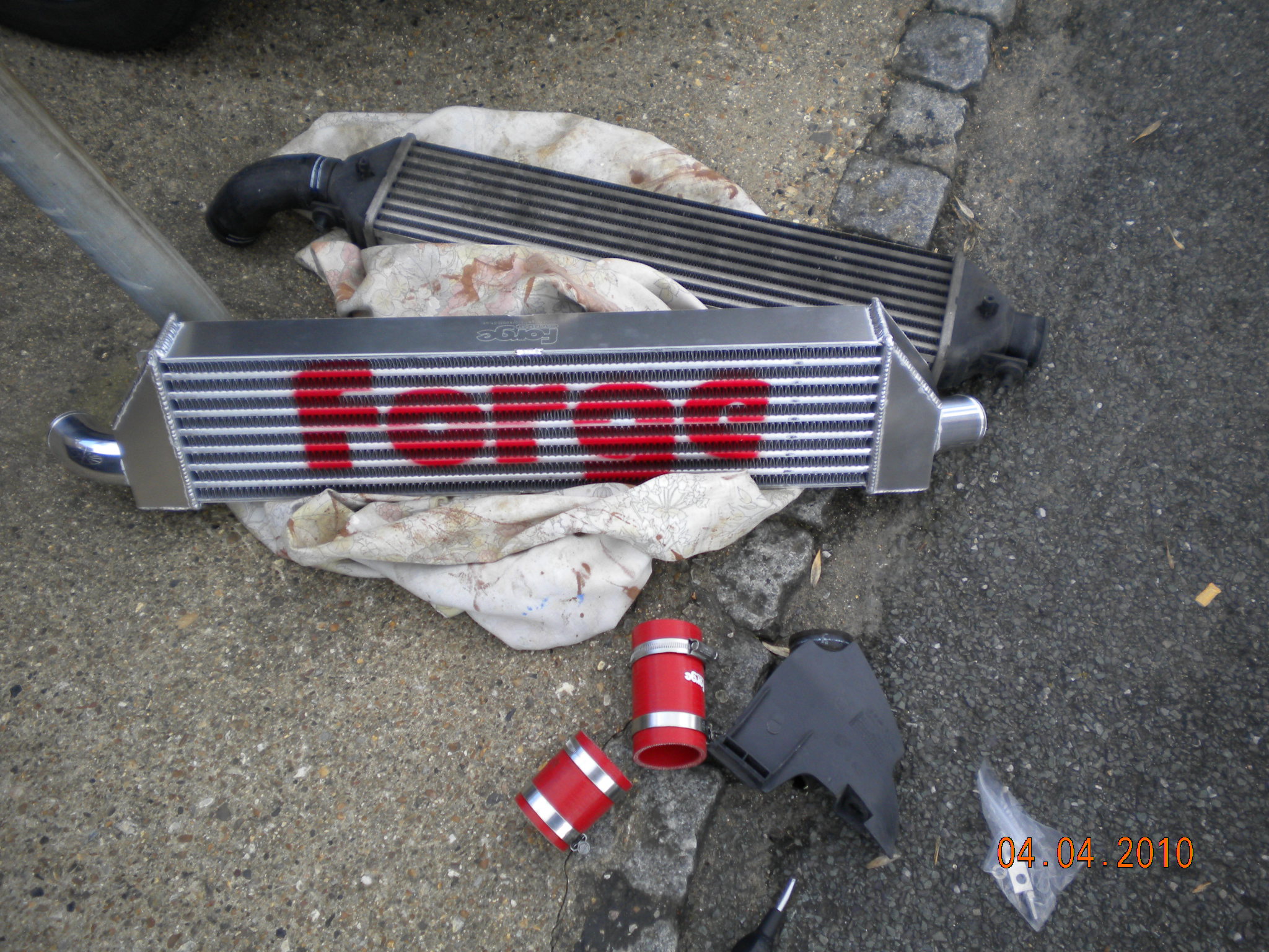

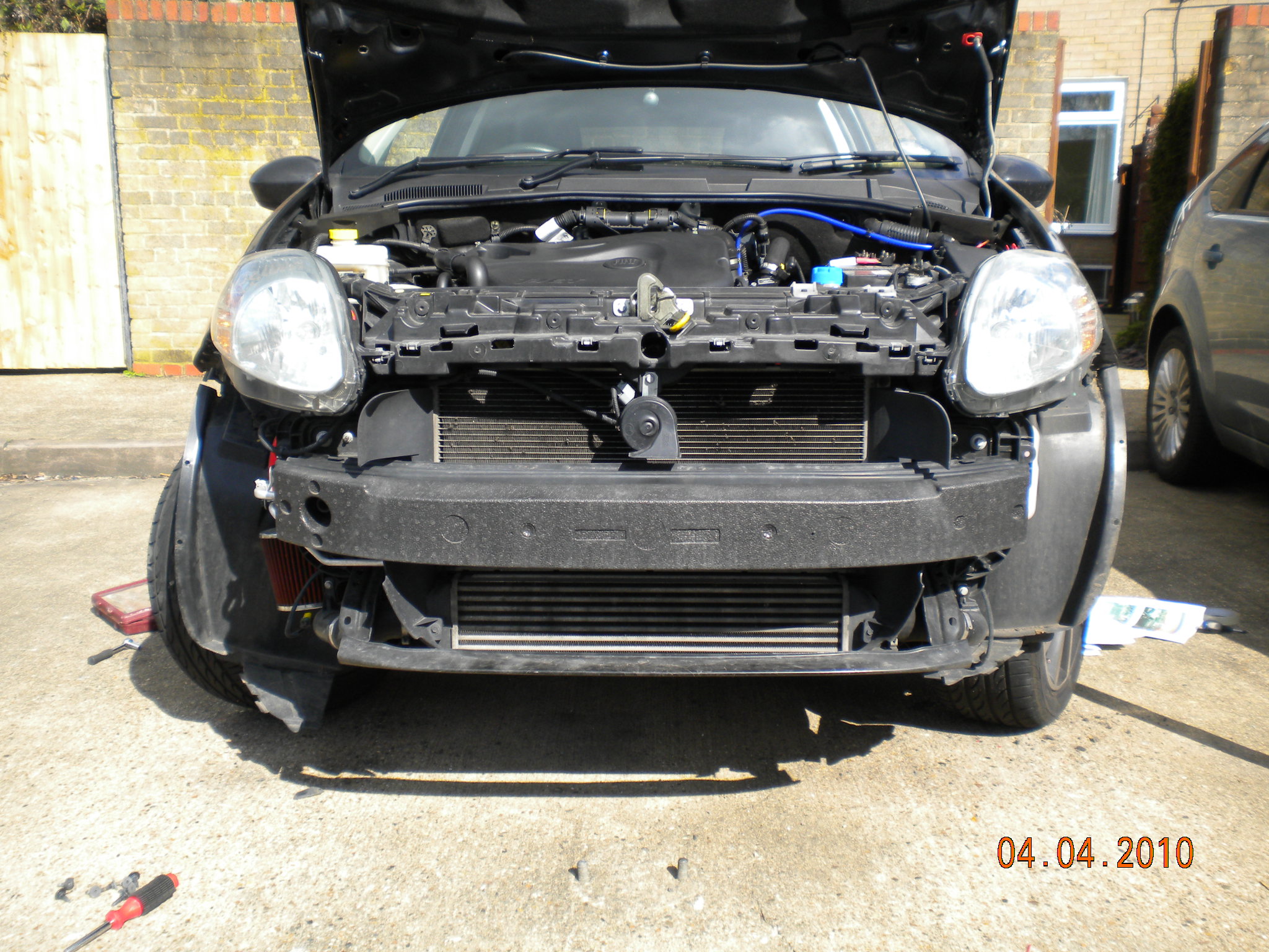

damn you! well done matey least your getting them new bits fitted now, how long it take to do the IC then ? how hard was it to get the front bumper off ?
PICS NOW please ha ha
ive edited the post for the pics ^^

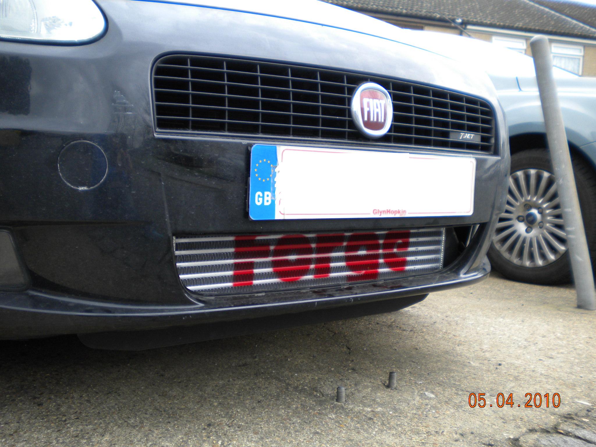

its dirty very dirty because i was going to a show last night and the fmic and braces took much longer than i thought,
the bumper was off fairly quick, it went back on in a few minutes aswell once youve done the install once you can do it fairly bloody quick again, if i was ever to have to do it again it wouldnt take long at all.
the tough bits was the rubber mounts which took ages fiddly and a couple of torx screws that were a pain to get to with everything in the way!!
i took a while to complete the whole thing as i celotaped the screws to the pages in the instructions so i knew exactly where they went that would be my tip to you if your gonna install it because it makes the re-assemble run smoothly (y)
now its done it feels more torquey at higher speeds its deffinately made a difference :yum:

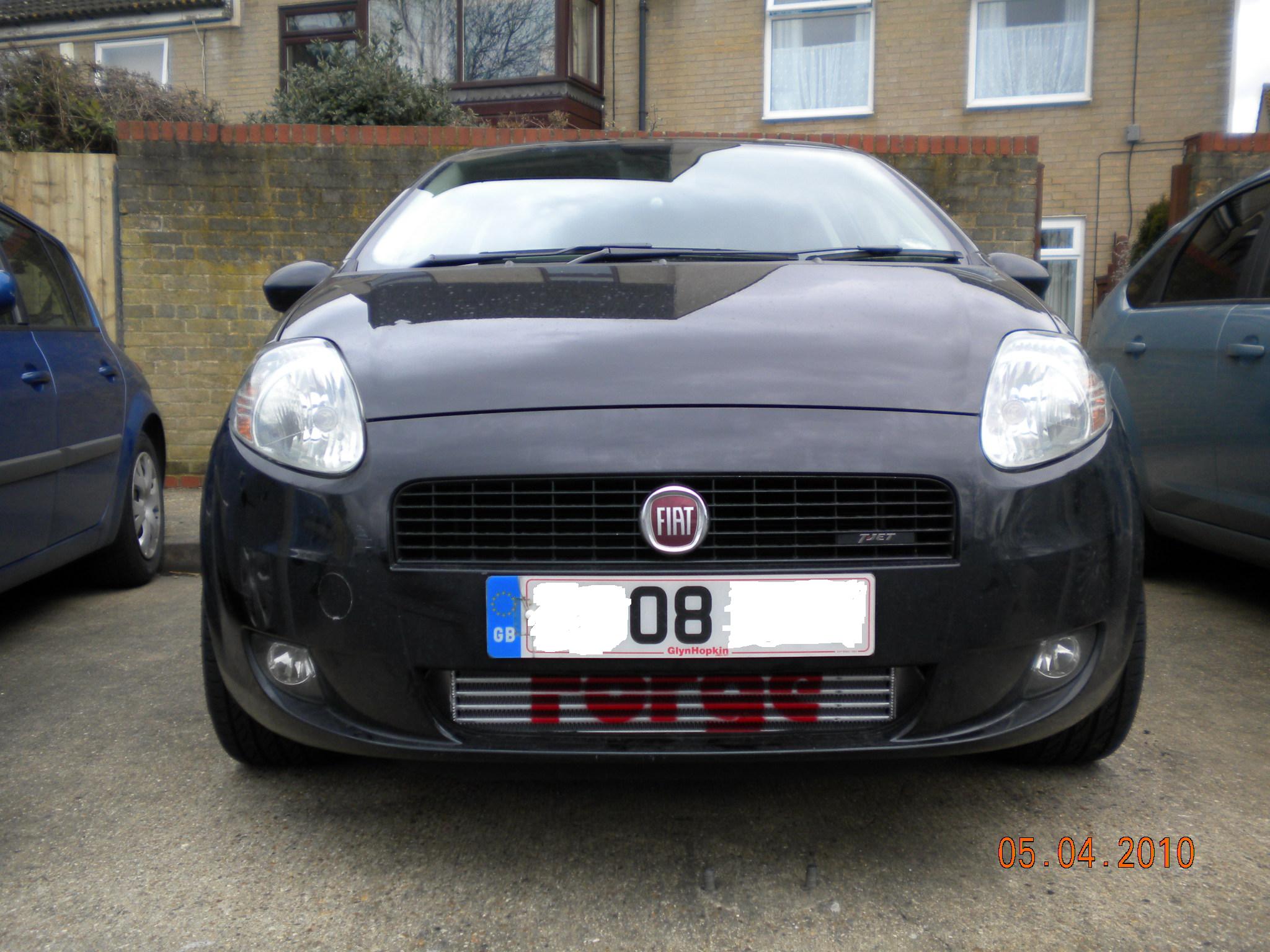

Quick update, as i fitted the intercooler and braces on sunday ive had a couple days driving to feel it and with the intercooler its deffinately improved mid range torque, when i get her remapped will be far more affective but you can feel it already
the braces have sharpened up the turn in and changing of directions is also much better, round the bends i cant feel so much of a difference but i guess thats more the lowering springs job!
:D pleased so far!

cheers it looks a little crap in the picture but when you open the hood up its lovely !!
