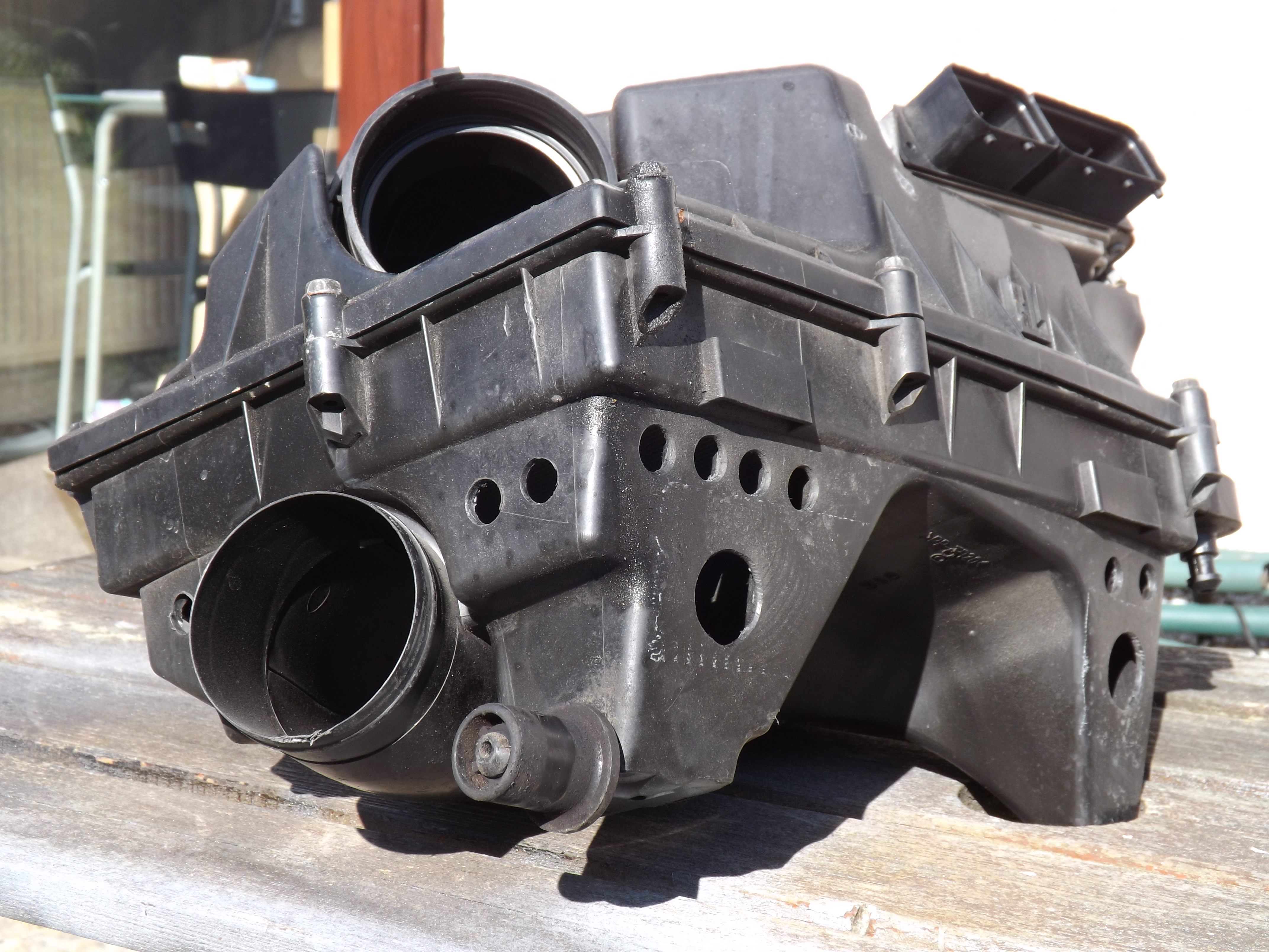

I finally got round to removing the airbox to finish the 'detailing' and what a day it turned out to be!!

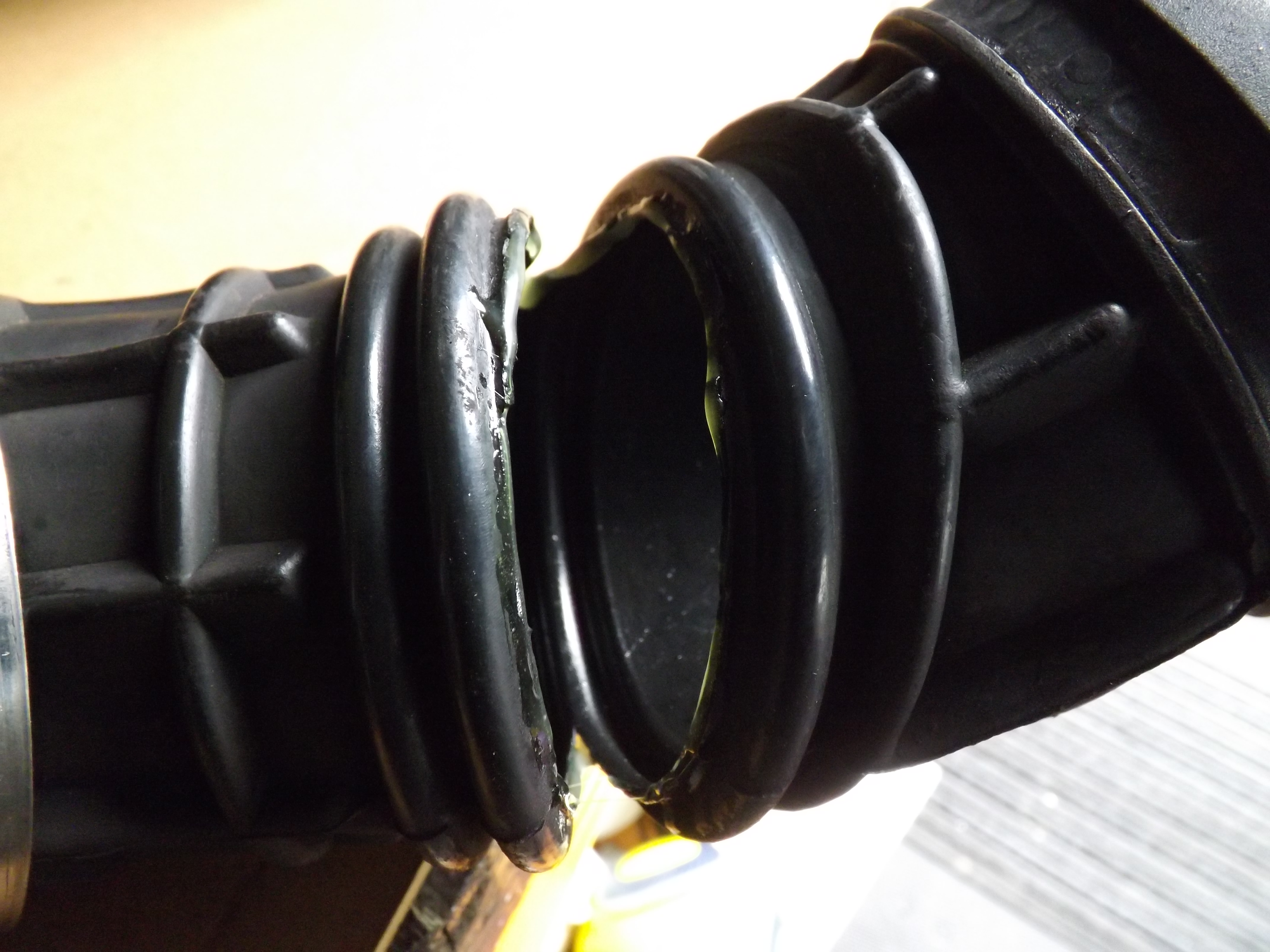

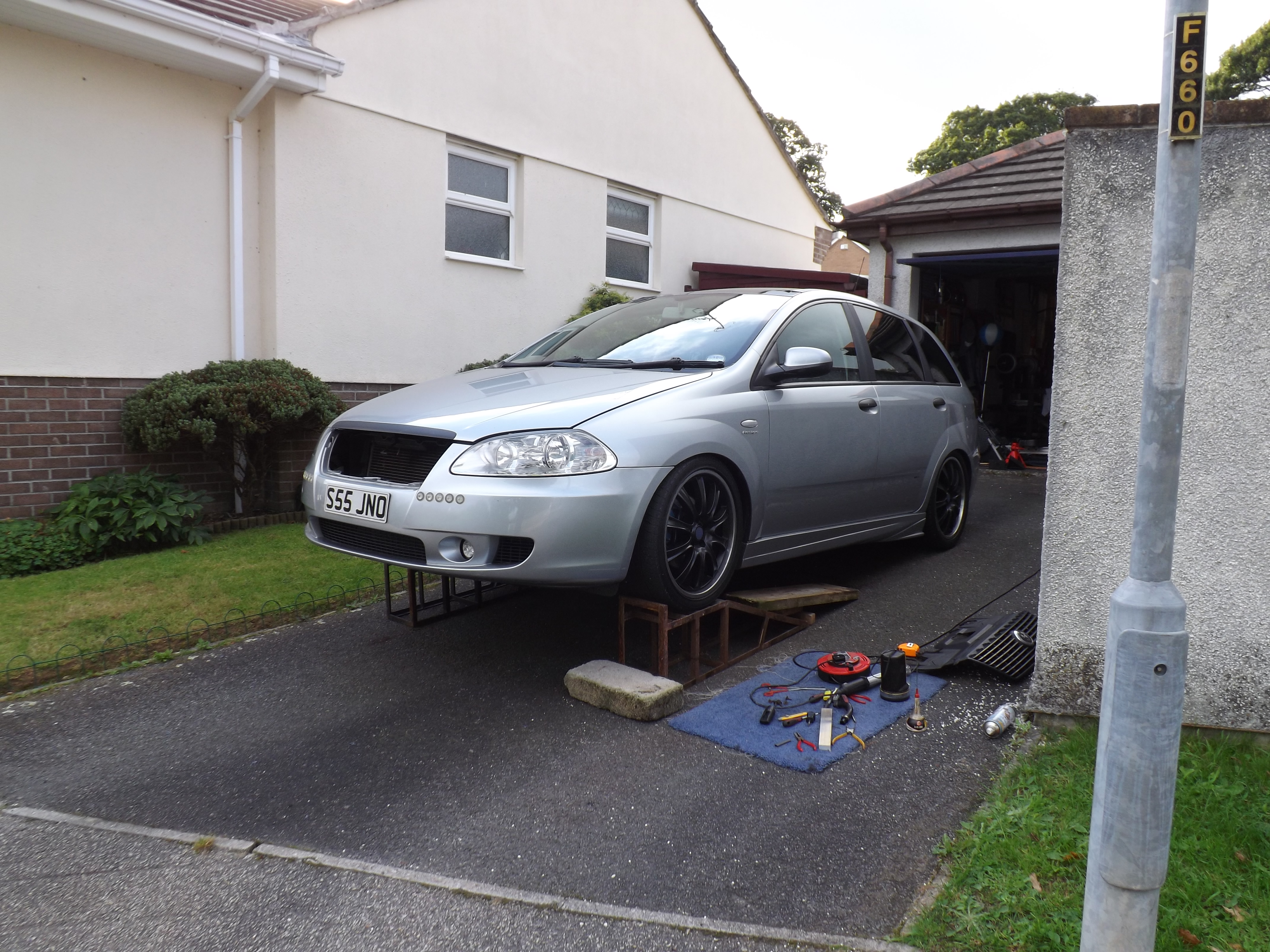

I found a substantial split in the top hose, which I had to remove to temporarily repair. On refitting I dropped the ratchet and, while fishing about, I noticed that the bottom vacuum hose (to the turbo actuator) had perished and was barely attached. After a couple of hours of skin removing frustration, I bit the bullet and put the car up on ramps. From underneath the job took ten minutes to replace with some silicone hose that I already had.

I have taken some pics of the drilled airbox for Ahewitt and Roberto :)
I checked the air filter and after 8 months or so since I replaced it, the filter is still very clean despite the extra air flow.

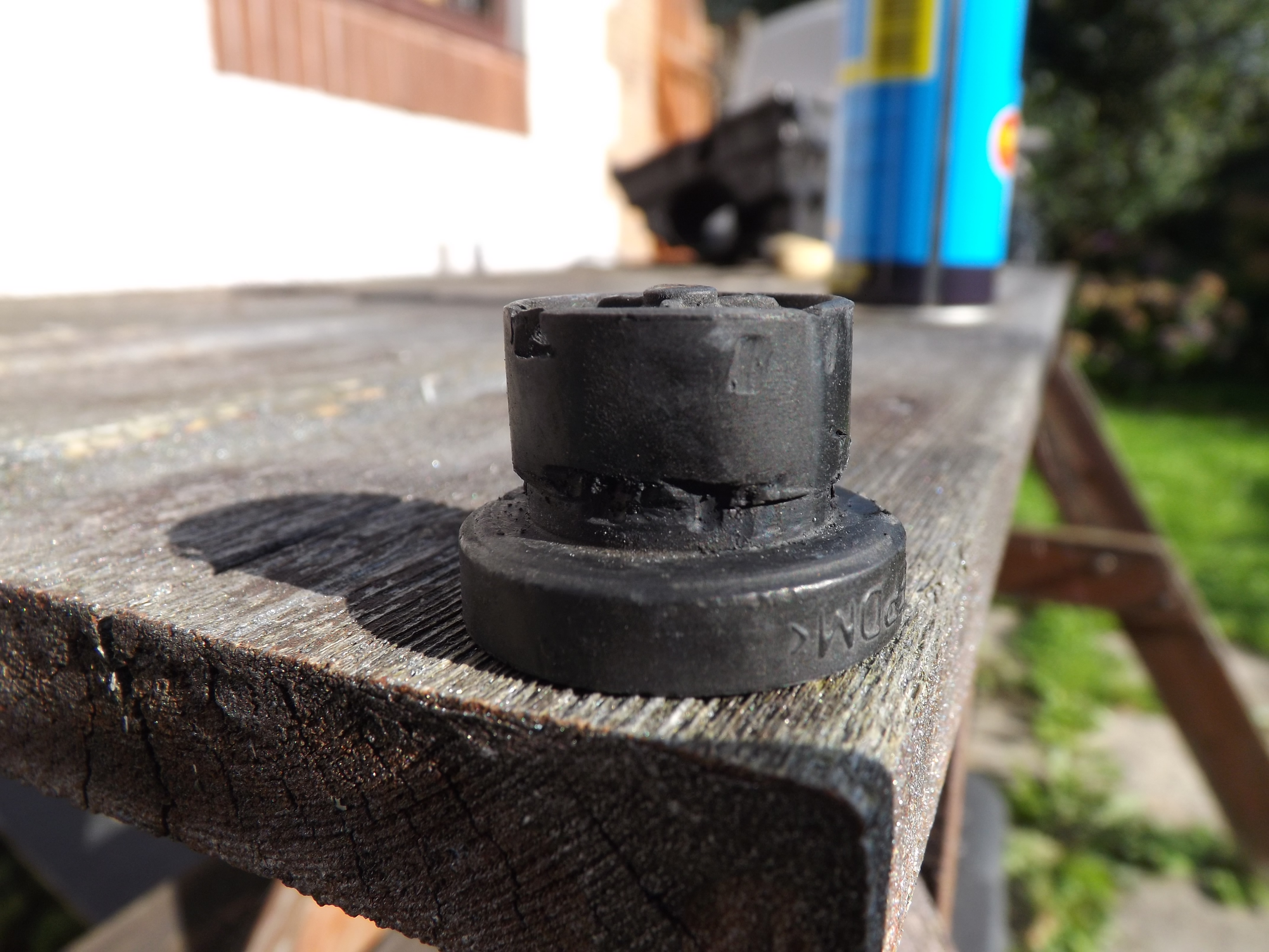

Does anyone know the part numbers of the top hose (airbox to turbo and breather) and also the rubber feet on the plastic engine cover as I have a couple missing?

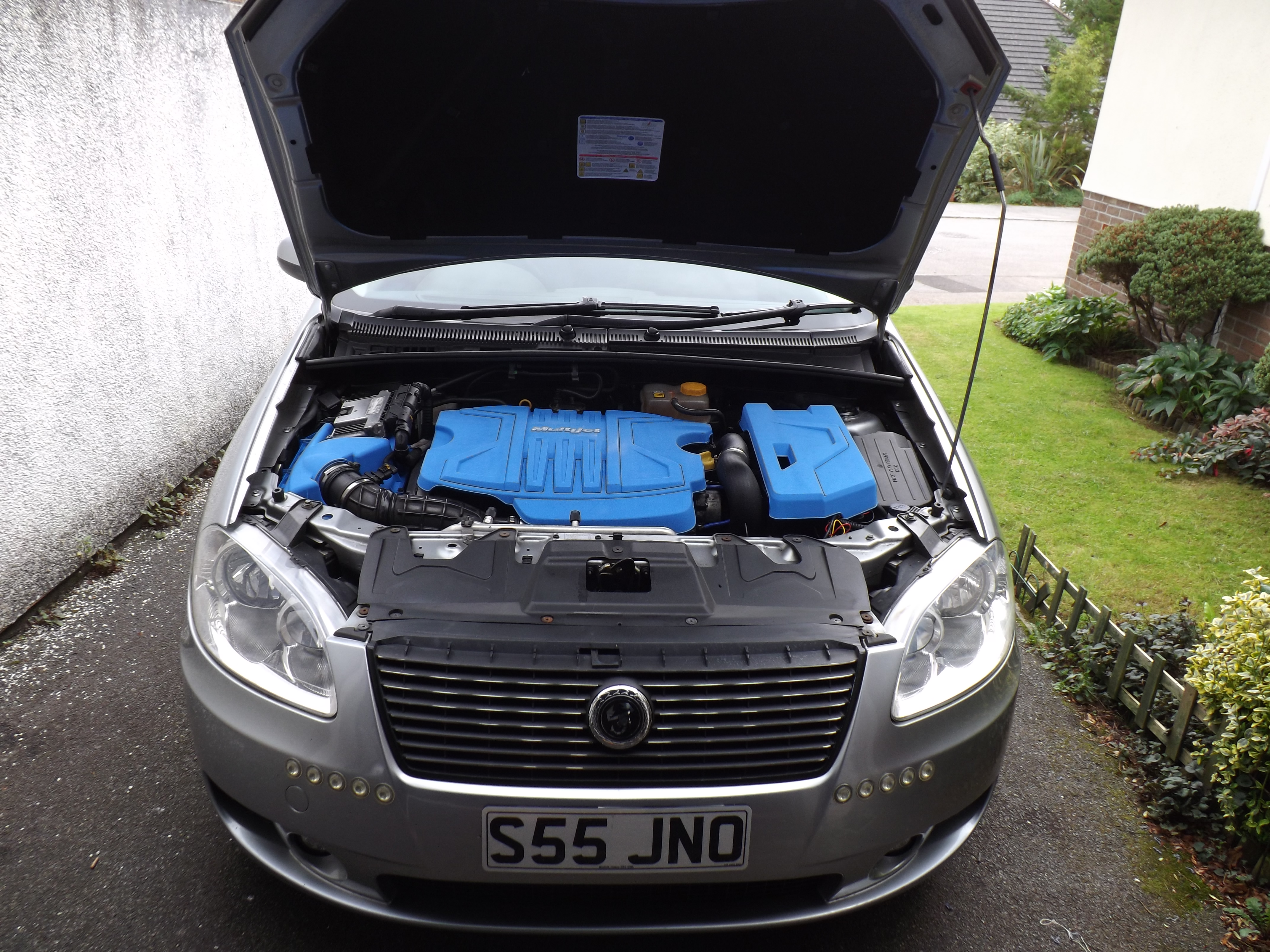

Thanks for the comments guys. It's taking shape now.
Yes it will draw in some warm air but not as much as a cone filter, as I still have got the cold air feed attached. The intercooler will bring the temp back down.
Next project is to make a replacement for the top hose out of silicone pipe and incorporate a catch tank to compliment the standard aos system.
Hey halilson looks great and thanks for the pics. Your air box a bit different from mine as yours is 2.2. I mite give it ago this week but I'm battling a the drivers side door handle at the min as it's broken. Once I'm in can't bloody get out without lowering the window and using the handle outside! Grrr.. Still it must be love cos I'm not giving up on it lol
If yours is a 1.9D then just unclip the stupid diverter flap inside it, so it can breathe properly. I'm not convinced that drilling holes is a good idea myself.
Performance car magazine did an in depth test on various after market cone filters, high flow and standard panel filters and also drilling the standard air box. The drilled box showed the biggest gains in power, while some of the cone filters actually gave a lower power rating than the standard set up.
Interesting, and probably a debate that could roll on indefinitely. There isn't much fresh air knocking about under the Croma bonnet, as it's pretty much full, but perhaps other cars have more fresh air. I'd wonder whether less cold air is better than more warm air.
You also can't control the mix used, so it could be running on 90% warm air (as there's less resistance from a hole than the snorkel to the front).
Personally I got rid of the daft restrictor from inside it and put in a K&N filter, and it was noticeably zippier when accelerating. It also lets the lovely turbo song come whistling out - not too much, and it sounds nice.
Did just the same and got the same results, K& N is a real bonus(y)
