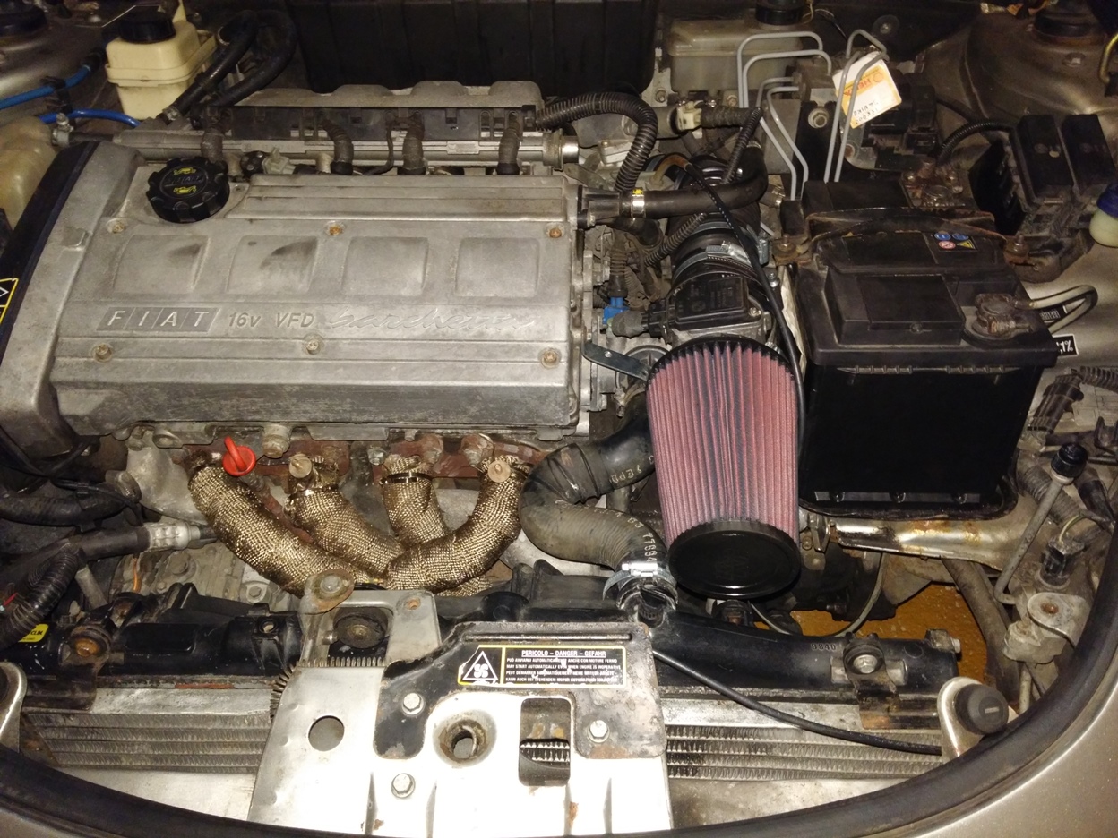

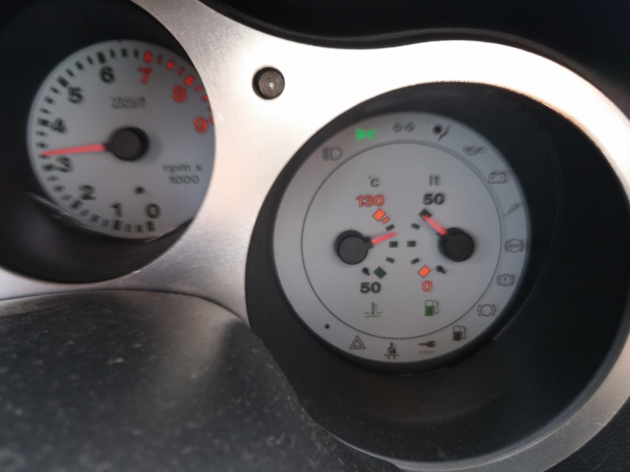

I have an issue with my car running too hot (please refer to the picture below). This reading I got driving in about +10 C on the highway at about 110-120 km/h. Temperature remained the same the whole 1.5 hour trip with both fans running at maximum speed almost all the time. Radiator was not very hot to the touch. Last time I drove it was 5 months ago, temperature would stay at about the quarter of the gauge.
There were some modifications made since last year. Cone air filter mounted, old heat shield removed and exhaust manifold wrapped with the special tape, straight through exhaust system mounted. Radiator was leaking, so it was taken out, sealed externally and refilled with new coolant+internal sealant. Thermostat is working fine, had it removed and tested.
My thoughts are:
1. Sealant has clogged an old radiatior.
2. Wrapping tape makes exhaust manifold too hot and lambda probes get wrong readings.
3. Air filter is sucking too hot air (that one could be withdrawn I guess, since I tried driving with partly popped hood, there was no change to the temperature, but filter was cold to the touch. Also performance remains the same. By the way - straight through intake and exhaust makes a huge difference in performance, cannot believe how agile and alive my car became )
So, has anyone faced any similar issues? Where should I start my investigation?
