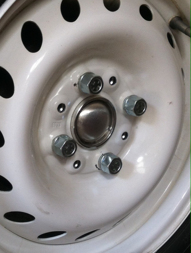

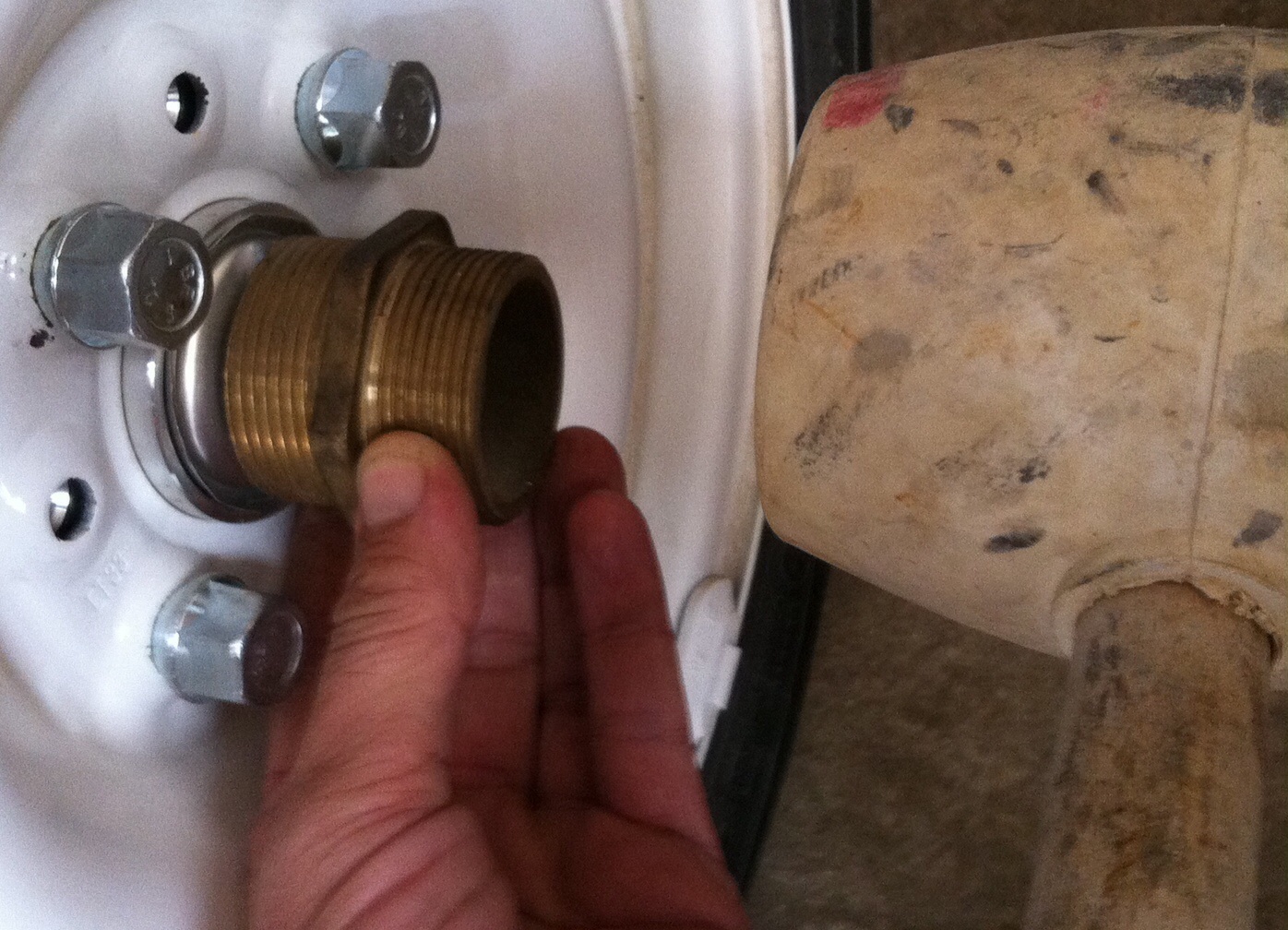

Now that the wheels spacers (20mm) are on, there is an ugly deep hole where lurks the rusty hub nut...

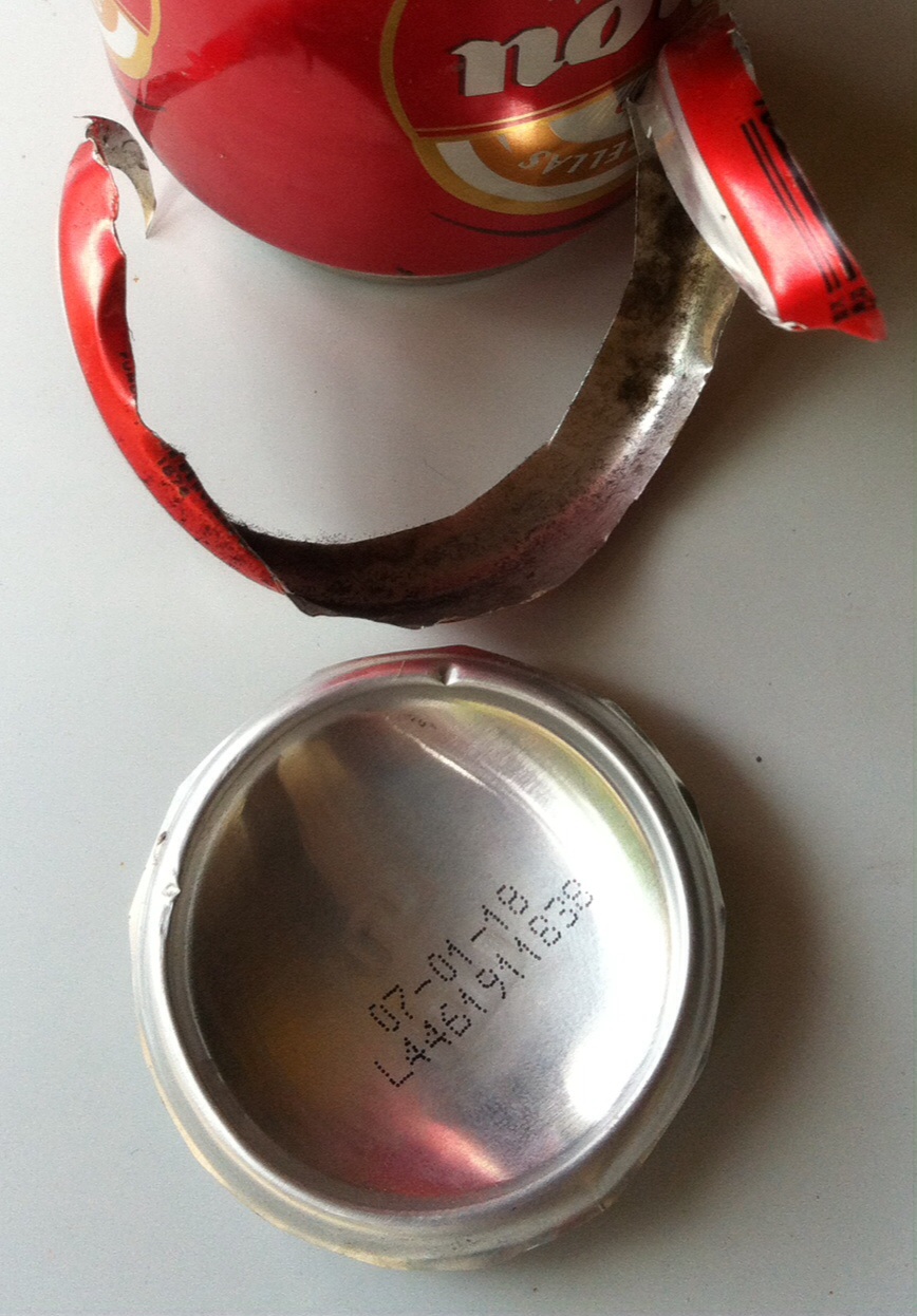

After a bit of experiment I came up with a hub cap from a beer can. Liquid inspiration indeed.
Chop the bottom off a beer can, Spanish beer works fine for this.
Cut it down to the base relief diameter, a few mm wider than the hub hole diameter.
Tease it in using a tubular block and a soft mallet.
Problem is that by the time you get to the fourth wheel you're a bit sloshed.
Apologies for a post per photo, it's the only way my phone lets me do it on yhis site!
Saludos

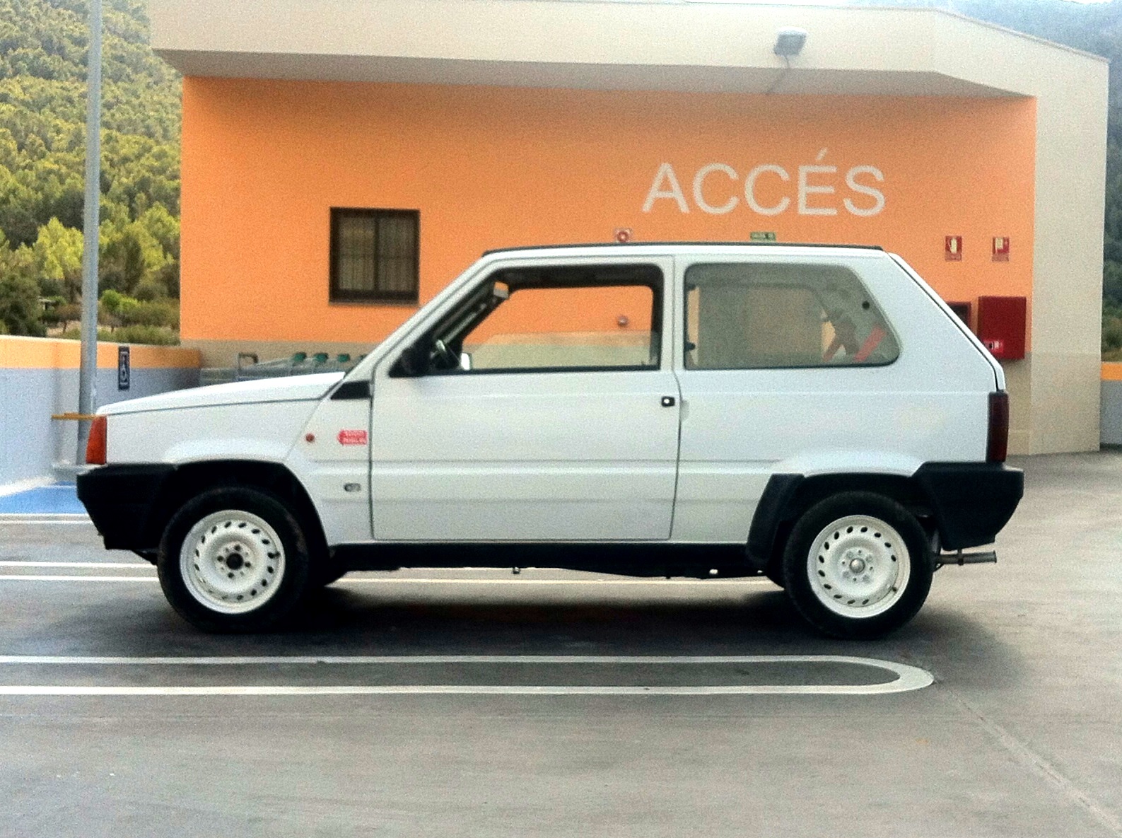

Now that i have changed the front dampers, i have moved to the rear. The dampers were not to bad but I have installed new monroes anyway. Whilst in there I decided to check out the rusty springs, and suddenly decided to see how cutting them down a little might affect the ride ( and the looks of course).
I removed a half- circle from the bottom of each coil, and now have the rear end about 20mm lower.
After a blast on my favourite road, I can report that the handling is transformed. This may likely also be due to the rear spacers and new dampers all around, but I am well impressed. The car feels very neutral on a dry surface, minimal scrubbing and high stability. Certainly a little firmer.
I'm well impressed by this little car. Really impressed.

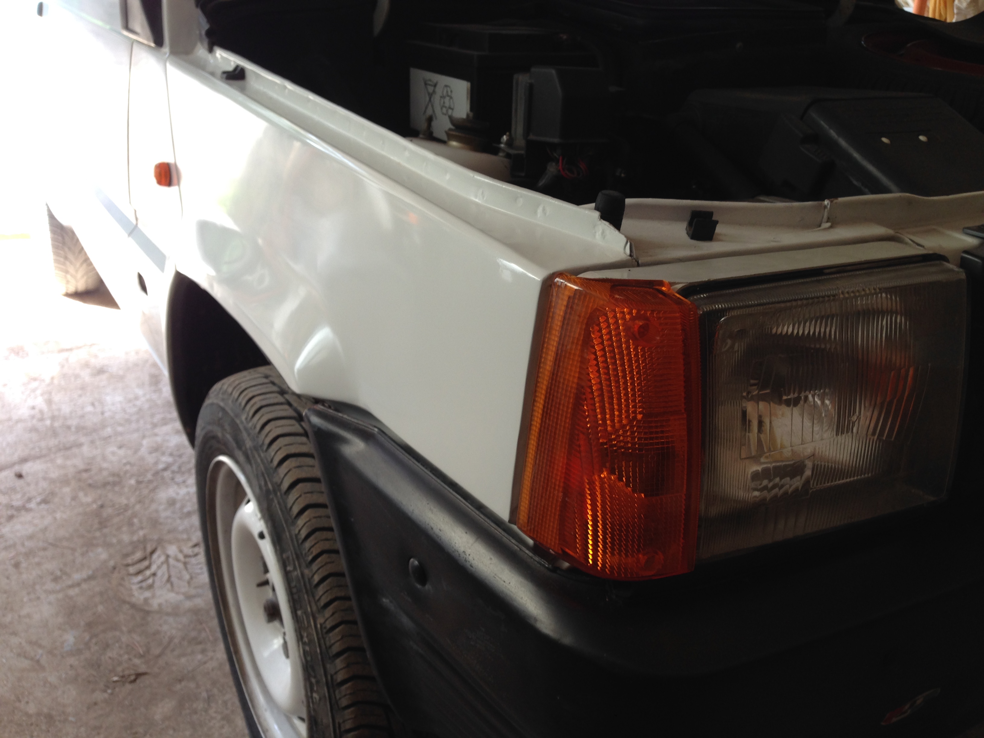

Today I finally get around to front wheel alignment, long needed.
I add a photo of the now finished front wing repair.
Thanks!
