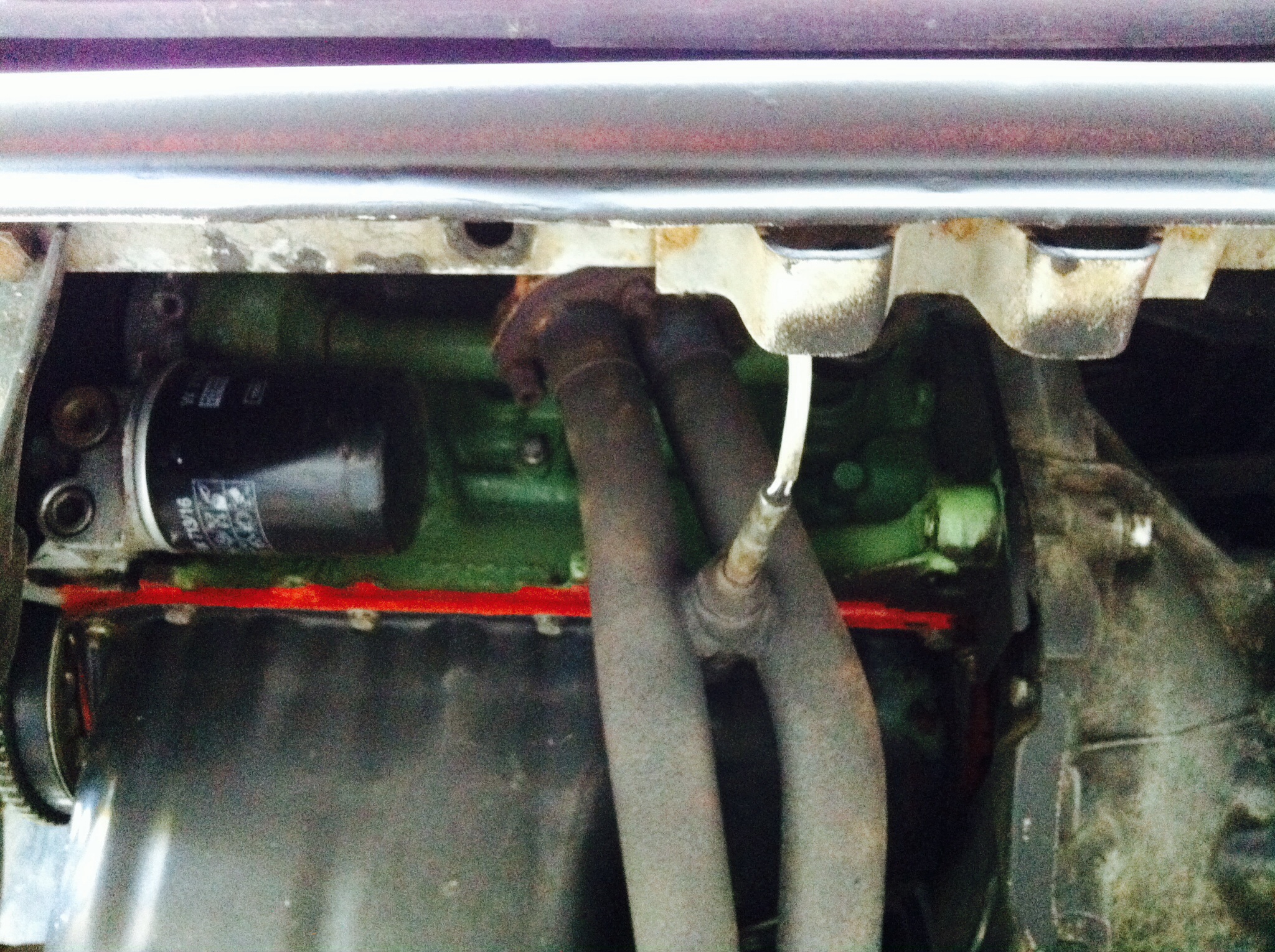

Well now that the top of the engine is all clean and tidy, it is time to get underneath and accustomise myself with the dirty bits...
All quite original down there, but on close inspection I found:

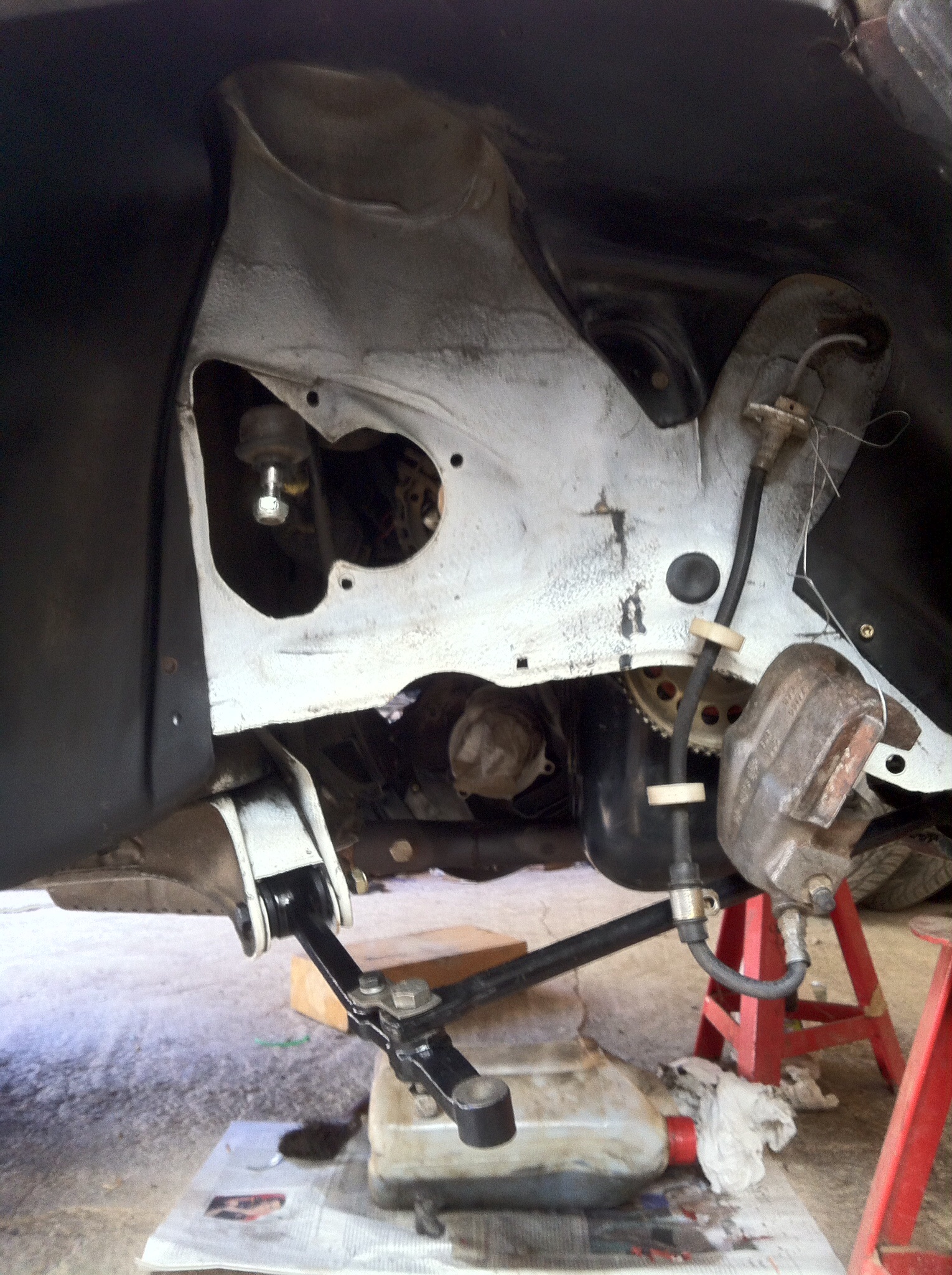

Control arm bushings were shot, so new arms have been bought. Then I discovered two new bushings in the spares box which came with the car. Duh! Never mind I'm sure Marbella could use them!

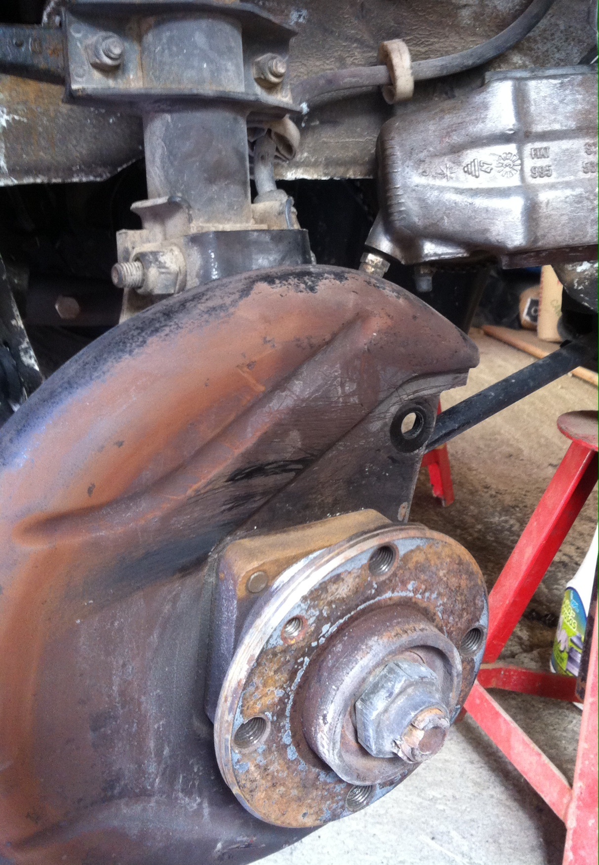

Scrubs up nice. Now on to the suspension and brakes. The disks and pads are brand new, but no cleaning or copper slip was done, so I'll get on with that now.
The creaky brakes and the hubs are pretty ugly, mostly dirt, no much rust. The bearings are free and solid thankfully.

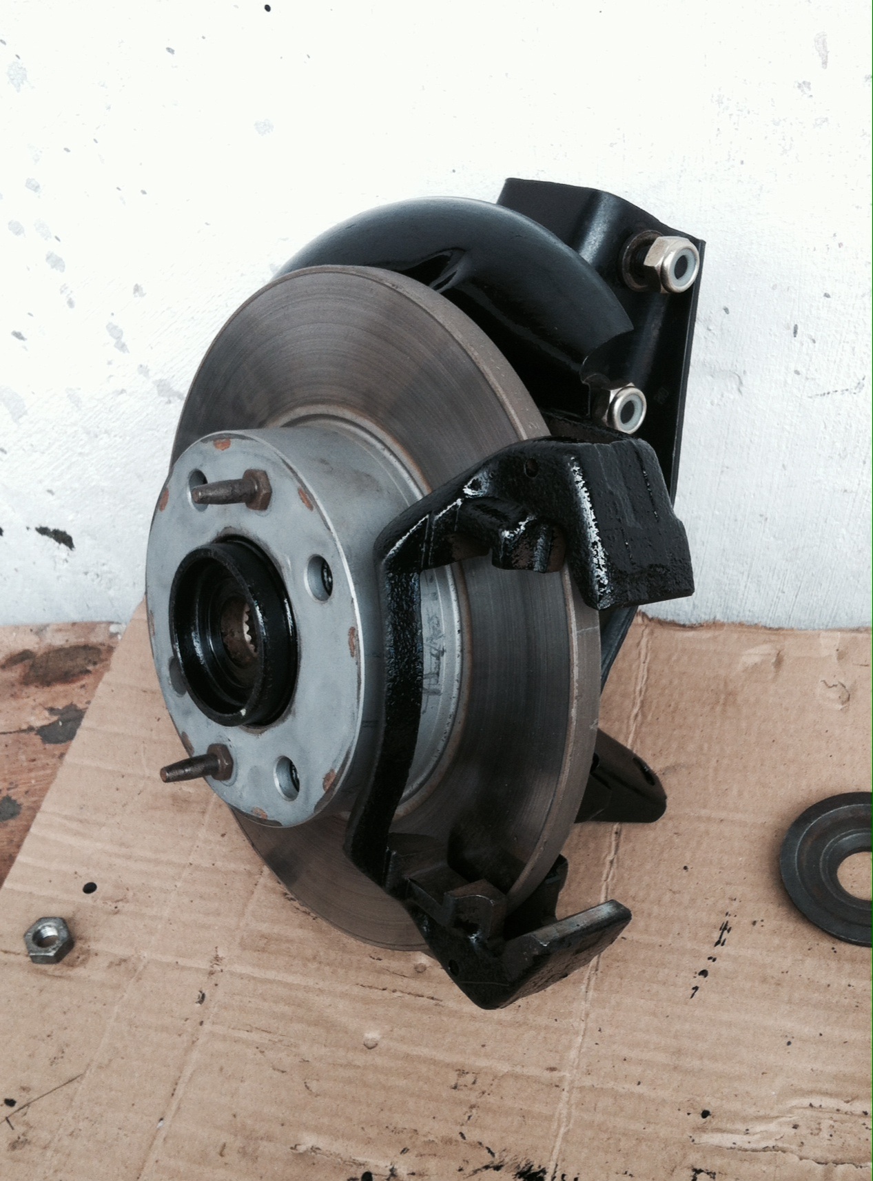

Now to strip and clean for paint, I'm leaving the calliper piston body connected as everything else in the brake system had already been renovated, and works like new.
