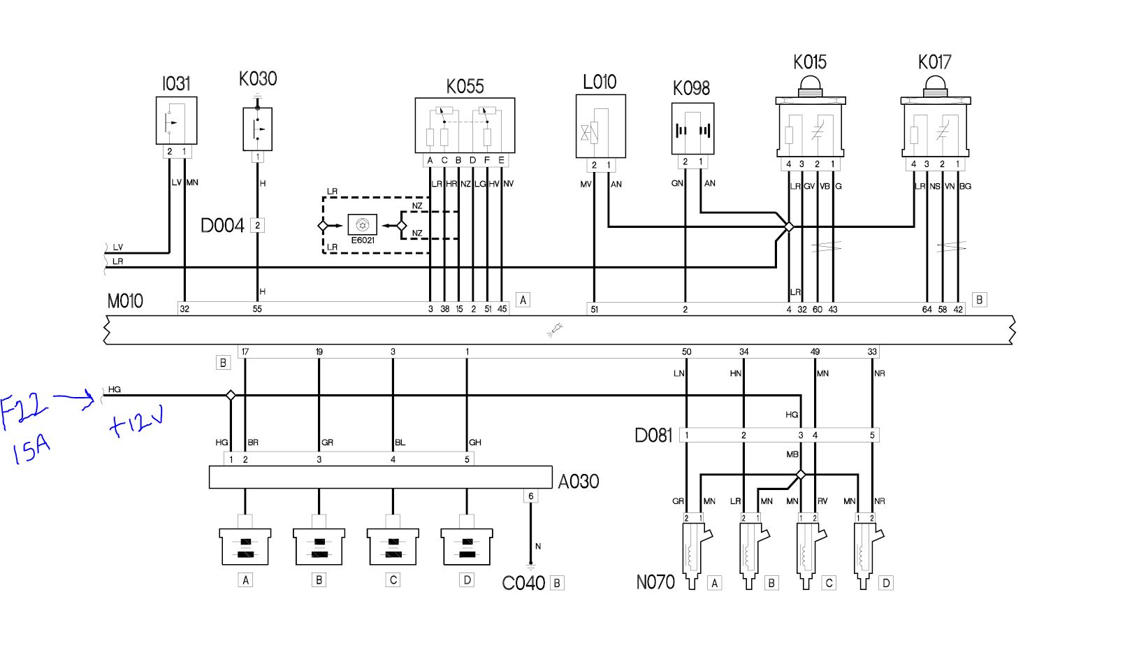

If you knew which pin on the connector is was, you could run some continuity tests at the coil and injector ends.
In the attached, A030 is the 6 way connector to the coil pack with pin 1 being +12V and pin 6 being ground.
The injectors do not share the same common ground as they are grounded by the ECU individually when activated, but they do work off the same +12V fuse F22; Pin 1 of A030 and Pin 3 of D081.
So failure of both would probably mean tracing the +12V feed through the loom to F22.

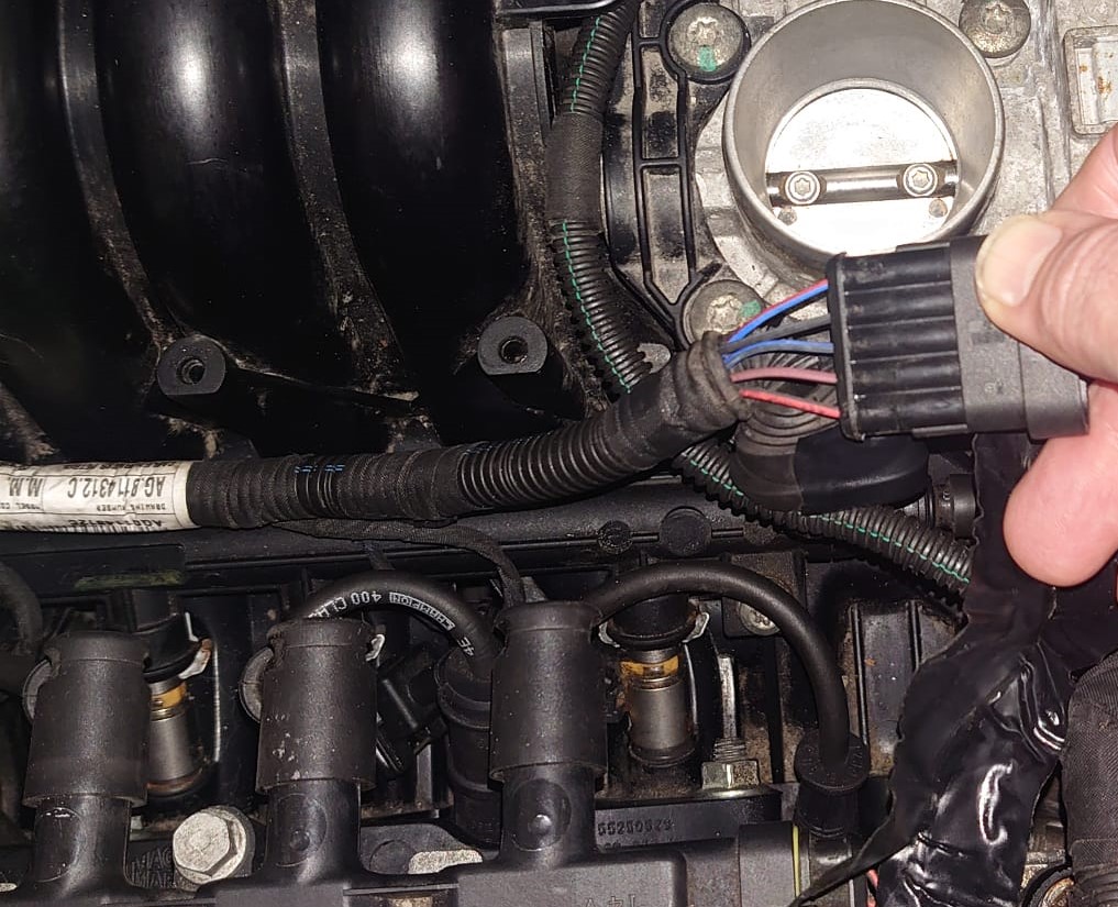

I am installing a secondhand 30k Ford KA engine in my old Fiat 500 312 1.2 8V. I've noticed the Ford fuel injectors wiring loom looks the same as the old FIAT one but has a different product code stamped on the loom label. The injector loom had been fitted with the connector sited on the left (nearest the cambelt) rather than the right nearest the main loom at the thermostat (where I had expected it to be). I removed the fuel rail, cleaned the injectors when in there and refitted with the injector loom connector at the thermostat and connected it up to the main loom. However, I am not 100% sure if I have the injector loom connectors on the correct injectors - is there any way to confirm?

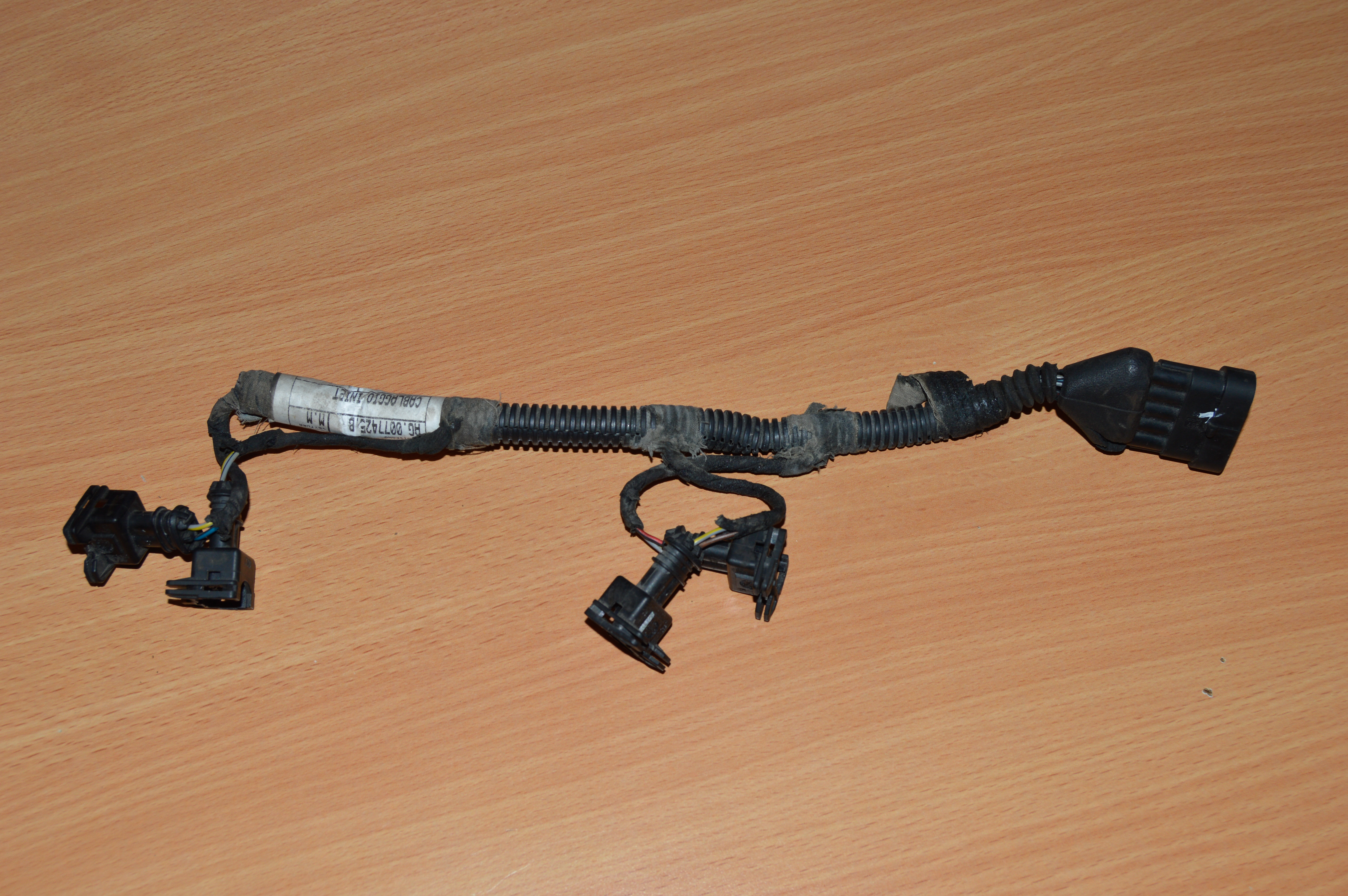

Below is the original FIAT injector loom in the orientation it would be in the engine bay (facing the exhaust manifold). I notice each injector has a common yellow/grey wire and injector #1 has an additional blue/black wire, injector #2 has an additional grey/black wire, injector #3 brown/black and injector #4 red/black.
Loom code: AG 0077425 .B
Date of Manufacture: 16/10/08

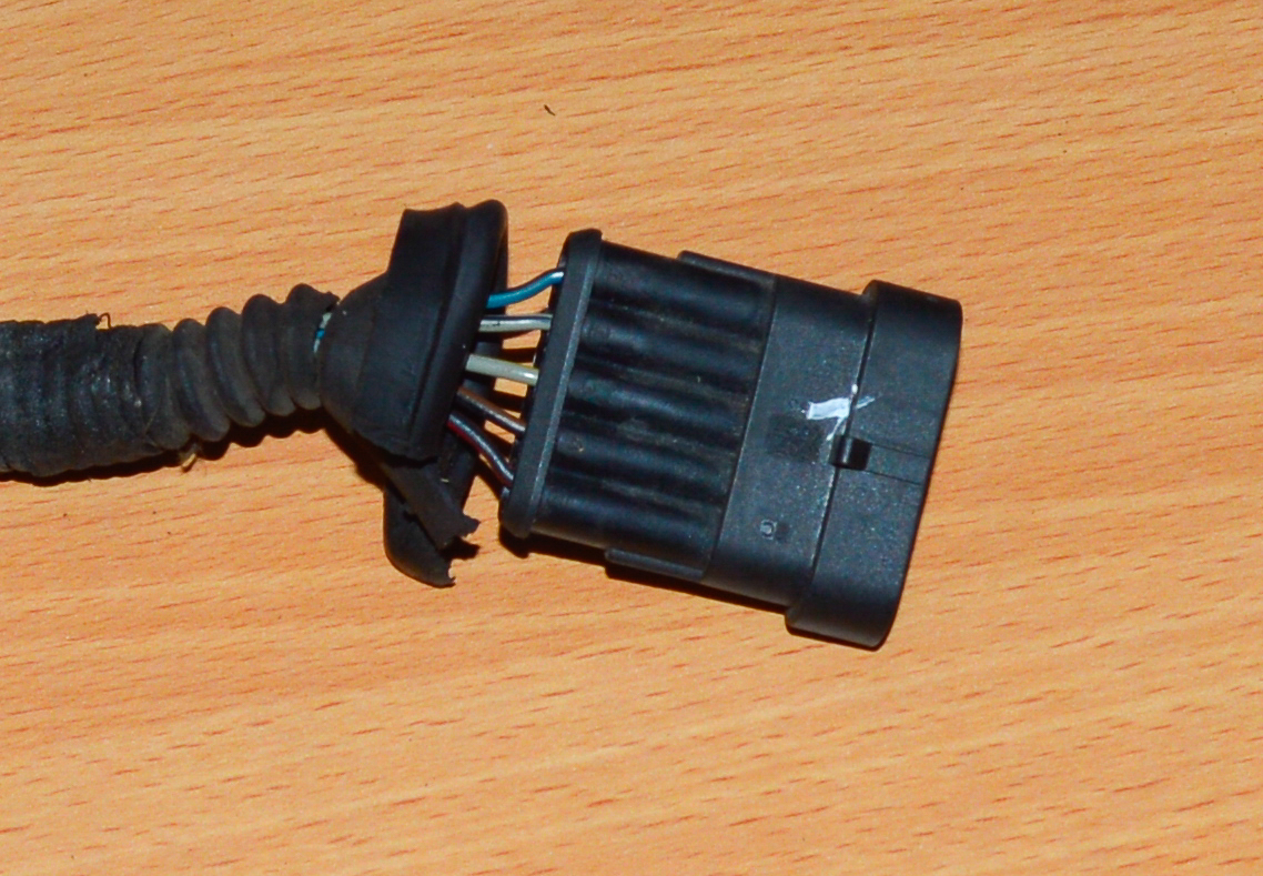

Assuming the bottom is pin #1: red/black, pin #2: brown/black, pin #3: common yellow/grey, pin #4: grey/black, pin #5: blue/black.
This doesn't match the wiring diagram above (I assume I have an older loom) so will check the more recent Ford Ka loom this evening and report back.
As suspected, the newer wiring loom is physically the same but different wiring colours. The wiring loom code is also different - AG 8114312 .C
I'm going to plug it into the main ECU loom and hope for the best (well I will check pin #3 is common to all injectors first!).

OK, don't do this! This wiring loom is for a later model and does indeed have the connector on the alternator side of the engine bay. I've ordered a new wiring loom for my 2007+ model and will swap out when it arrives!
