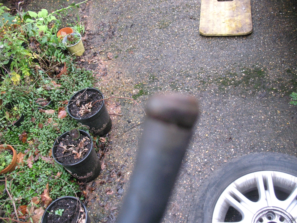

The rear right handbrake cable on my 2004 Multipla 1.9JTD snapped on Christmas Eve. It is the one with drum brakes at the rear. I have a replacement cable and know it is an easy job though not as easy as the disc model where the connection is visible! I have removed the blanking plug on the backplate and have disconnected the end of the cable at the lever but cannot remove the broken part out of the front of the backplate. Have tried a mole grip, WD40 and a hammer and old screwdriver but it wont budge. I haven’t yet turned to the blow torch and would prefer not to remove the drum!
I have 4 pics of the new and old cables and the backplate. There are splines on the end of the new cable which engage in the backplate.
Hope someone can advise

Not remove the drum..?
I would use a drill to weaken the stub...
Drill through the empty cable hole..
In 1mm steps..
It'll either twist out..or be weakned enough to drift though

But my fear is that there will be no way to extract the bits - coupling, spring and cable bit as there is not much visible before I start
Thanks
Normally...
Unlip the shoes set..to gain access to the 'nipple :nut'on the cable end..in the handbrake mechanism arm.
Uncouple then pass the cable forward.
ALL OF THIS REQUIRES DRUM REMOVAL
Thanks
Pity: I had hoped it was possible to feed the old cable out and then feed the new one through and hook it onto the lever as suggested on the Multipla Elearn CD
