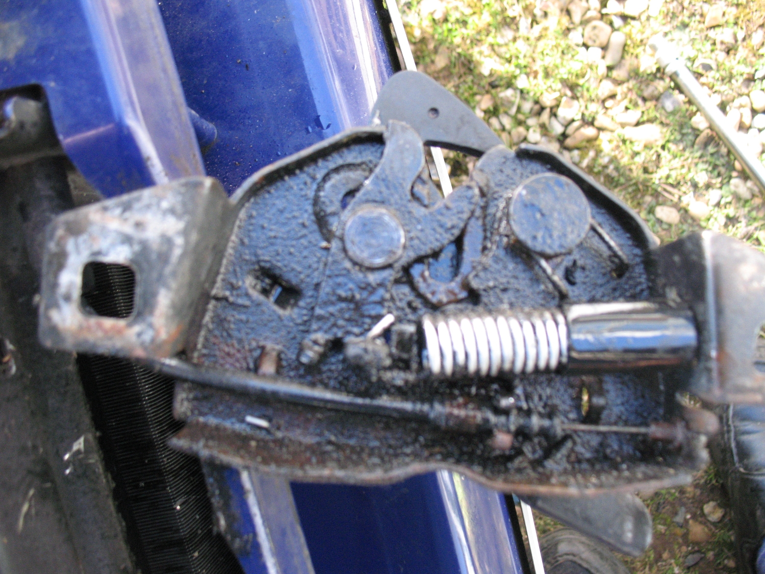

Having a second Multipla does help sometimes! I examined the locking mechanism on it and attach a pic of the reverse with the car's NS is on the left. The cable enters from the car's NS and is clipped to a release lever in one of several possible positions. The end terminal is fixed to the casing. So pulling the lever below the steering wheel will therefor shorten the cable inside the mechanism and make the release lever inside move towards the car's OS. I will need to make an L shaped lever to insert where the plastic piece was, to press the lever towards the OS. One thing I noticed was that after giving this one a good lubricating and reattaching it the lever wouldn't release the bonnet! Several attempts and relocating the mechanism solved that problem. You can see one of the squares though which the bolts go so there quite a variation in positions! If you are going to remove your mechanism I suggest you mark the positions of the bolts and mechanism before starting
