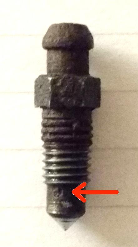

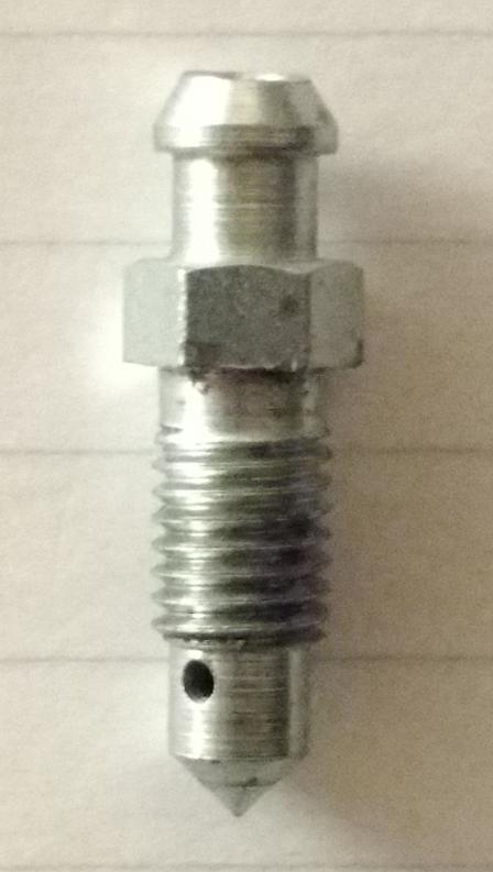

Went to my usual place to do my repairs, unscrewed the old nipple and hey presto the bleed hole was completely blocked, so blocked I had to look closely to find out where it was (see photo). I then screwed in one of the new nipples (see photo) which fit perfectly *and* once it was screwed in far enough, brake fluid started to come out of the hole in the end of the nipple not the base, as was the case with the old nipple.

PS. My garage said he replaced both rear brake cylinders a year ago. Does this bleed nipple look only 1 year old to you?

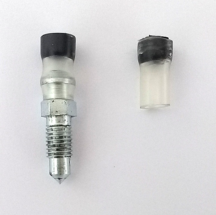

DIY brake bleed valve end cap/dust cap
Background: The bleed valves on my rear brake cylinders have no end caps/dust caps, and the new bleed valves I bought have none either, so if you are in the same boat, here's how to make your own:
Tools and materials required:
- Scissors
- Knife or saw
- Superglue or other glue
- Piece of clean bleed tube
- An old pen
Procedure:
1. Cut off a piece of clean bleed tube with the scissors.
2. Take the pen to pieces, remove the on/off button.
3. Put some glue in one end of the piece of bleed tube.
4. Push the *closed* end of the pen button into the glued end of the bleed tube and leave to set.
5. With the knife or saw, cut off the button so that it's flush with the end of the bleed tube.
6. Cut off the other end of the bleed tube to make the end cap the correct length - my end caps are 15mm long.
Takes about 5 minutes to do. (It took longer to write this than to make them!)
