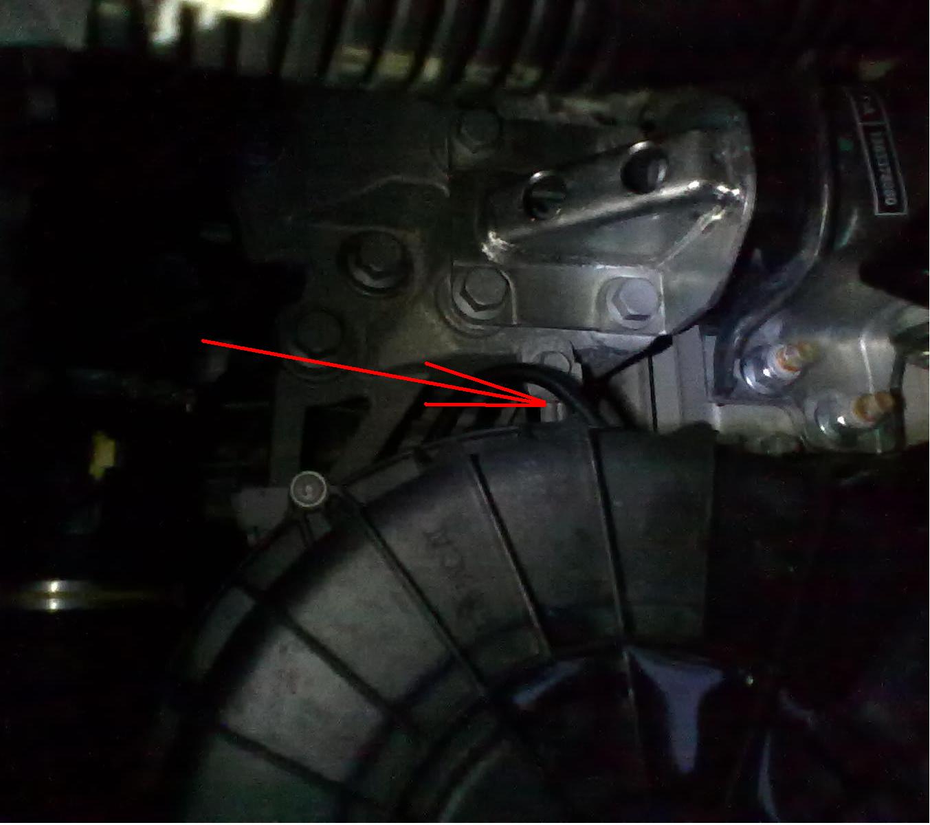

Can't remember the 2.3 location, but 3.0 is at back of engine so yes jack or ramps reqd, the earth strap can be seen if you look down back of the air filter housing, there are a few threads on here, some will show a photo, I changed mine for a heavy duty one a local auto electric place made up for me,

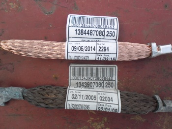

hi is it not starting only when hot as mine had the same prob it turned out to be the earth strap look for thread on hot starting plus clean the connections with wire brush

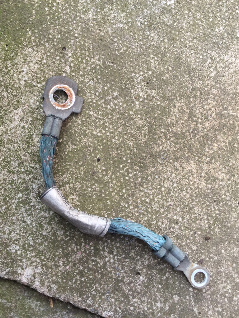

This was my busted strap, you can see also where the bolt was loose, and rust formed between terminal and bolt face,
Make sure these faces are cleaned up, and metalwork, refit and plaster it with copper slip or Vaseline to protect

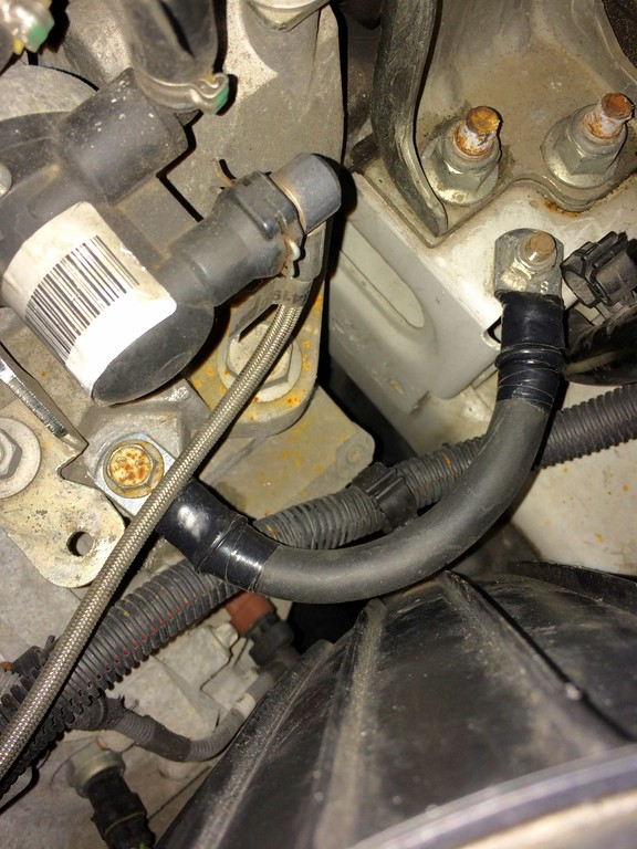

hi yes found some black earth wire from installing my inverter like this one copied from techno 100 as a spare
That's very similar to my made up locally strap, big amp cable :)
