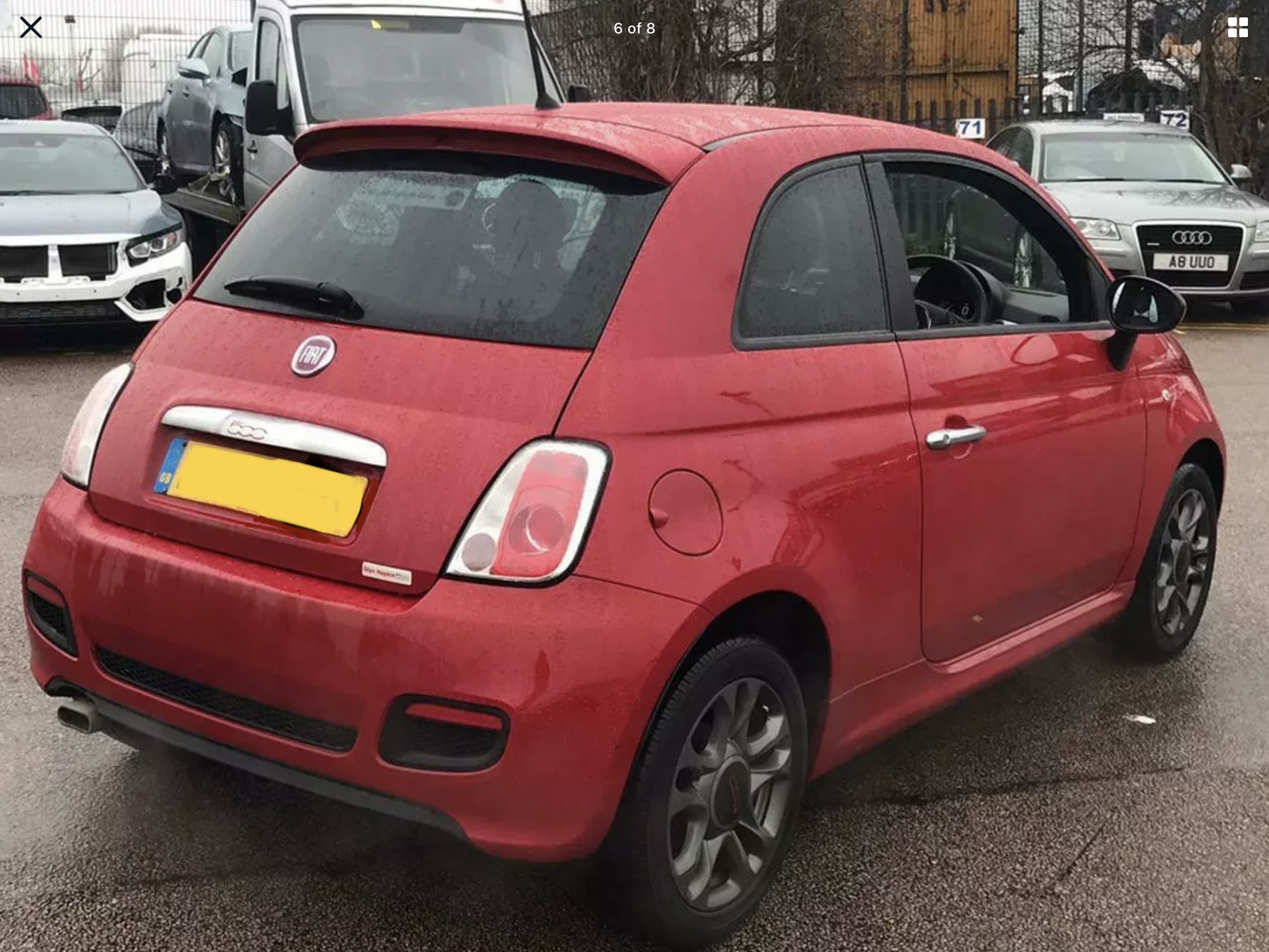

So we picked this 2014 500S 1.2 up as a private sale, with 37k miles on it was pretty clean but needed some work to get it to my standard; worst bits being a bonnet peppered with stone chips (50+ of them), three wheels with kerb marks and a mixed bag of tyres including one original Conti2. We also had no record of any service history for the last 4 years, albeit the filter and oil suggested it had been done at some point. No evidence of a cambelt change either.
On collection, prior to a long drive home..

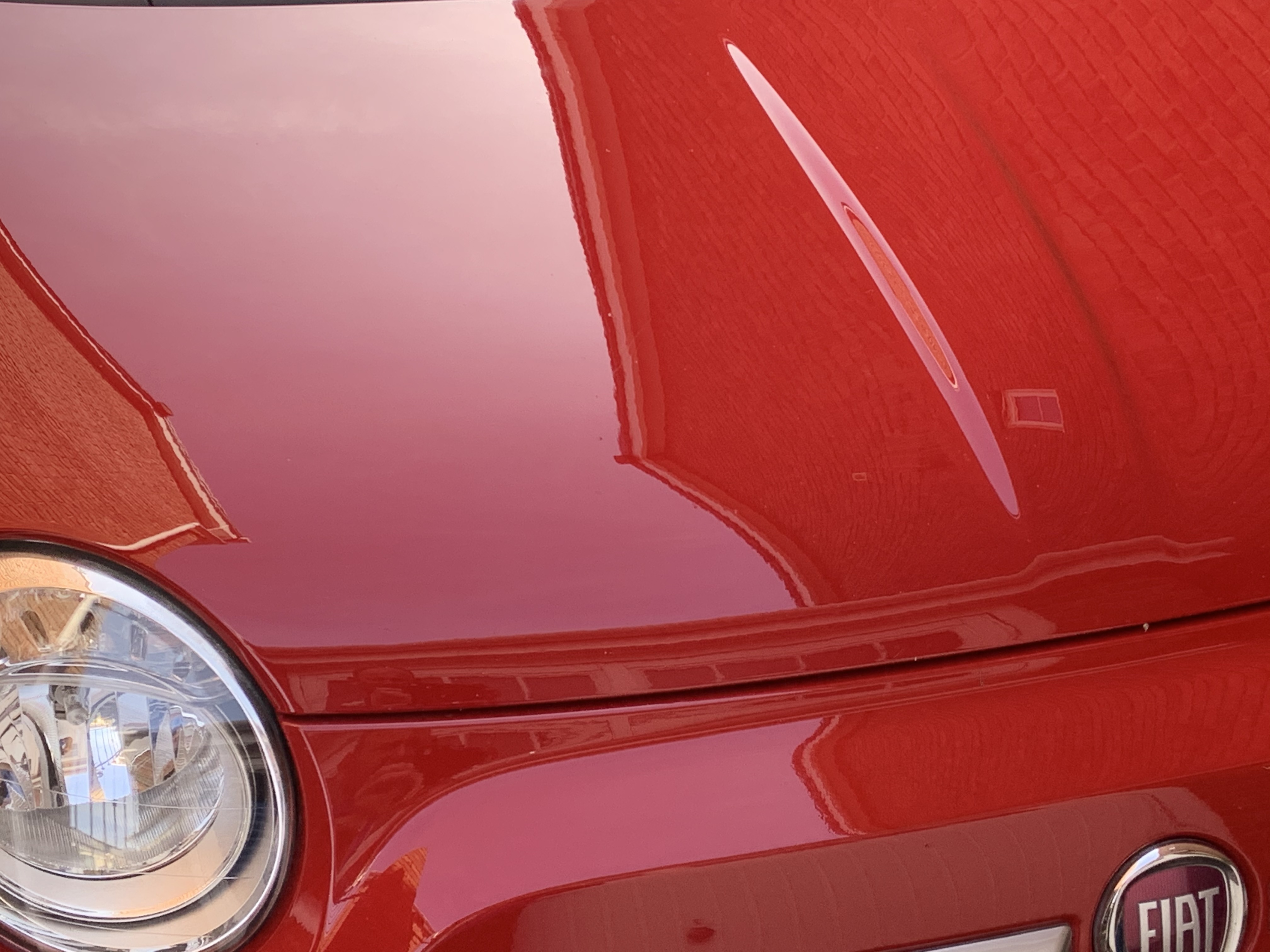

Stone chips filled with the Fiat chip paints and sanded back..

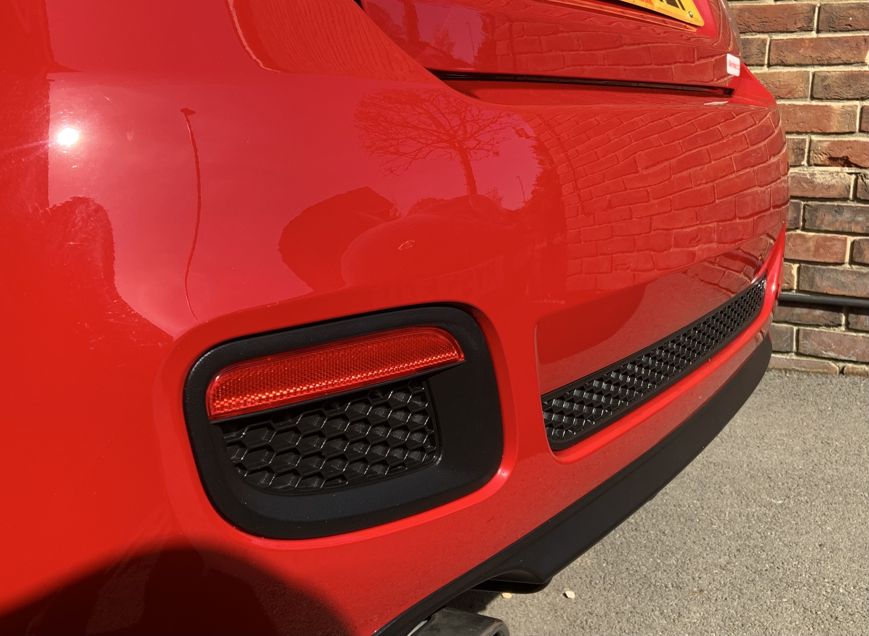

After a full detox, clay, 2 stage polish and waxing..

Quick question, when you have stone chips, you use touch-up paint, then sand it? Doesn't it scratch the paint?
Yes, add colour to the chip, then another layer of colour, then clear. Ideally 24 hours between each. Wait 5-7 days then sand with 2000/3000 grit wet n dry until level with surrounding area. Then polish with suitable compound to remove the wet sanding marks, easy with a rotary or DA polisher but it can be done by hand using something like farecla G3 or similar.

It just looks so scary though when a tiny stone chip turns into a 30mm diameter scratchy patch.
I usually just fill the chips in with paint on a toothpick to make them less obvious :)

Yes I used the toothpick rather than the supplied brush, albeit the clear lacquer doesn’t run so much on the toothpick as the colour.
When faced with 70+ stone chips it’s not really too scary to wet sand them, it would have been a respray or a replacement bonnet if the chip filling hadn’t worked reasonably well (y)
