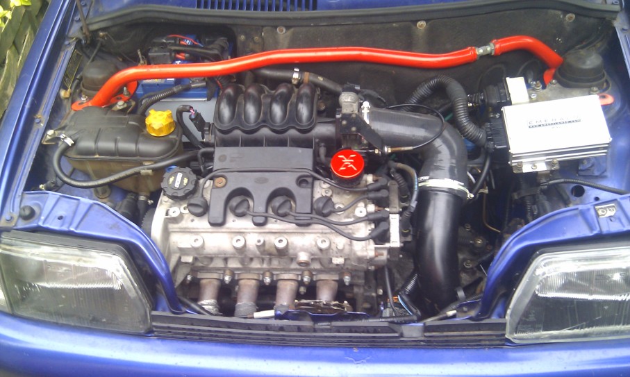

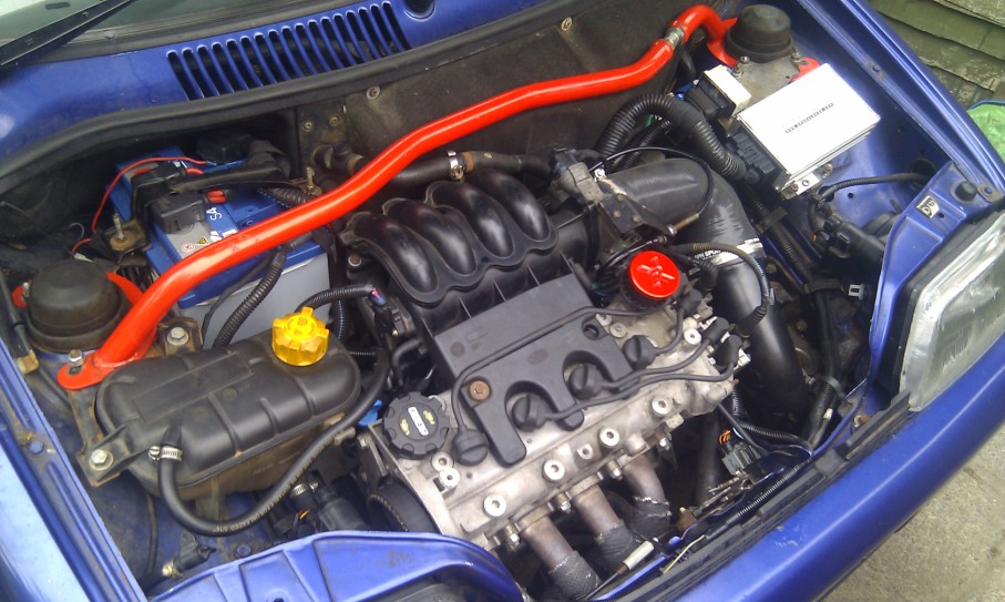

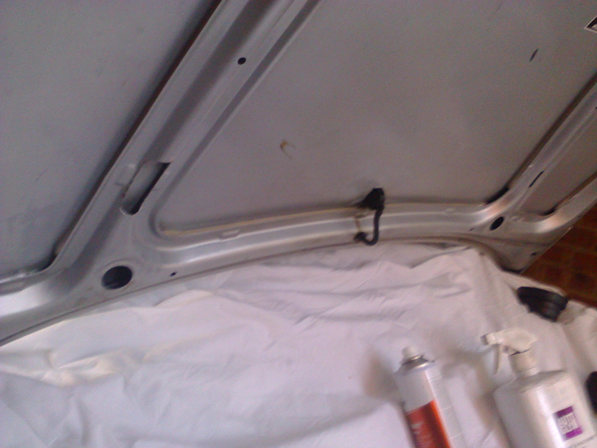

You've got the pictures of my Cinq there. I've cut part of the bonnet away to accommodate the brace as well. You might find it also hits the washer jets too, but it may not.
The hole locations for the brace have also changed as you spotted, but that is to change the suspension geometry, rather than move the brace.
