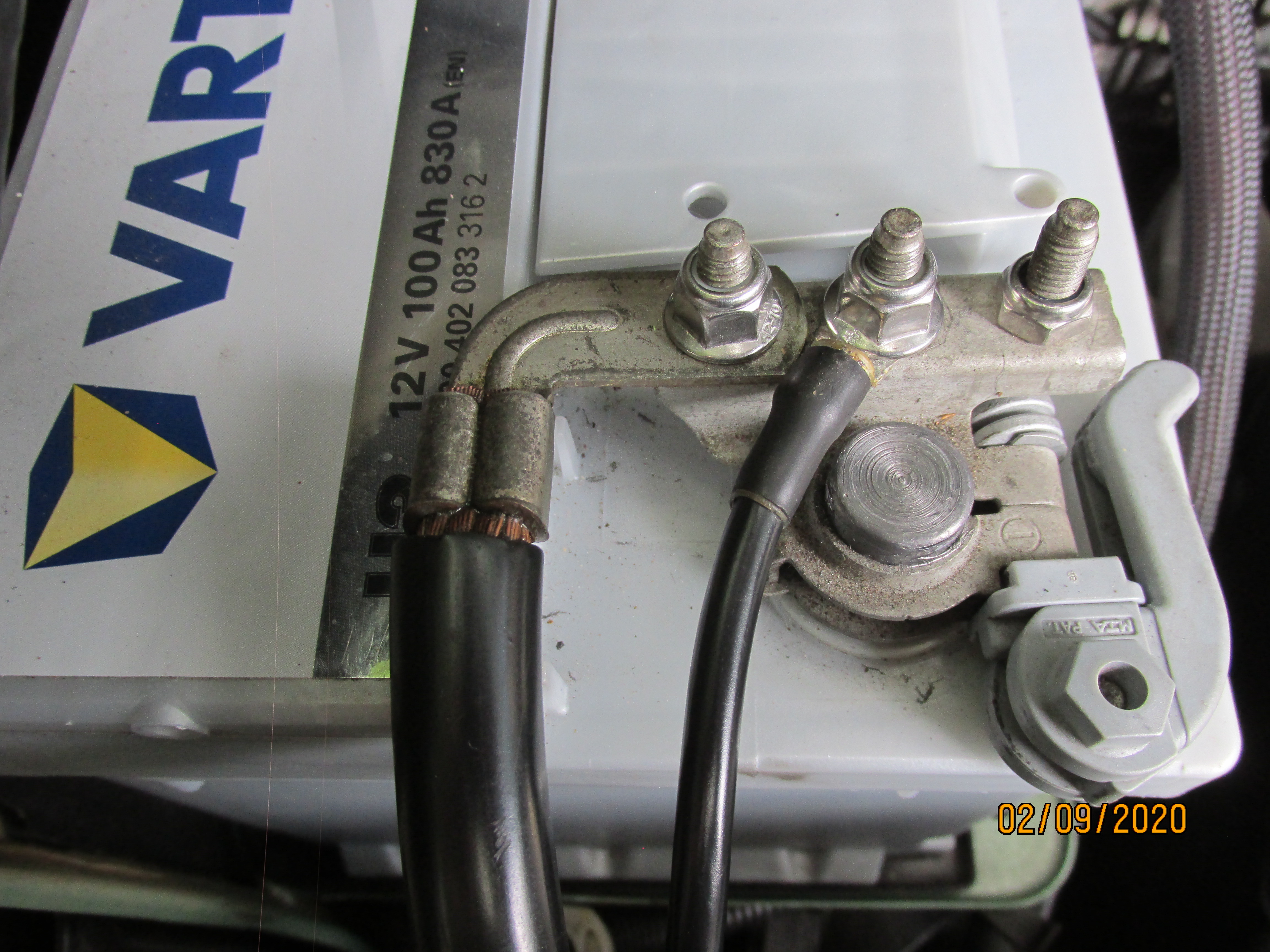

As suggested check all connections for tightness. I strongly advise removing the battery negative connection, before using a metal tool on the above connections.

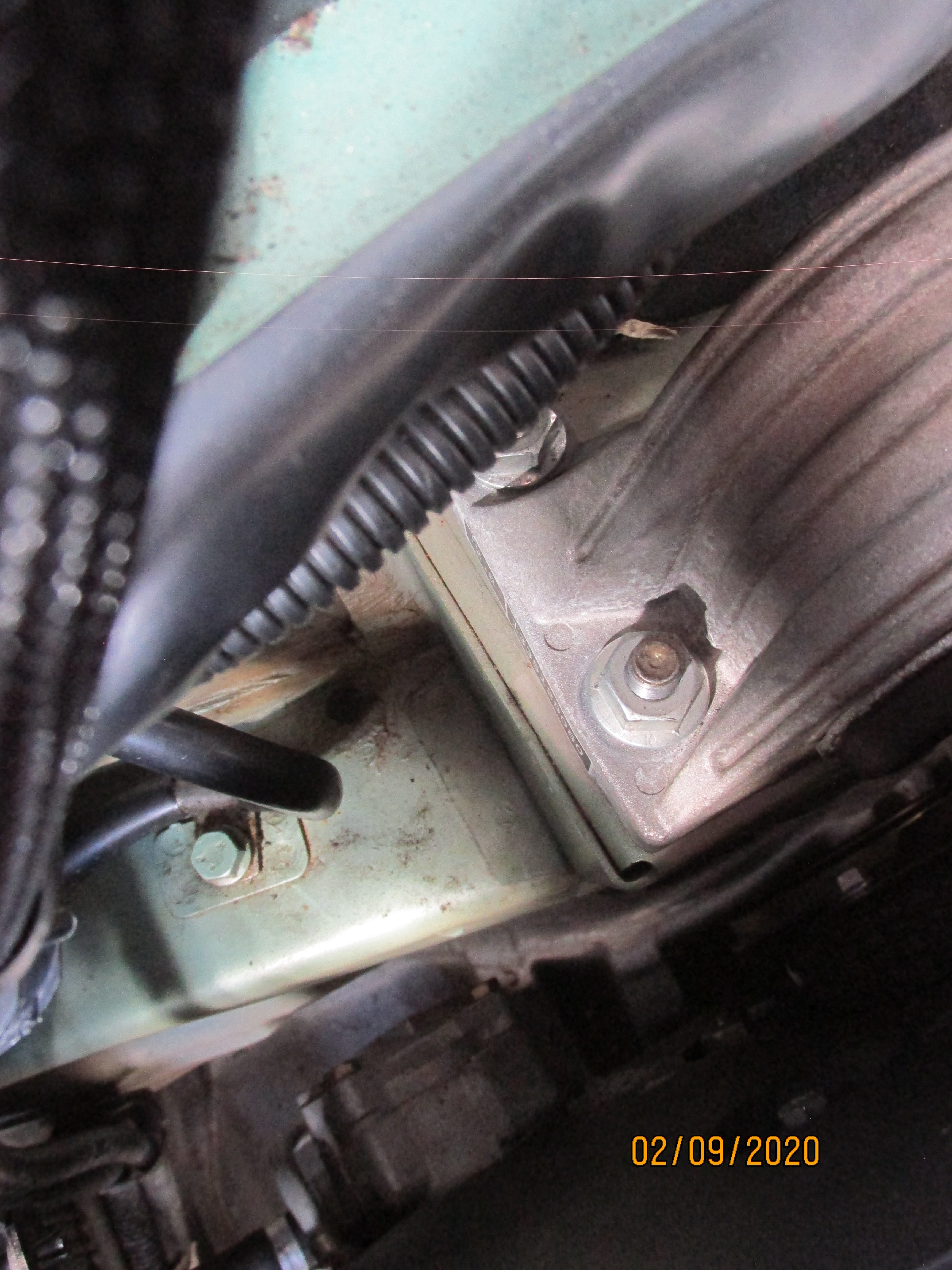

The main chassis earth point is below the front of the battery on the RH inner wing in front of the engine mounting. 13mm socket with extension bar required. See photo. Best to apply thin smear of vaseline to cleaned contact faces. Headlamps and ECU are earthed to the chassis, so this earth pont is in the critical current path. Corrosion inside the flag terminal has been reported.
