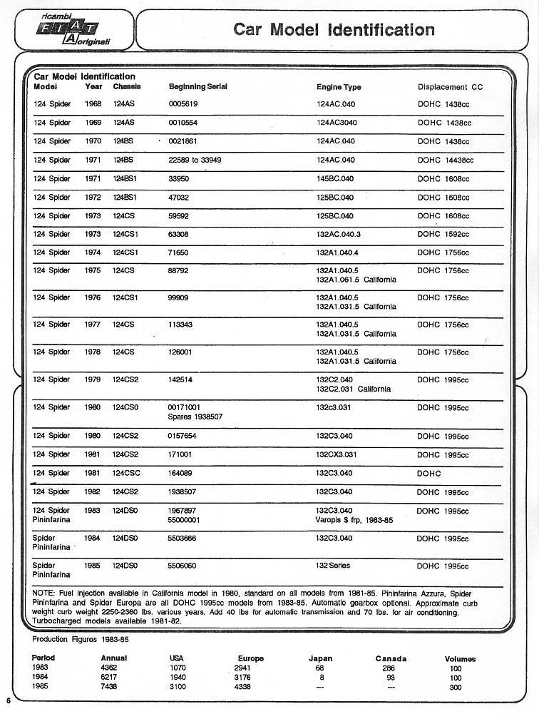

The numbers on the block are probably just casting numbers. If you have the chassis number (VIN) from the car, this list from the Spider parts catalogue will tell you which engine type the car should have.
