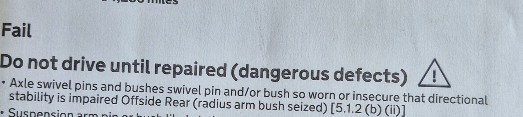

hi all so the old girl failed her mot few easy bits but failed on rear axle did ask him to explain but my tester had gone for his lunch so didn't want wait around for a hr have included a picture of the fail

I assume that means replace the rear bushes on one side that has failed though obviously best to do both, but it would be nice to get confirmation from the tester.
yh definitely , I'm hoping to get 5 tomorrow pop in and see him if he there,, so I've had a search on the bushs and pins and I can't find any info on it at all forgot to mention its the Alko Axle
You may get parts from a towing specialist who deal with Alko trailers and bearings etc. Down here it is Western Towing Attachments.
Only a guess mind.:)
