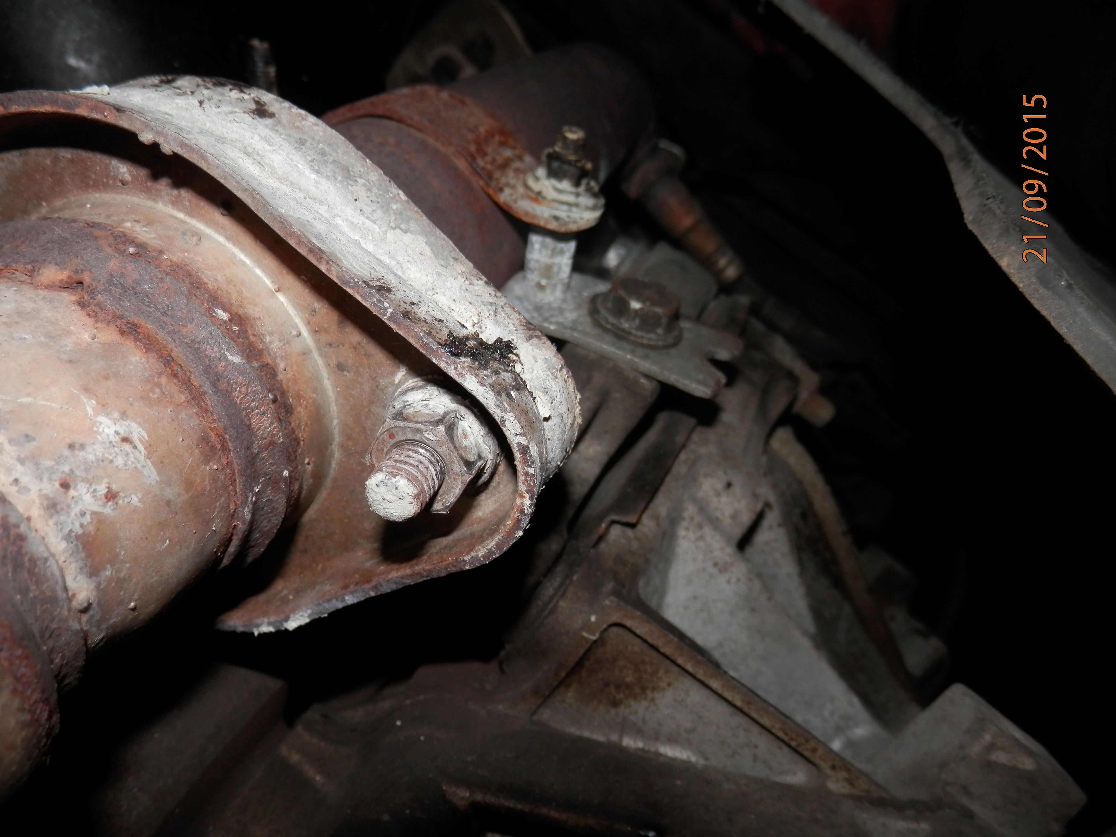

Exhaust front pipe support bracket broken:
This is my first car and this was on the MOT already broken.
If anyone knows how what this means or how to fix it (in detail) as im a complete car newb please help me
welding means putting things together to make it un rattle able i dont have a welder can i use metal clamps or metal hose pipes (will this pass the MOT) i am yet to look under the car
Lay on your side in front of car in the middle & look underneath you will see the exhaust pipe going back under the engine there should be a L shaped bracket bolted to the gearbox housing & connected to that is the rusted front support bracket around the exhaust pipe. Now you can either remove the rusted bracket & forget it or get a suitable piece of galvanised steel from say Wickes & make a new one as I did.
My car passed M.O.T with a rusty broken bracket as the exhaust can't fall off as its bolted the engine so removing it totally will not lead to a failed test, I just replaced it for my own peace of mind.

I decided it was worth having this bracket on the car and spent about a day messing around getting it done using stuff that could be bolted together and had to be bent to fit on a large vice so it went together without stressing the exhaust.

Whats happening is the brackets that go around the exhaust are rotting off
This in turn causes it to rattle so mechanics and DIY's just take them off
There is just 1 problem with that
I've now had to have mine weleded up 3 times because of it....
What have i done to fix it?
Fitted a U shaped exhaust clamp - using 1 of the studs, make a bracket to attach back onto the original gearbox bracket
So far im hoping no more blowing....

So now you have transferred stress to the expensive exhaust manifold which will eventually break. The manifold should be held securely at the gearbox so as the engine wobbles around at startup or when going over bumbs etc it cannot bend the manifold, and then all the movement occurs via the flexi link and the rubber blocks.

You do not seem to have understood what I have told you.
The exhaust should be fixed to the engine at the bracket that you told us was broken. It was suggested to you that you get a welder to fix that bracket.
The first part of the exhaust and the engine and gearbox should be moving as if they were a single piece of metal.
