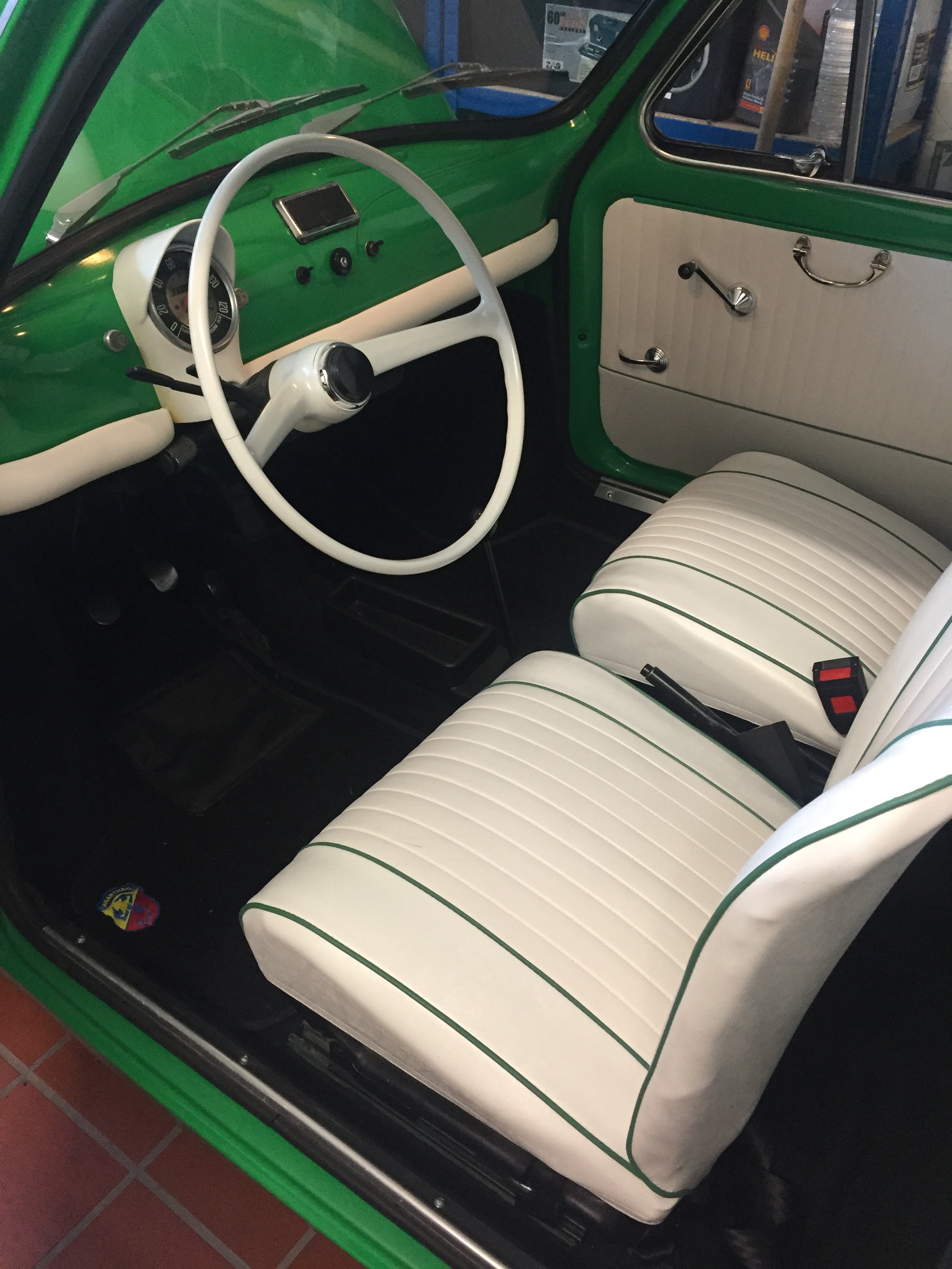

Engine wise. Yes, will look at an upgrade at some point in terms of HC pistons, bigger carb, sports cam etc. But its a winter project. Along with that comes the bigger sump pan, fan upgrade etc.
However, I like to keep the look standard. So mine will still be on the 3.5 wheels with cap. Interior wise, mine is already pretty funky. White piped in green to match the exterior colour. See pic :)

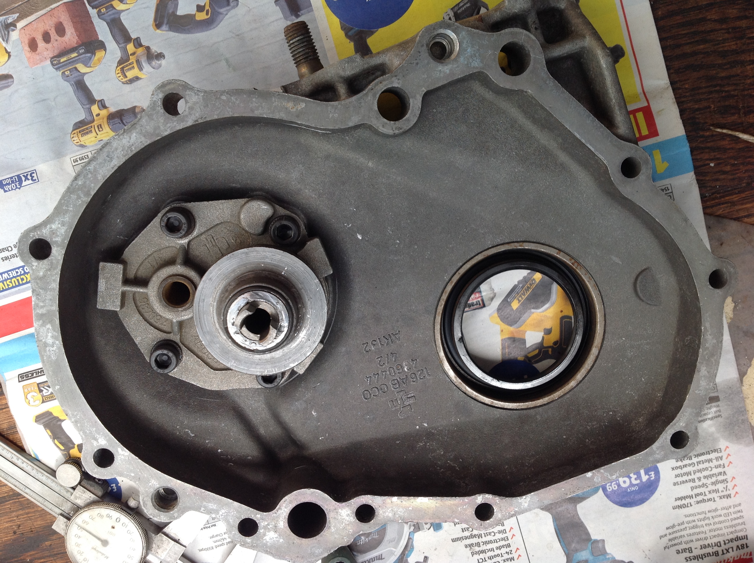

Not sure if this mod fits the bill being an invisible thing inside the engine. I always find that removing the oil pump from inside the timing chain cover can be quite tricky as you cannot get a 10mm socket onto two of the fixing bolts unless you part dismantle the pump by removing the dreaded circlip. So I refit the pump using suitable high tensile socket head screws which makes life so much easier :)

Not sure if this mod fits the bill.......... I refit the pump using suitable high tensile socket head screws which makes life so much easier :)
Certainly does... along with the exhaust studs mods and teh silencer stud one that Tom describes...

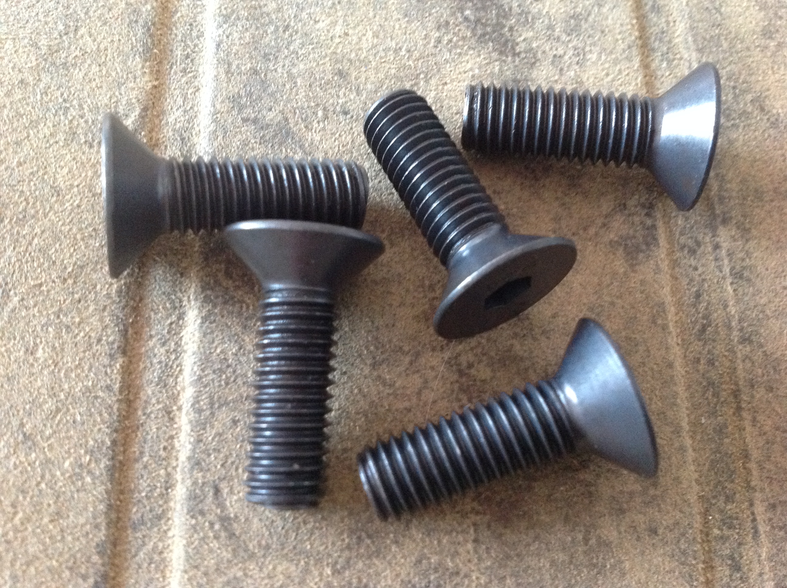

Behind the timing chain you have the front main bearing. Held in place by 4 standard hex head screws and two countersunk screws that have a very large cross head screwdriver drive and are secured with special shakeproof washers. Those two screw heads often get a bit mashed because of the difficulty undoing or tightening them and not having the right size bit. These two can be replaced by M8 x 25 countersunk screws to make life easier. Additional point here , the four hex screws allow a very small radial movement on the bearing but the countersunk do not. Whatever screws you use it is best to lock down the countersunk screws first otherwise you risk cracking the cast iron bearing housing.

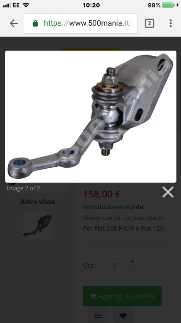

I like the look of this one to the steering idler arm. Bearings instead of using the tension and friction of the rubber blocks

I think that you will find that most of the after-market suppliers now supply the 'cap-head' version of the countersunk screws rather than the 'cross-head' versions, which I agree, are a pain in the bum to torque up correctly (I used to use an "impact" screwdriver), and an even bigger p-i-t-b if somebody has previously 'mashed' them.
I don't know if these are the right grade but I've been using the smaller sizes for various jobs as they are so neat and so cheap. They also do nice, mushroom-headed ones to match.
https://www.toolstation.com/shop/Sc...ainless+Steel+Socket+Countersunk+Screw/p75710
PS. If you have the right bit on your impact-driver (PZ3 I suspect), removal is a doddle. When re-torqueing I put the 1/2" driver socket that accepts the screwdriver bit onto my torque-wrench and tighten the ring of setscrews in stages working on opposing screws in sequence as with a cylinder-head or road-wheel.
