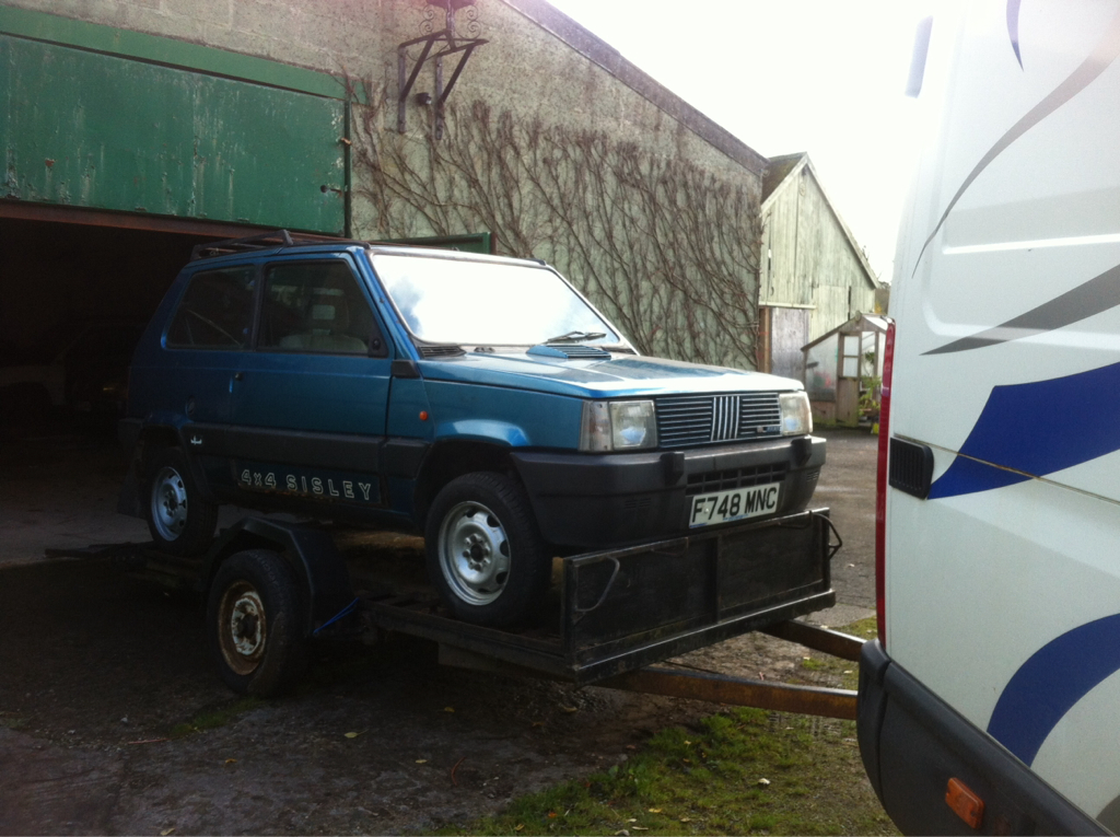

Monica (now named) has been amongst a couple of forum members now, where she has been dry stored for the past few years. David aquamarine got her at first, then she was moved a bit further north to Paul doctyler where she was due for a re-shell into his black 2wd chassis. Paul told me that he currently doesn't have enough time to complete the project, and has his sights on other projects at present, so he asked if I would like to have a go at this one...
As I've only had a brief look over her at present, she is still wearing her coat of storage dust for the pictures...
Paul had been very helpful as always by dragging her out of the store for us to load up.
Originally she was due to be stripped for the drivetrain and running gear plus Sisley specifics for a reshell into a 2wd car as I have said, but we've had a look round her and to be honest I'm happy initially to get her back on the road. The idea of a reshell would be just right for a car like this, but it's something that would take me a long time to get finished - and with the current projects I have on the go it would take even longer!
My idea with Monica is for a basic repair and restore, and a return to the road. Then all being well she will be introducing a new member to our forum in the shape of Sam, our photographer and un-scared Discovery driver from the last Yorkshire weekend, whom most of you met. Sam came along to collect her and have a look with me...

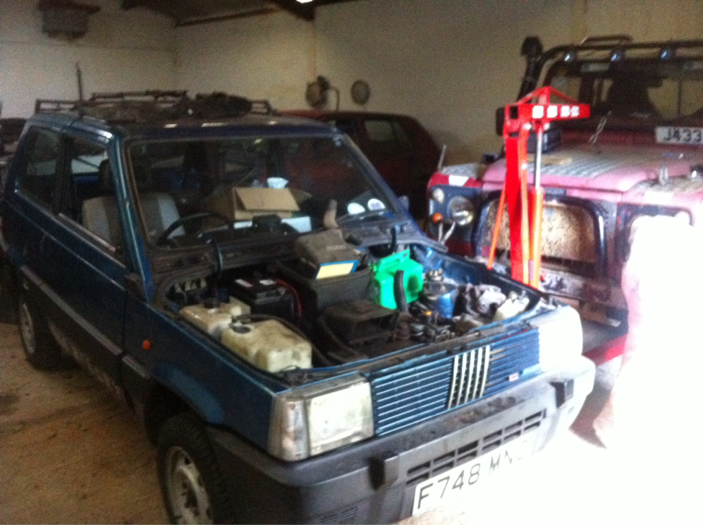

So she's with us now, first target for me is to get her running (after a good wash), so then I don't have to push it in and out of the workshop! Wish me luck, and I will report back :)

Monica was back on the trailer we picked her up on to go up to a local garage for prep for the MOT , the difference is she drove her self on under own power !
This will include welding the sills and repairing / replacing the doors. Getting everything set up and hopefully an MOT.
