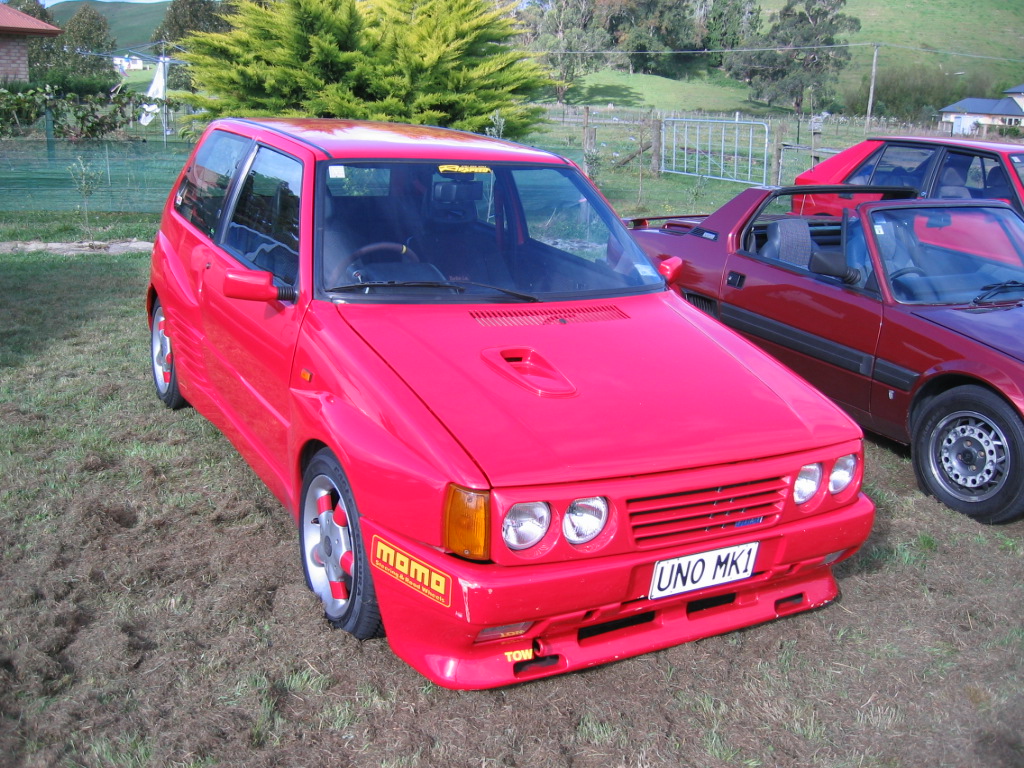

I've seen a Mk1 modified with round lights (attached).

HMM.. cool .. but the round ones .. i dunno maybe its just the color, making it look dumb.. but will do first wat Alex said .. time to get some new wires and relays ..

As for the colour "making it look dumb", I agree totally, though my camera has possibly lied a little. However the car next to it looks correct - the mica red X1/9 - well, what can I say ;)
