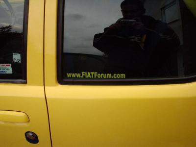

the 1st mod for any fiat has to be the fiat forum sticker

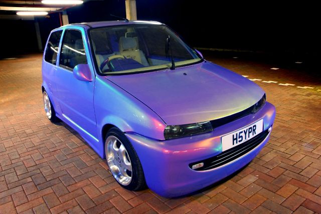

styling
one of the 1st modifications many centoers go for is alloys.
a quick and (sometimes) easy upgrade

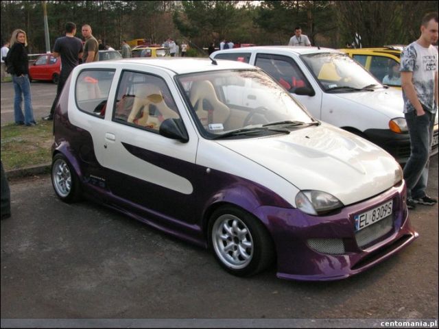

bodykits
so theres not a huge selection of kits out there TBH
abarth replica kits,storm kits and some other external bits for the cinq are available from http://www.tuning.co.uk/fiatshop/
they also do kits and bits for the sei's
dont forget scrappys and the classifieds for abarth bits etc
there are some ebay sellers selling GRP kits but be aware quality of fit is often hit or miss
http://www.tuningshop.co.uk/acatalog/Fiat2.html here there are kits for the cinq & sei including Hormann
if you want to be a bit more unique you can also fit parts from other marques/models but costs & skills requirements rise here
other external mods are clear side repeaters,front for the non sportings etc
to be honest look in the gallery and you will see plenty of modded cinqs of varying degrees

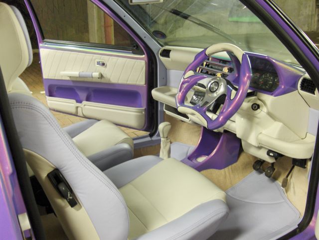

interior styling
small upgrades can prove 'more' than to much here
eg cinqs you can fit sei abarth seats,bucket seats,paint some bits of trim,white dials,mats,sports steering wheels etc
seis the same unless you already have thew abarth seats
again is budget and imagination here plus what you use it for.
some people need shopping space and some are happy with stripped out tarmac terror styles

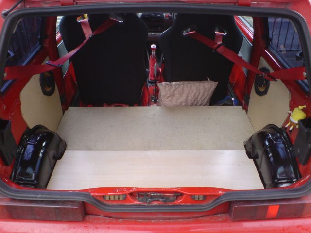

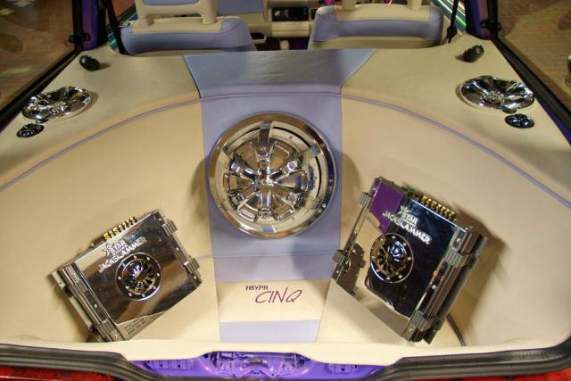

ICE
front speakers in both cinq & sei are 10cm
if you want to keep the grills then dont get ones with high centre cones
rear speakers can be fitted in the rear side panels or rear shelf.
its better to fit an acoustic shelf if you want to do this.
though for a decent set up its said to be better to have a sub in the boot and component speakers up front.
to do this you need at least 1 amp to drive the sub and components.
the components would need fitted in the doors or pods as 10cm is really too small for quality sound reproduction.

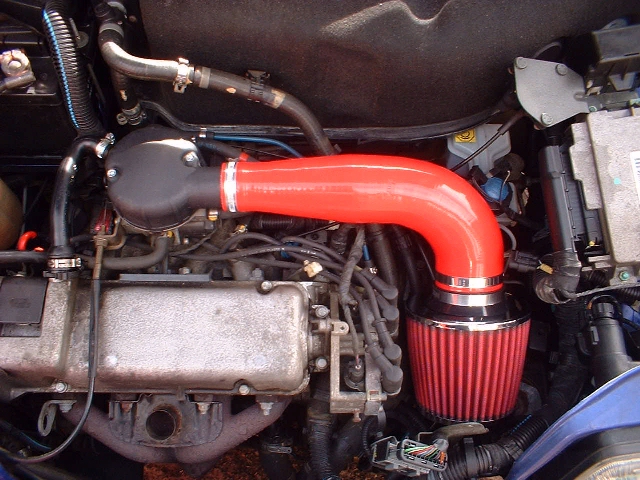

so air filters and induction kits:
performance panel filters: these are the cheapest and easist to fit.they allow the air to pass through more easily than standard filters.
K&N type filters:these sit on top of the throttle body and draw in air from there.
they make a nice noise but need good cold air feeds to function
induction kits: you will see phrases like GSR,BMC used around the forum. in cento land these relate to remote filters with a silicone tube feeding to the TB.
using the GSR as an example it draws in air in fom a cooler part of the engine and the reducer silicone tube increases the speed of the air drawn in.
these types of induction kits give the best gains but are the more expensive induction options(for natrually aspirated)

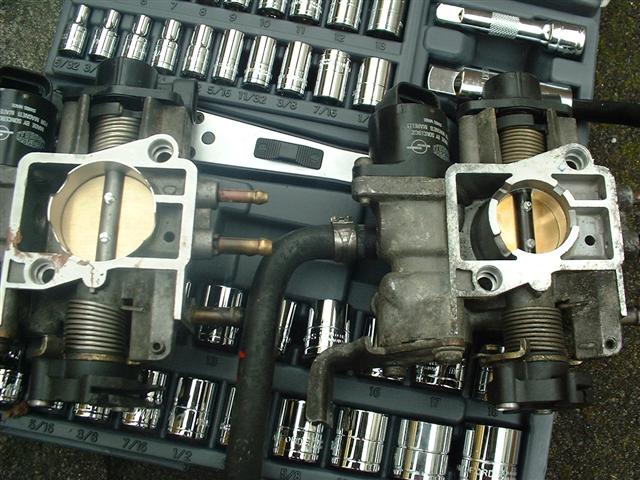

Throttle bodies
you can get enlarged throttle bodys from other models like 32mm,38mm or an overbored one @ 40mm
standard V's 40mm(bottom view)

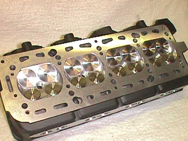

headwork
okay this is getting into more extended performance mods.
a good engine builder can produce power by 'working' the cylinder head and valves.
its an art and costs run into the £00's

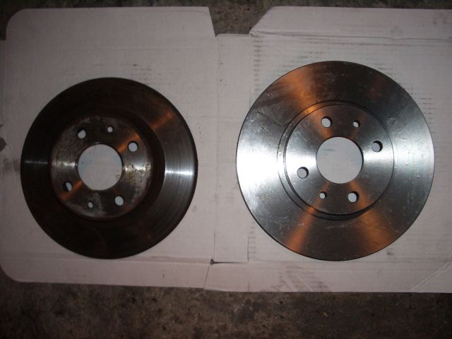

- performance pads
- performance pads & discs
- larger calipers (AKA GT upgrade)
- discs all round
- 1. performance pads increase the bite of the breaks,some decrease dust as well
- 2. performance discs can come in drilled,grooved,dimpled or a combination
- the combination can improve brake feel & performance
- 3. the gt upgrade(see the other faq)uses larger calipers and ventilated discs.
- the venting helps prevent brake fade and the larger calipers/pads increase braking force
- 4. if you really want increased braking then you can convert the rear to discs.
- however bear in mind the increased weight from this set up and the fact it should be combined with bigger front brakes to maintain the front brake bias
Throttle bodies
