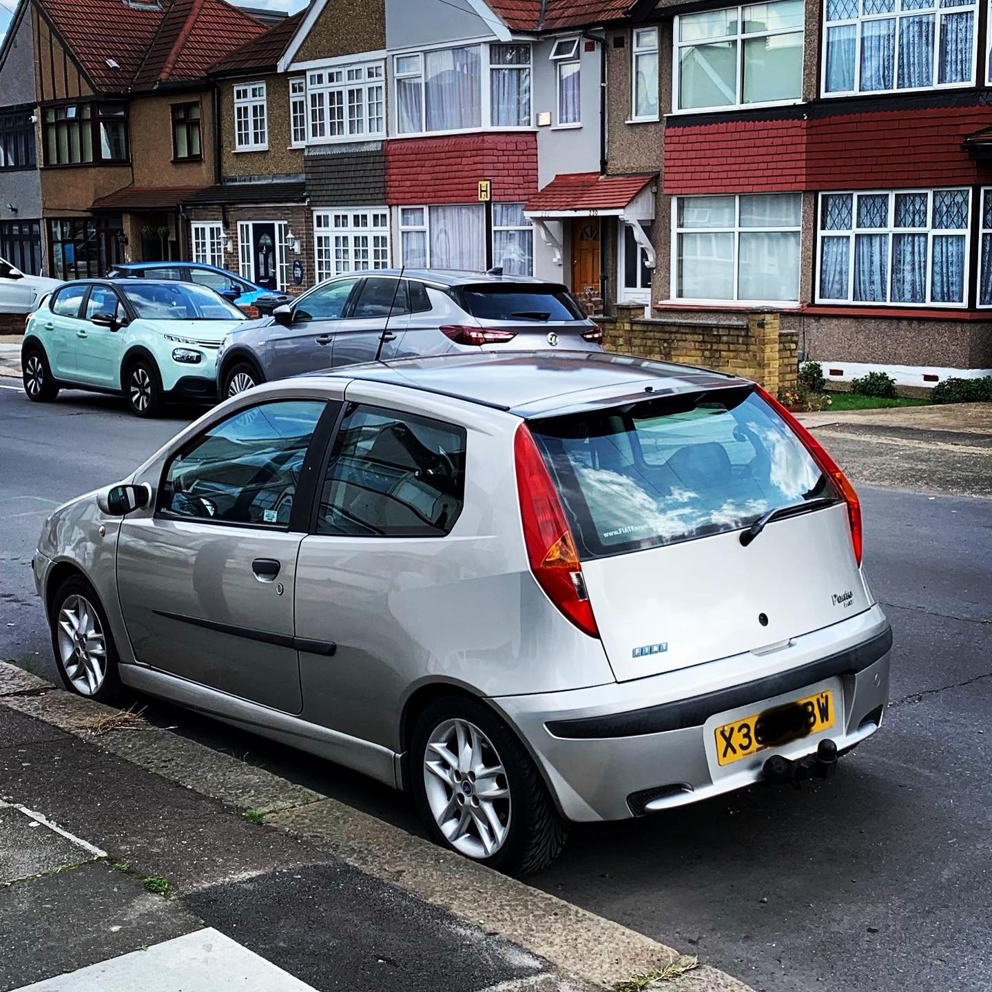

Pic added from last year when carbon fibre wrap was added to the roof.
