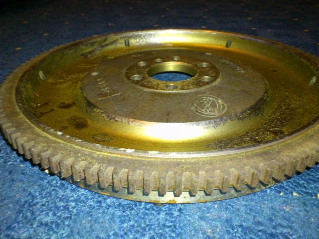

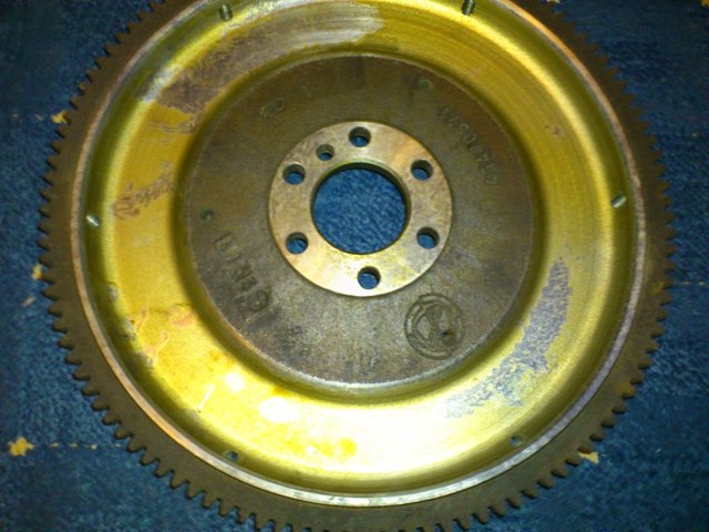

the lightened flywheel how much for one of these and what are the advantages and disadvantages

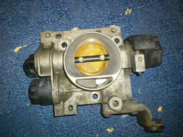

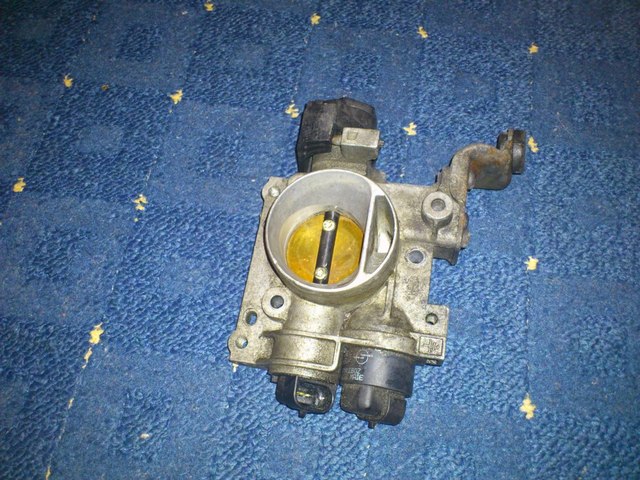

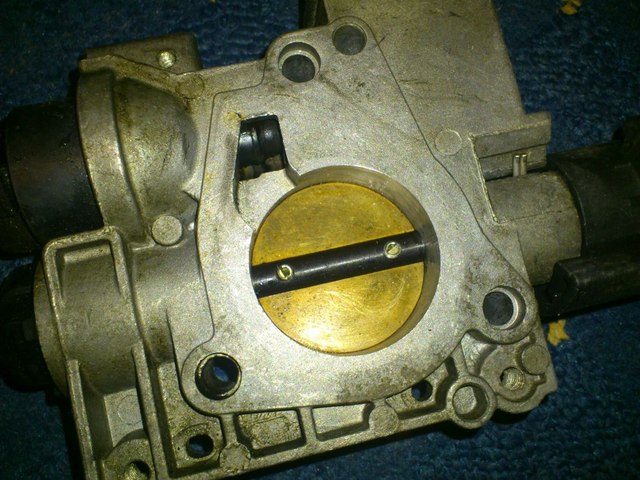

40mm GSR throttle body if im making the diameter of the throttle body bigger am i still able to fit a cda airbox been told its better

Did GSR ever make a 40mm TB for the Mk2? Are you sure you have a Mk2, etc.
There are no real disadvantages to a properly lightened flywheel except -- possibly -- for a slightly lumpier idle. It's not about power, but about pick-up. A badly lightened flywheel can disintegrate and do a lot of damage. Member Brooky does them.

Lightening and balancing the flywheel is fine as long as done properly will cost around £30-£50 to have your flywheel lightened
Yes GSR made an enlarged throttle bodies for MPI it just looks like the bravo 40mm throttle but with a full mk2 housing so you can bolt the ecu to the rear I just bought one of here il upload pics when im not on my phone or take a look at the latest page in me members motor thread, the housing is still sane size so can fit you induction kit
