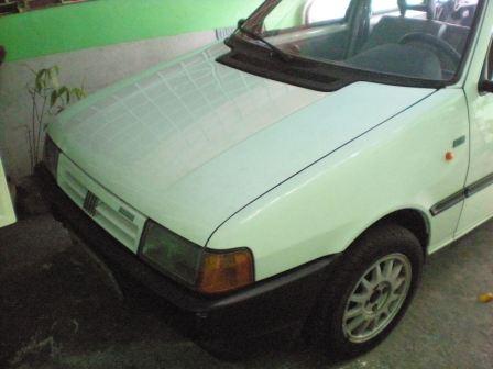

Hello All,
well bought myself a 999cc mk 2, it was in storage for quite a spell having only 77,000 on the odometer. I knew that it will take a lot of elbow grease to get this child to shine but I hope it will be worth the effort.
list of major problems;

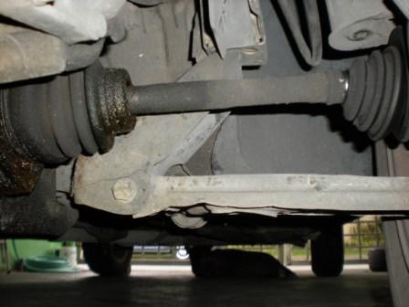

1. CV joints - got new ones for 20 USD
2. the engine had been overheating a lot.
3. the bracket mounting for the alternator needs work
4.radiator is all cracked and leaking
and not to forget the body repair.
will keep you guys updated and much appriciate for comments and suggestions,

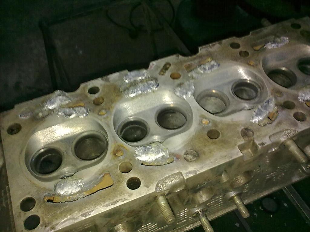

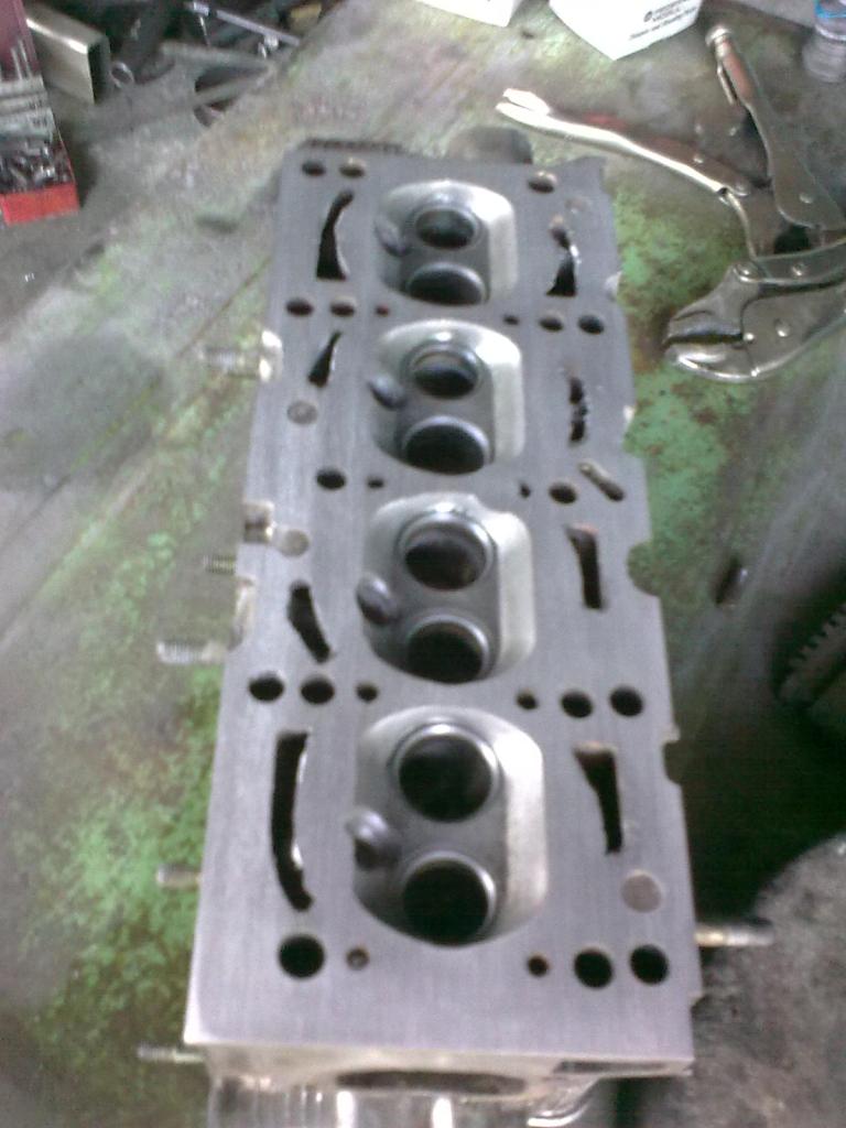

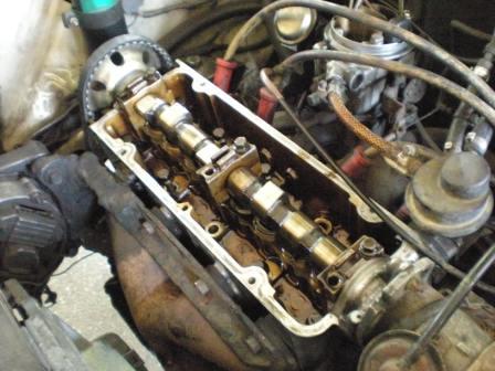

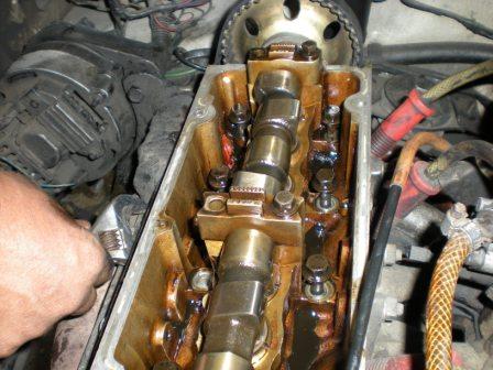

attached is the engine block during repair and after. :)
here be moar,

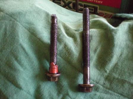

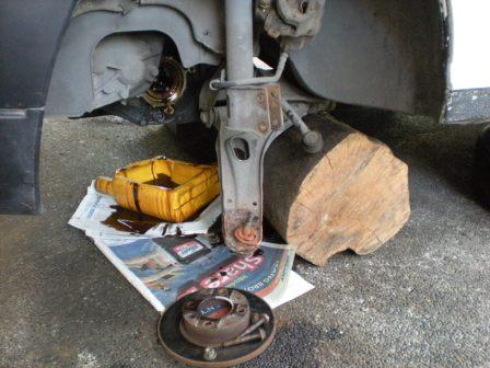

the bolts are from the engine, one broke off back in the past, and the previous owner had just put the thing back and glued it to the block!:confused:
you can also see the poor work on the bracket for the alternator which I am having one be fabricated as i typed.. :D
