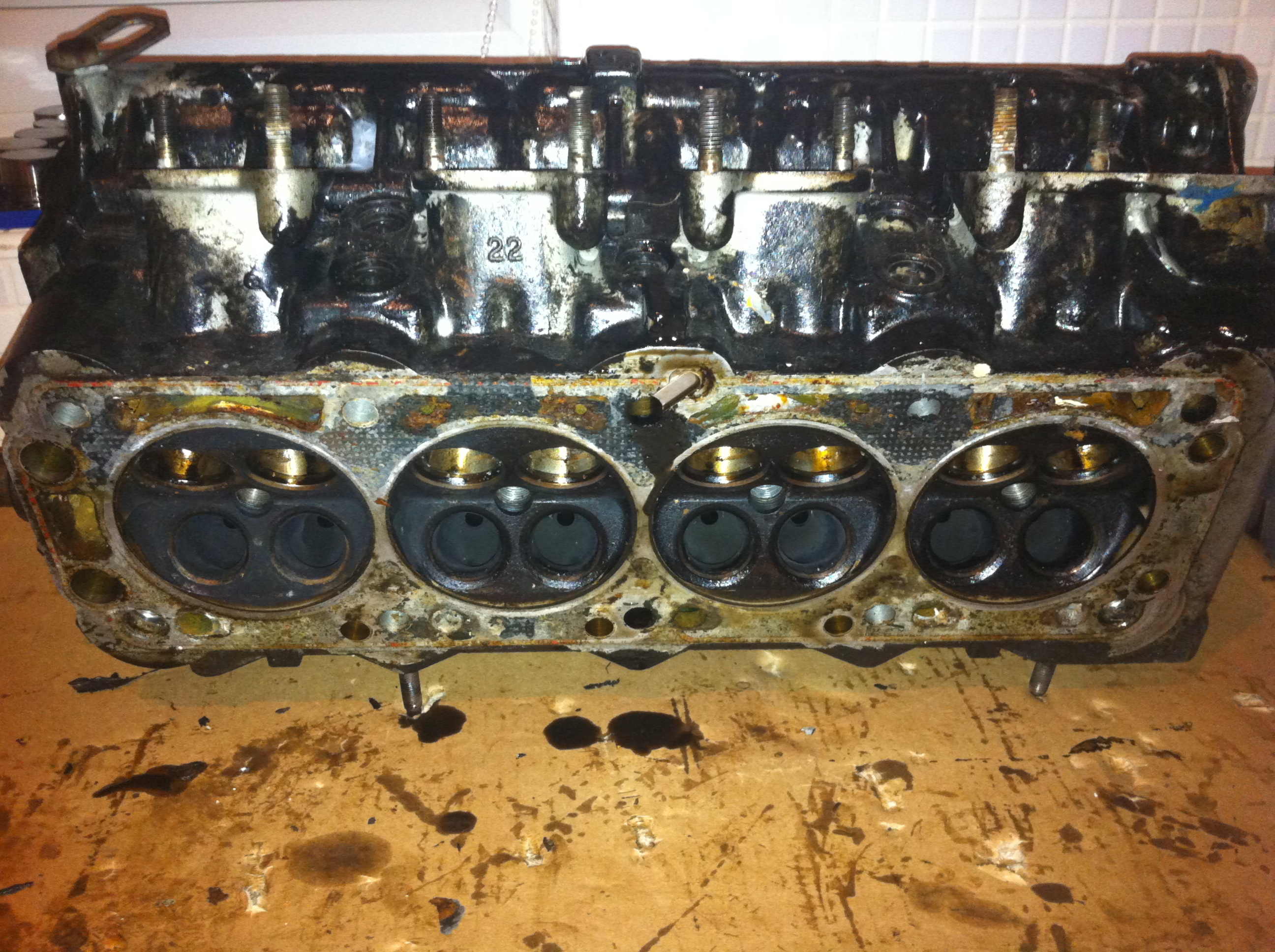

Well ive had a go at stripping down the 20xe... and was suprised with how good the engine is... I think it must have been rebuilt within the last 15k, as there are still hone marks, and not much wear on anything, i can even see the writing on the piston tops.. which is srange for these as they are normally covered in carbon... The only two issues i do have, first being some rust on the first bore, due to the valves being open, and the cracked inlet... after two years, its caused a bit of an issue... Nothing that the machine shop wont be able to sort out... The second issue is the head needs a helicoil of some sort on two of the spark plug threaded bits, again something annoying, yet something which can be sorted out...
All in all, im very pleased with it... I will still be fitting new rings, bearings, gaskets anyhow.. its just nice to know im not in a desperate need for an oversize rebore & piston expense...

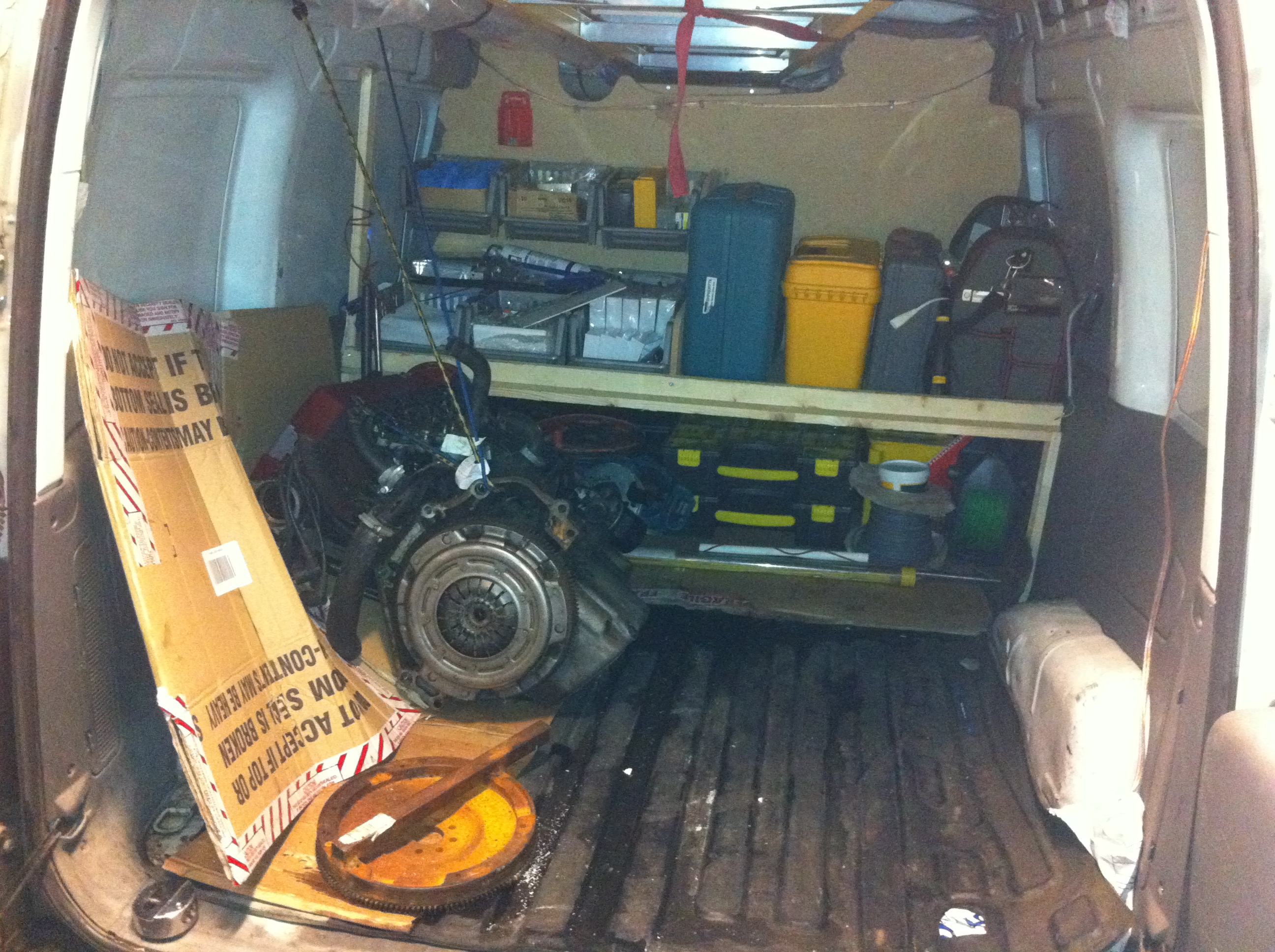

Just need to strip down the bottom half of the engine... i remembered id left my breaker bar around a friends house, so there was no chance in getting the bottom pully bolt off...

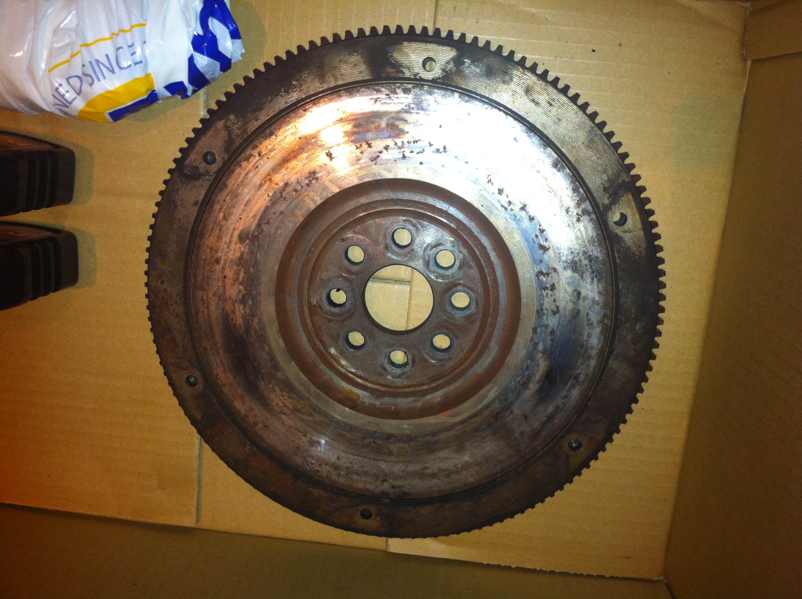

Also realised this engine is running a nice light weight flywheel and fairly new clutch combo..... :D:D:D

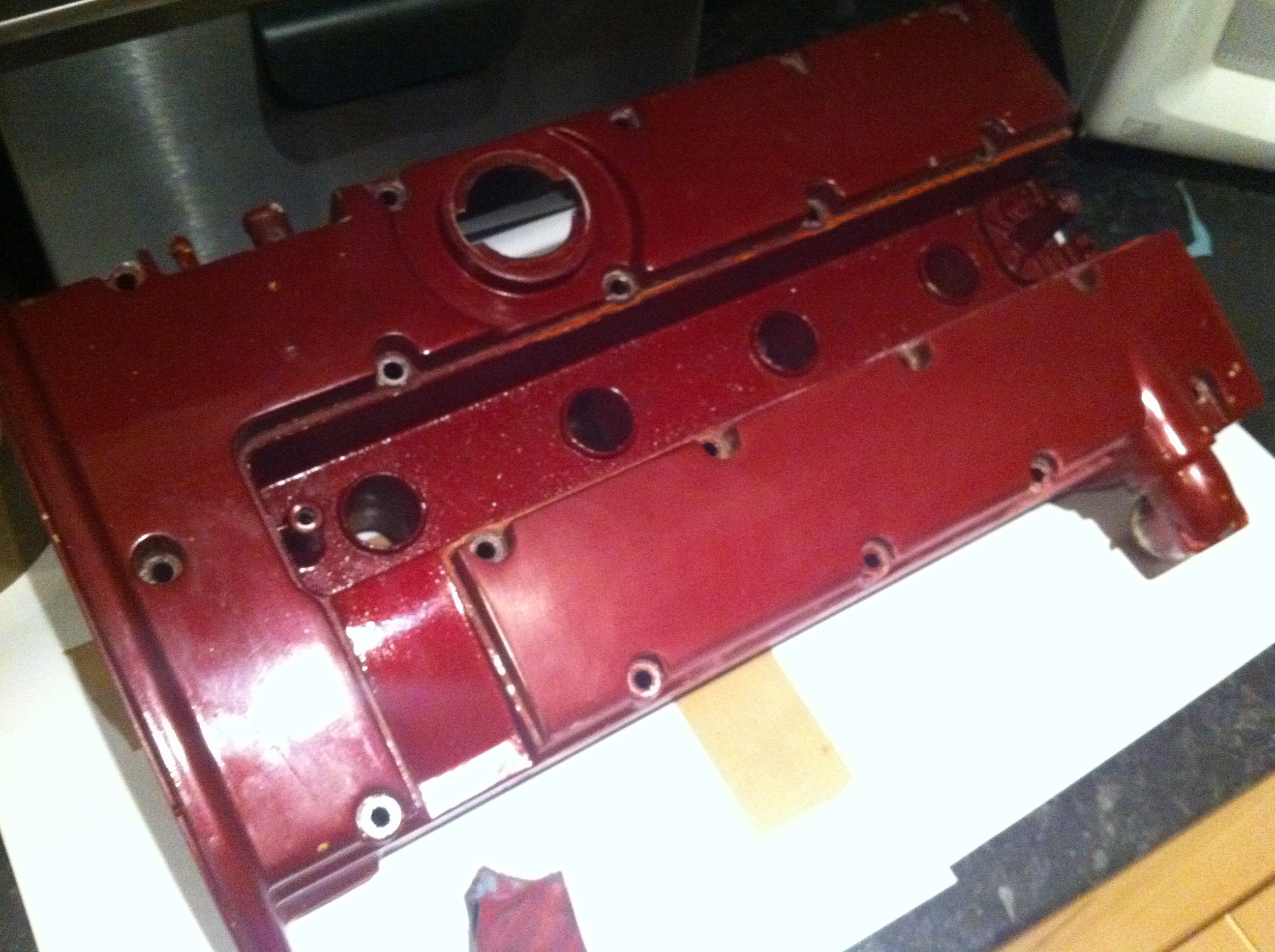

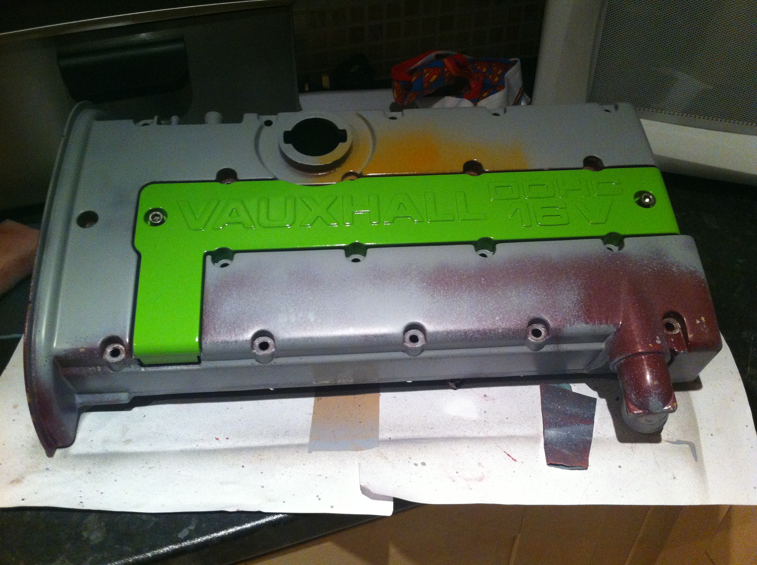

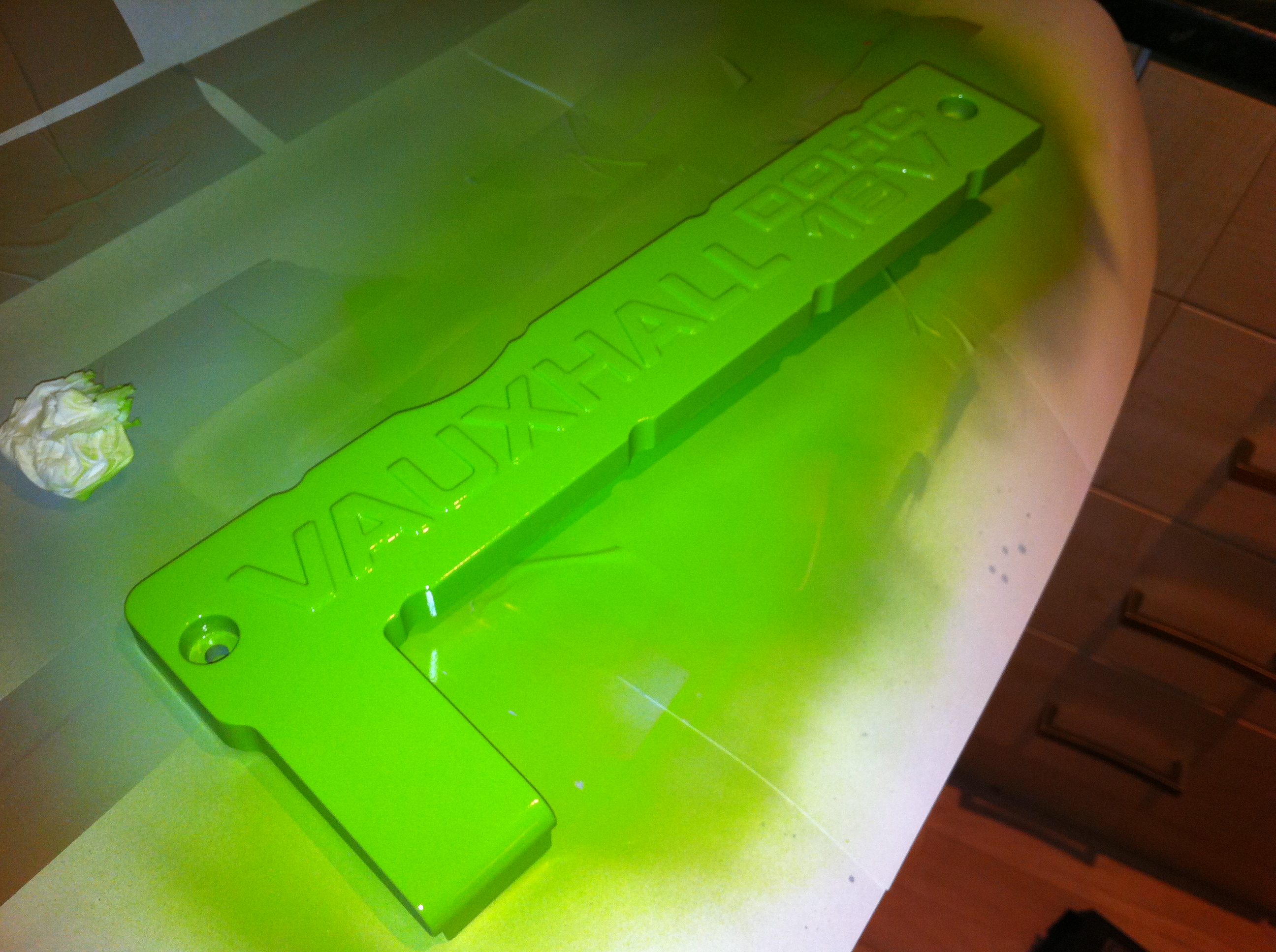

Ive started to smooth back the spark plug cover, as it was manky all over thanks to it being left in the rain since the car came off the road...
I done the usual sand it back, primer & paint... Its dried, however im not happy with the finish so im going to re-key it and give it another coat of green...
Ive also started on the cam cover... This has gone from the dark metallic red to a mix of colours haha.. It is going to be sprayed in a bright orange.. a colour i have used in the past, and it really stands out...

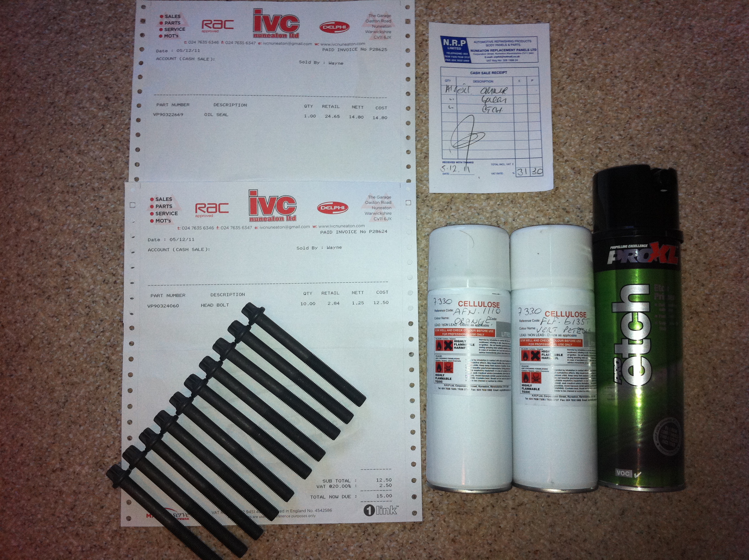

Bit gutted as the price for the primer and two cans came in at over £30, however its been custom mixed so i guess thats why it was soo bloody expensive...
The cambelt cover on the side will be done in the same colour as the spark plug cover... (the green)....

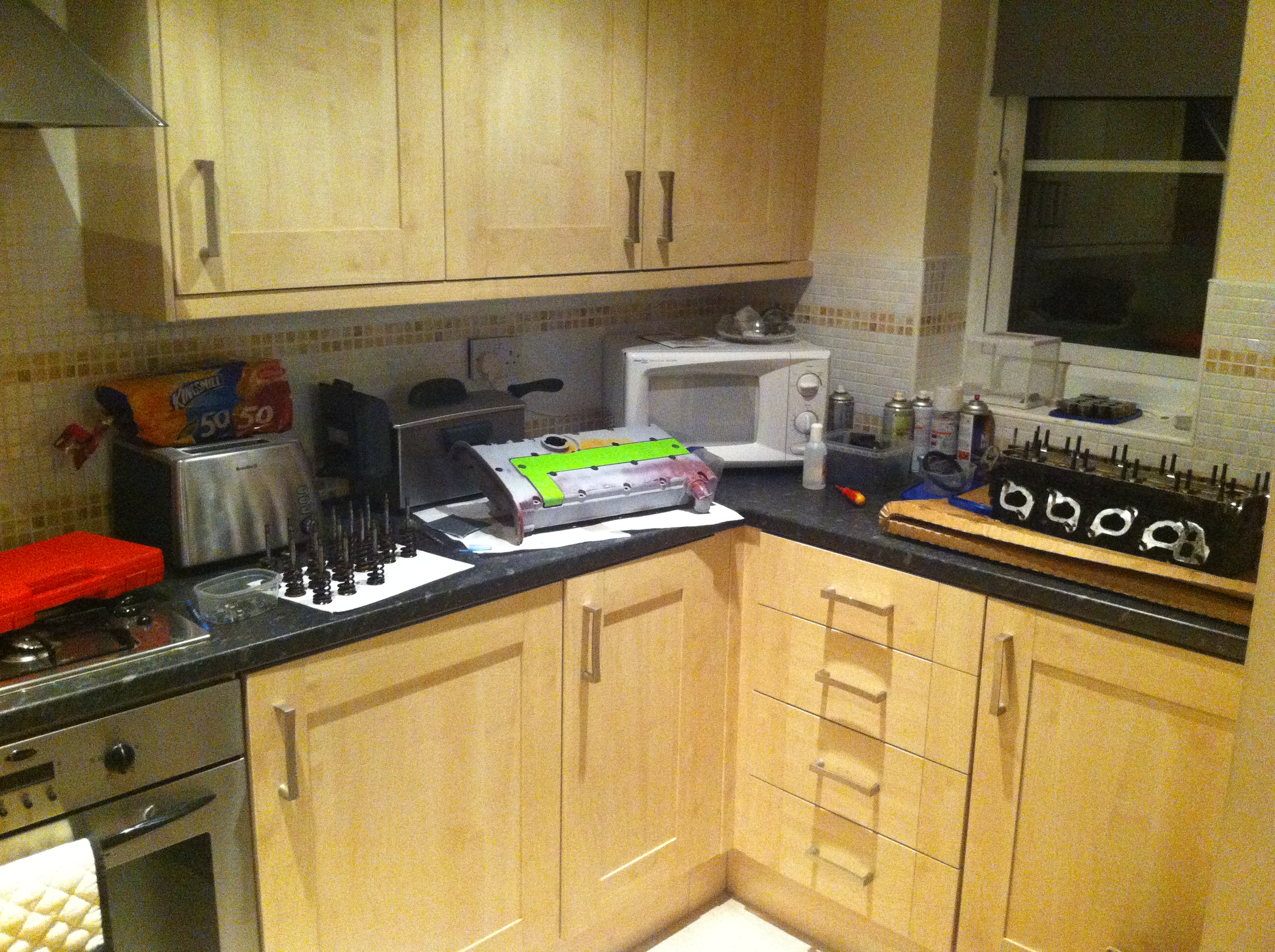

I then got bored with painting... to be honest it stinks, and the weather really aint that great.. so i carried on stripping the engine...
I quoted a large job for next week, so have now lost the storage in my van... so its time to get it all stripped, and the head & block down to the machine shop tomorrow out the van...
Plans for that are a hone... (i can still see hone marks on the bores, however im fitting new rings)... I will also have the head skimmed and two of the 4 plug holes helicoiled... Once thats all been done, both parts will be steam blasted clean meaning i can store the engine indoors...

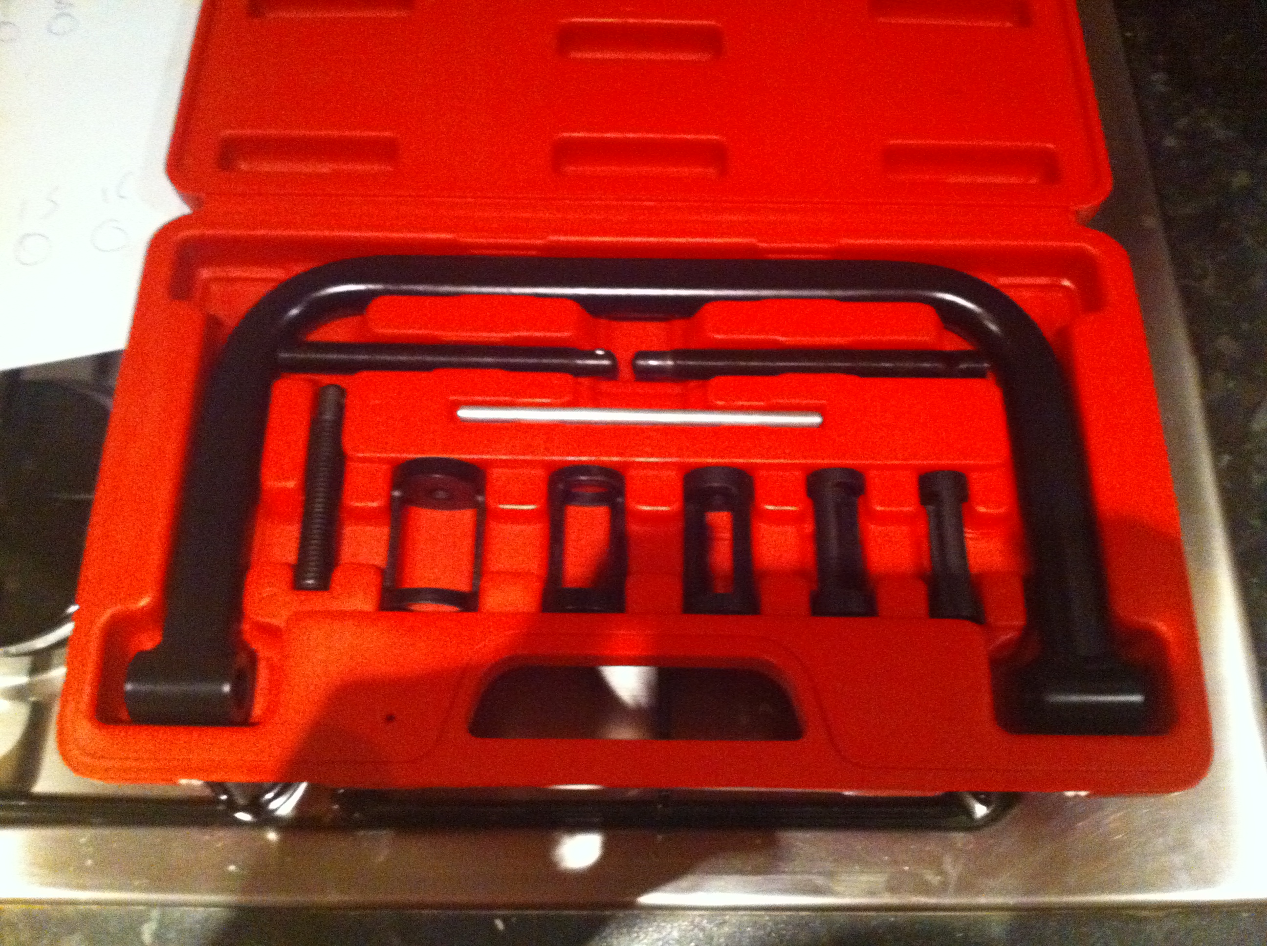

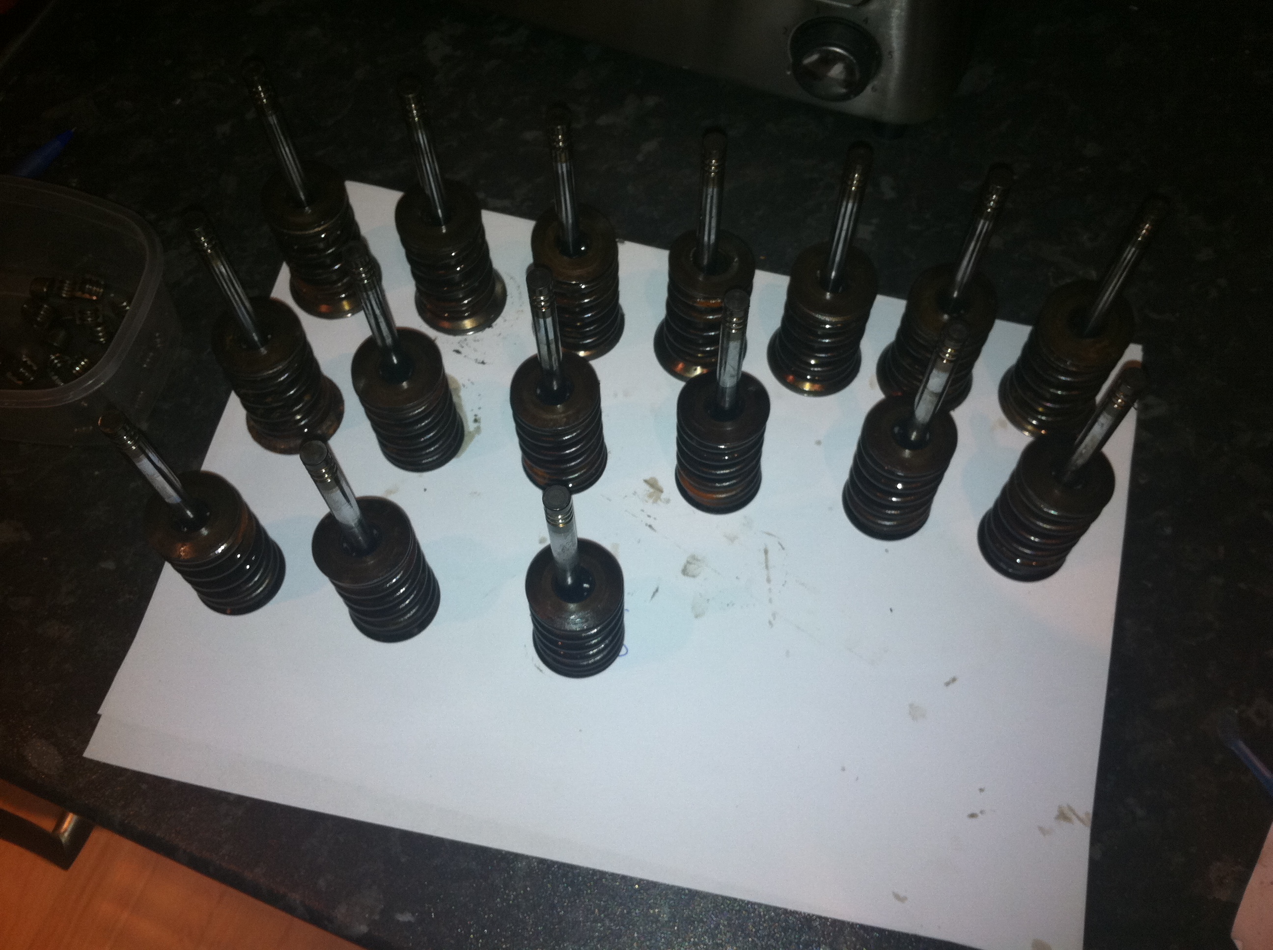

I made a start on the head... In real life it looks great, the pictures make it look rough as hell... Found a great tool on ebay, which i bought thinking it would be a big pile of poop... A cheapo' valve spring compressor!! Im used to the decent halfords one, however upon popping in halfords to buy one i was put off by the £50 price tag!! Anyway, £20 later on ebay, i ended up with this one... And i honestly prefer it over the dearer one!! Loads more room to get into the collets...
With the head stripped of the valves and the stem seals in the bin, its ready to be machined... There is loads of meat on the head, so il be getting a fair bit removed to get a bit more compression :D

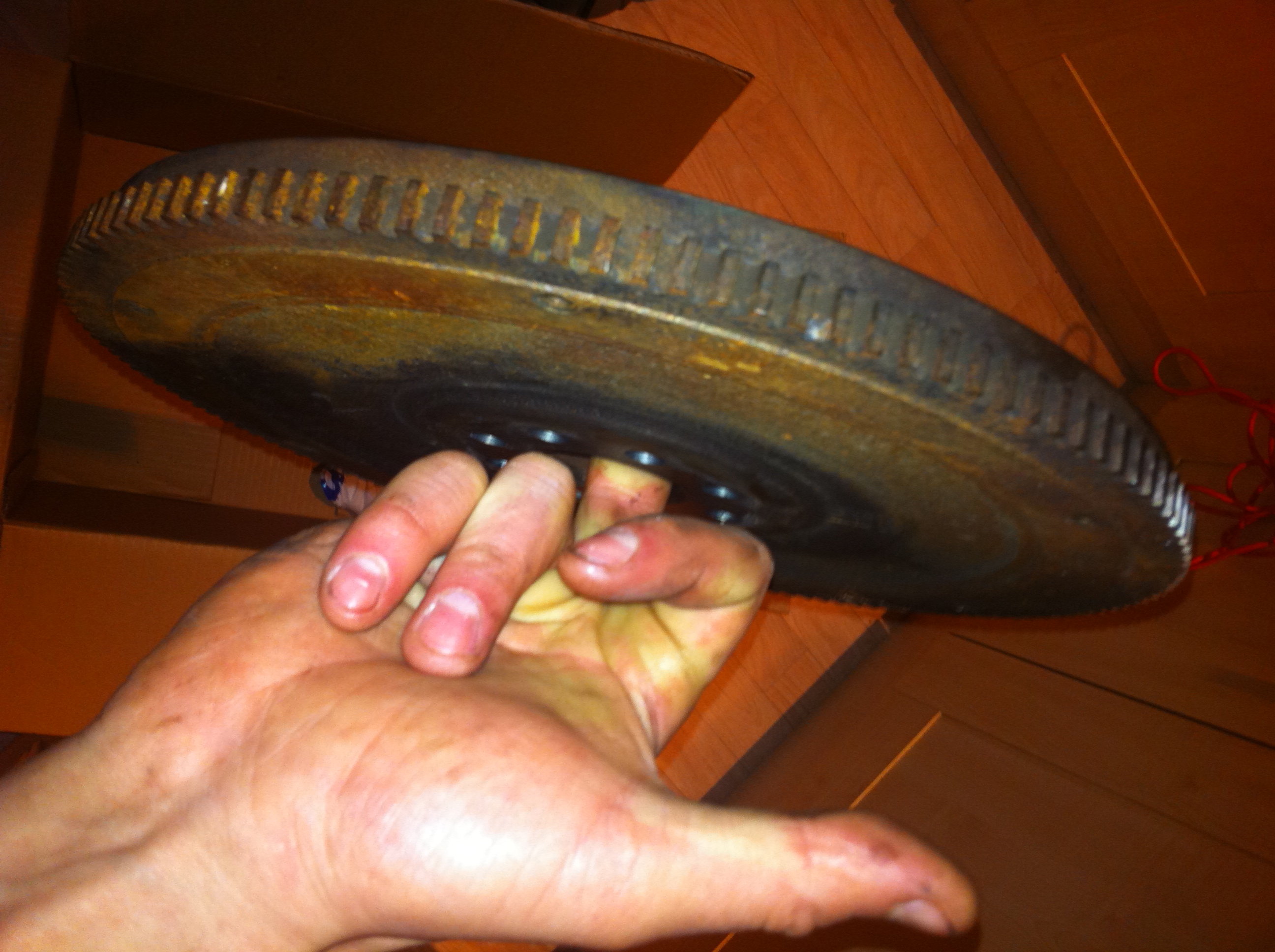

We looked at the flywheel.. and to be honest i forgot how lightened it was.. I can pick it up with one finger.. Glad that rotates on the passenger side, as i plan to raise the rev limit lol... Safe as you like :D

Hmm orange and green engine, hopefully it just looks like tic tacs and won't sound like them ;)
Lol its a vauxhall engine.. so i cant say it wont sound like tic tacs haha... they have crap tappets!! However ive just spent around £400 online for rebuild bits... so fingers crossed!!

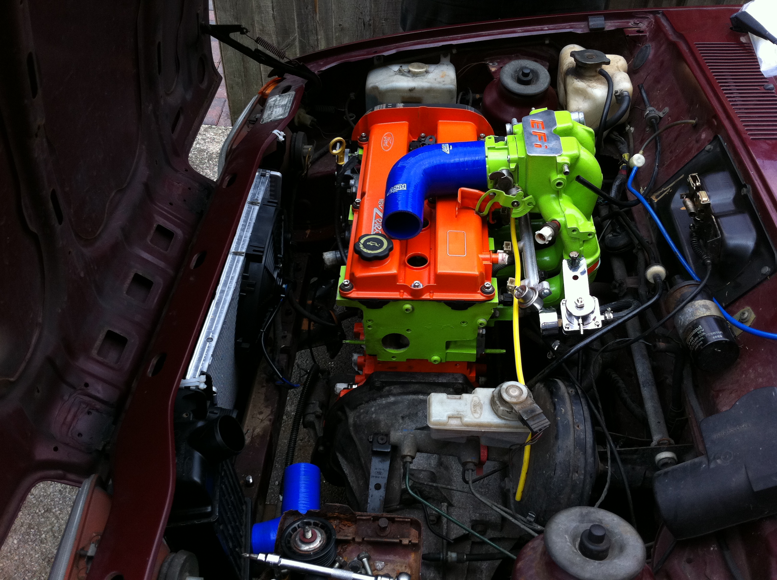

I used these colours in my 2.1 zetec turbo... loved the way it was crude... Really stands out.. especially in a standard car :p
