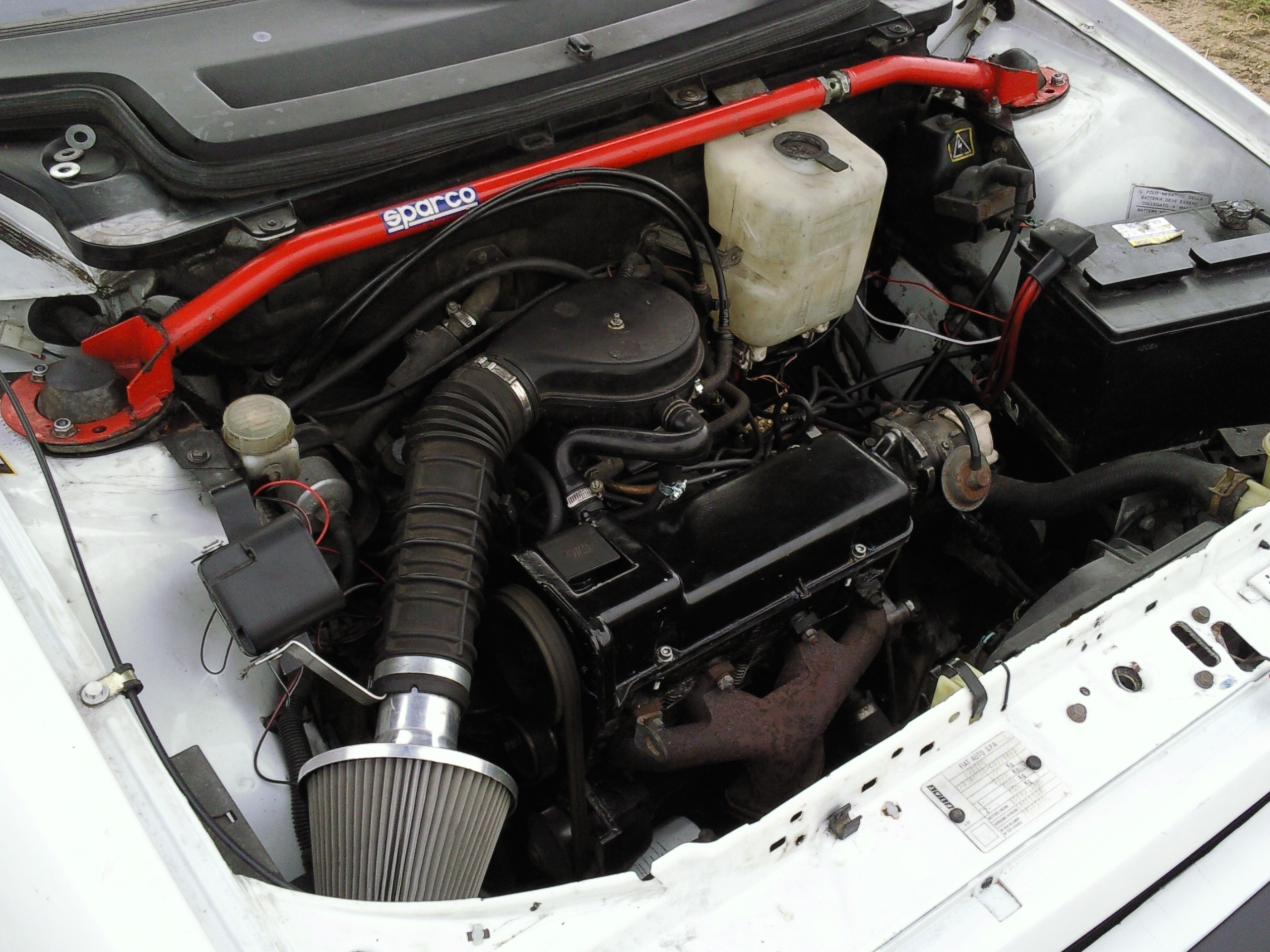

does anyone have any pics of a 1.0 with a induction kit on ?
Looks good and sounds good. Car went faster with original air box and filter though![]()
is this the only one you can get or can you get the one with the pipe coming from it
this is mine![]()
No idea. The K&N in the pic was second hand and was given to me for helping to fix another Uno. I whacked it on my 45S just to see what it was like. On cars such as 1.0 litre Unos an induction kit will do bugger all unless work is also done on the inlet and exhaust side to aid engine breathing. Plus the 1.0 camshaft is restrictive so that should be the first priority before worrying about air filters and such.

just get a intake off something else and do some handy work, i was 16 when i fitted mine so it cant be that difficult..
scroll up![]()
i have didnt see anything where he told us he got it from
the intake is from like a marea/bravo/brava or something lol
i took out the 3 holes for fixing and smoothed over and drilled central hole
but the tripod sort of bracket on the throttle body will need to be shortened lol
