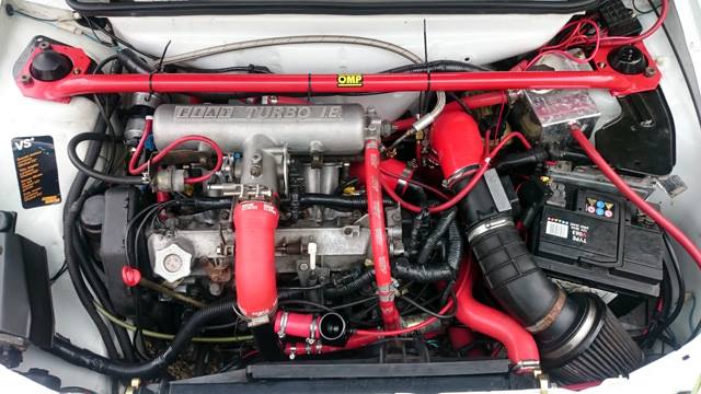

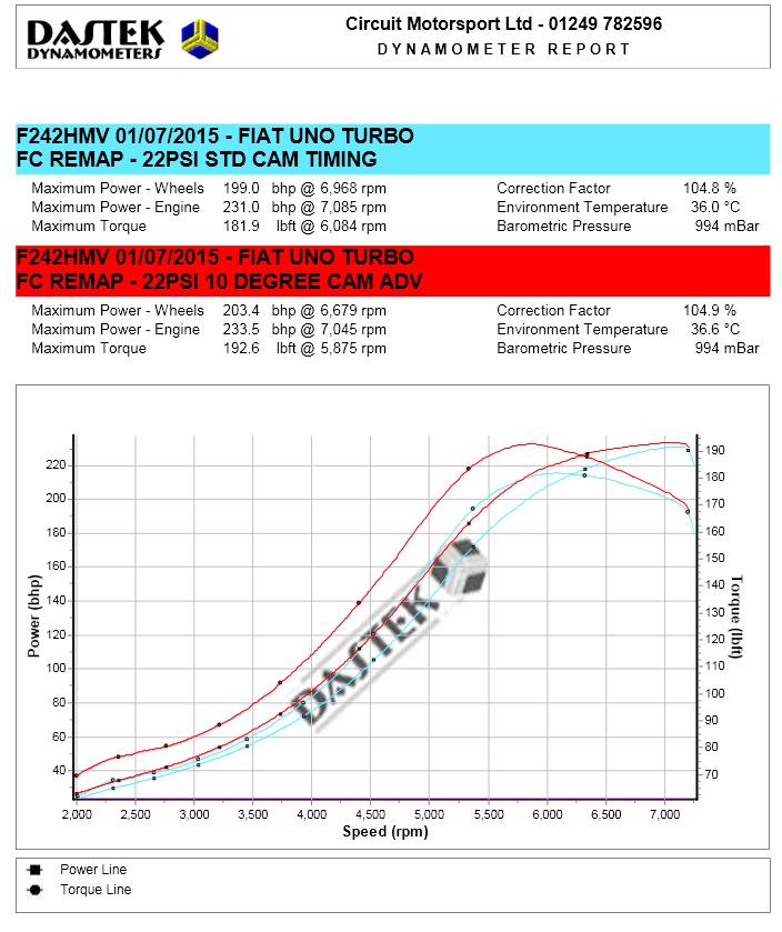

Had my mk1 uno turbo mapped by FC Performance in Bristol,
spec is
1.3 bottom end standard
1.3 head standard
piper 270 cam and vernier pulley dialled in by fcp
cann durrant ported and enlarged throttle butterfly inlet manifold
garrett gt2554r turbo
dr evil elbow,
custom stainless down pipe and exhaust
cosworth K&N air filter
Pace intercooler
330cc injectors, genuine walbro 255lph pump
punto gt1 ecu

trying to get my head around the max. powers being at different engine RPM's,
crank VS wheels :confused:
