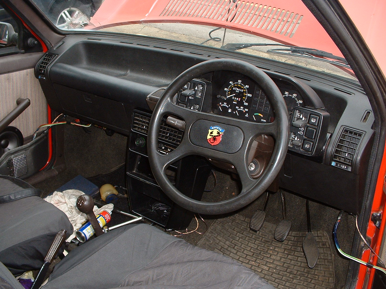

Well, this was a job I wasn't looking forward to. Swapping over my chocolate brown dashboard for the nice black SX dashboard with centre console, plus plumbing in the wiring to run electric windows (from a turbo) and front fog lights (from an SX).
I wanted to make the wiring loom look factory standard, so no Scotchlocks or crimp on connectors allowed!
I had to pull out the big plastic grommet that feeds the loom into the engine bay so I could add extra wires, then add the new power lead and also the wires for the fogs.
I ended up using the under dash wiring loom that came with the SX dashboard, and swapped that over with the 45S standard loom, then reconnected it all to the back of the fuse box.
Everything worked, except that the light switch now put on main beam when I selected parking lights! After some headscratching and another look at the wiring diagram I found that post 87 models had a dim/ dip system that wasn't compatible with my loom. So I've now got to pull it all out again, refit the 45S loom and add the fog light wiring and relay. That will keep me busy at the weekend...
Attached is a pic of my car less dashboard! It's all back together now, minus the stereo. But as mentioned I've got to do it all again. Bugger.

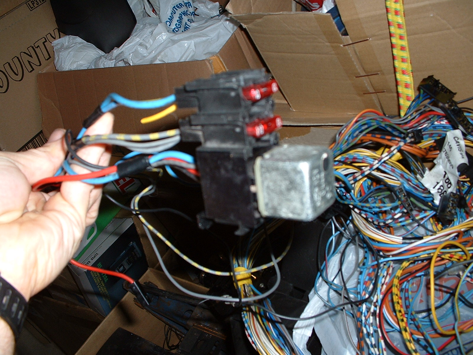

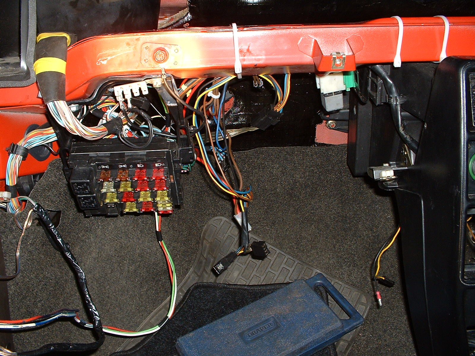

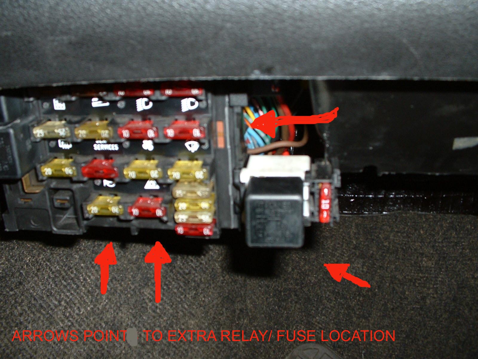

You also mentioned about the 'four place fuse box' for the dim/ dip light system. It's a seperate loom from the fuse box, and is clipped to the side of the fuse box with a relay almost as an after thought.
The attached picture shows what it looks like, plus also what the fog light relay and fuse looks like tacked onto the fusebox. The dim/ dip four place fuse box with relay is attached the same way, but has now been removed from my car.

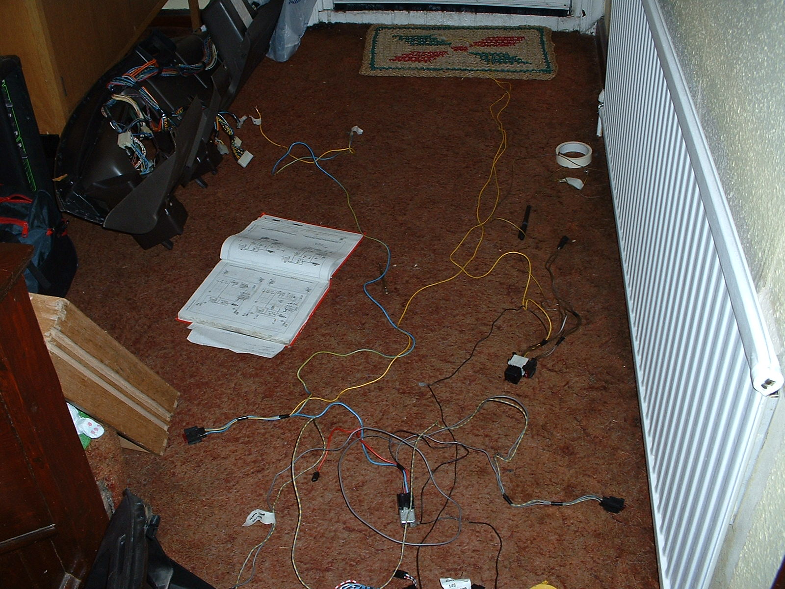

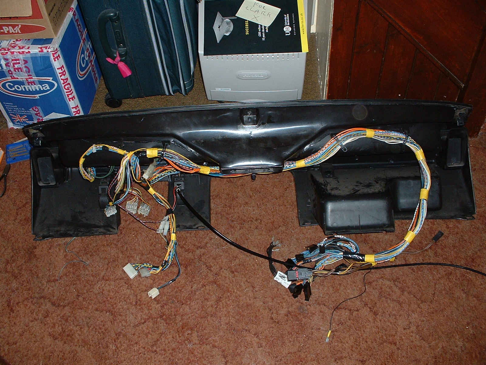

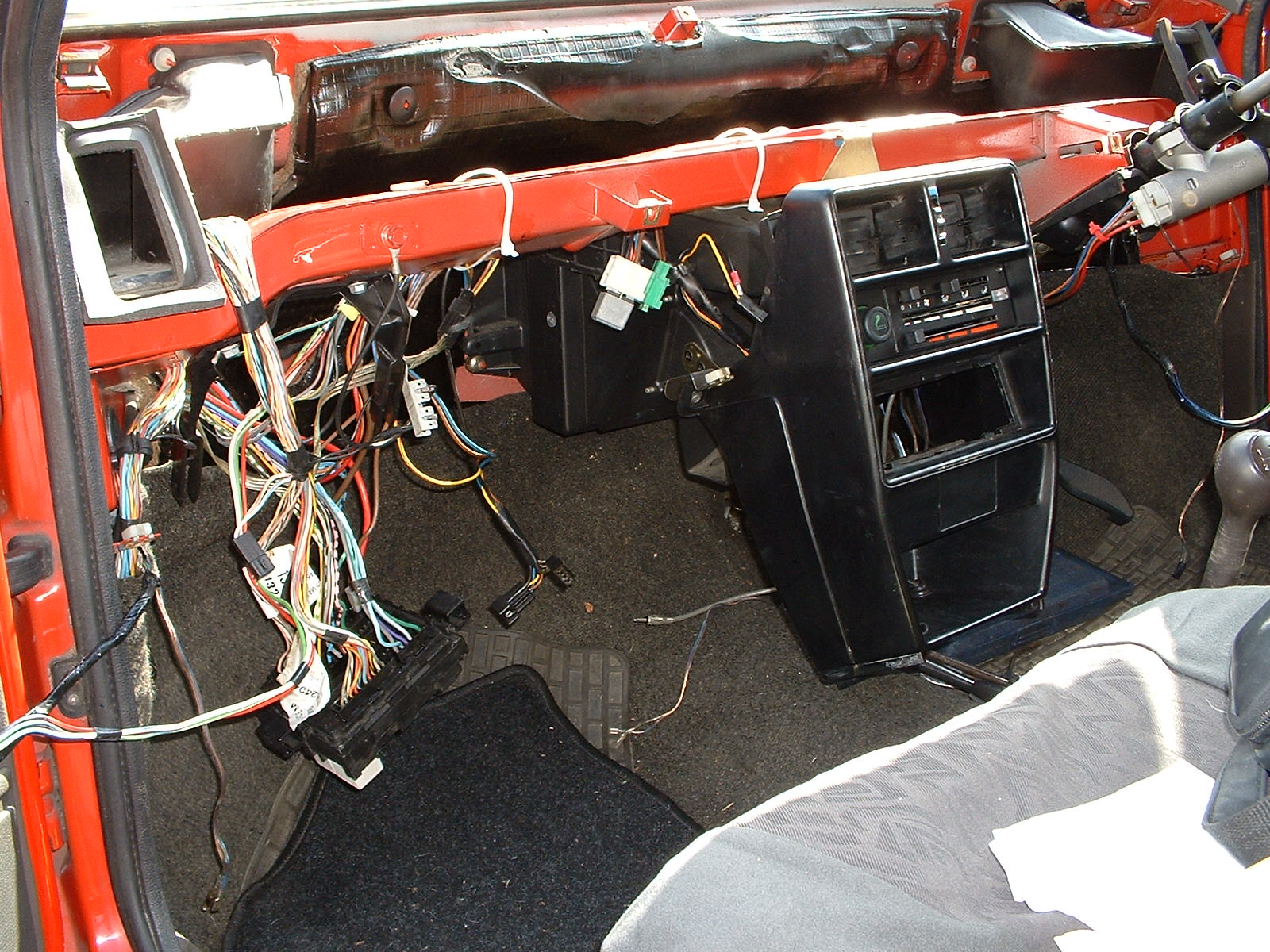

Round two of my dashboard removal was fairly painless as I knew what to do having only done it a week or so previously.
This time I pulled out the SX underdash loom and refitted my original 45S loom. Using the Haynes wiring diagram I then removed the fog light loom and relay, and transplanted this into the 45S loom. This was rather painstaking as I had to unravel the wiring loom and pull out all the wires that were needed, and in some cases cut them when they joined a shared connector.
What took most of the time was fitting some of these wires into the original 45 S connectors. I didn't want to use Scotchlocks, crimp on connectors or anything like that, so I carefully opened out the pin clamps that were crimped onto the original 45 S wires. This then enabled me to fit two wires into one pin (like in the SX loom), then crimp the connector back together. Installed into the plastic connecting blocks it now looks factory standard. Took bloody ages though!
Then I taped up the loom and refitted it to the back of the black SX dashboard. Put it back into the car, screwed it back into place, connected it up to the fuse box and.... Phew! It all works this time, parking lights and fog lights included. I even got the fog lights warning light to work on the dash panel too. I'm glad that I've got all that done and out of the way.
I've attached a few pics so everyone can see what is involved. Note in one pic where the wiring loom comes over the beam on the left to the fusebox. It was like that from new, and I wasn't too happy at the way the wires were rubbing on a bit of metal! So I cut up an old motorcycle inner tube and wrapped it round the loom where it came over the beam and was now protected. You can see this taped up in yellow masking tape.
Anyone else contemplating doing this, it is quite easy but takes time. Just make sure you set aside at least a day to do a job as comprehensive as this.
Lastly, in the pic with the dashboard all back in place you can see wiring coming out of the side of the dashboard going into the door tidy pockets. This is the electric window wiring that I've yet to feed through the door post and into the door itself. I'll get round to doing that sooner or later!
