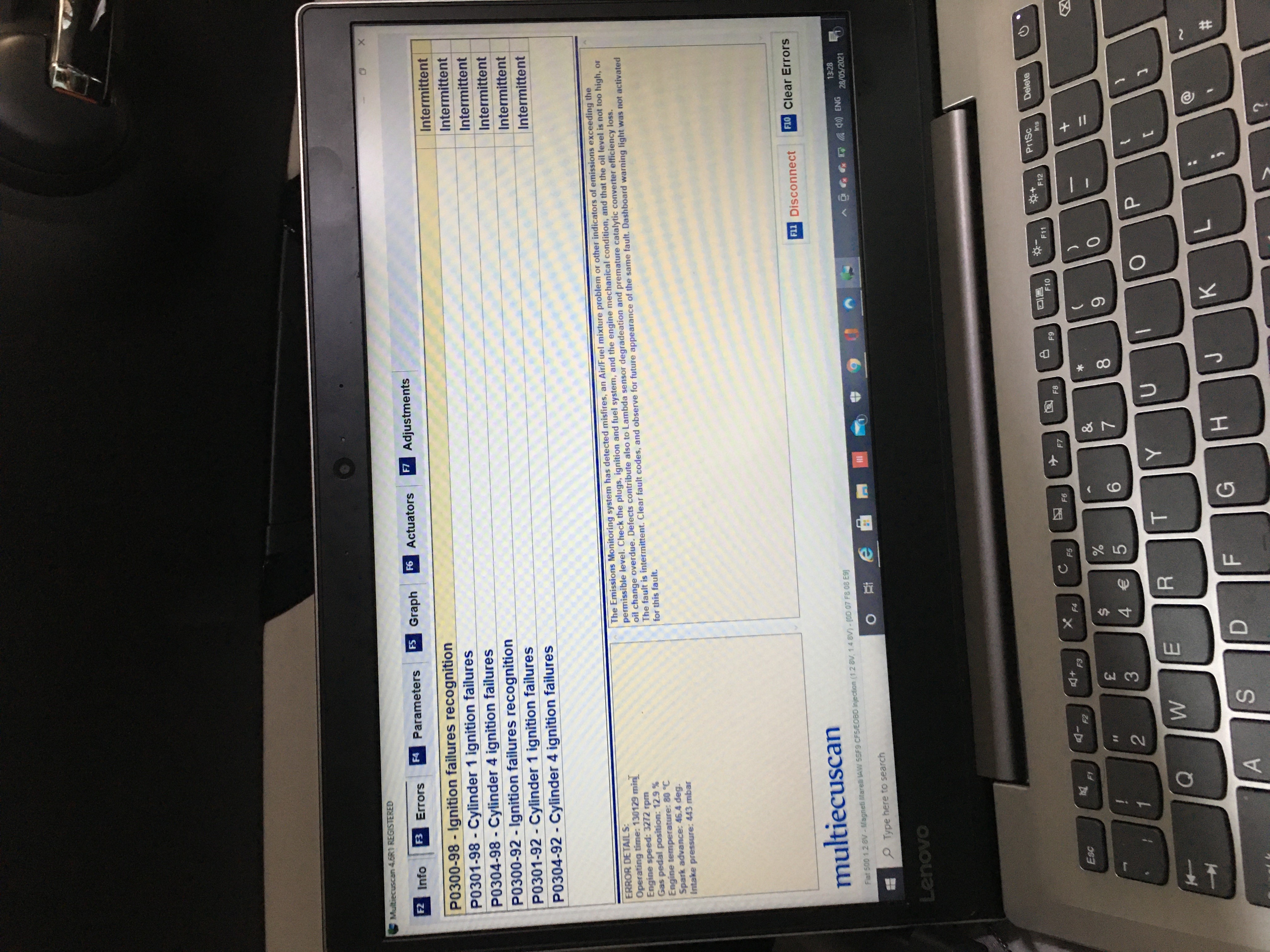

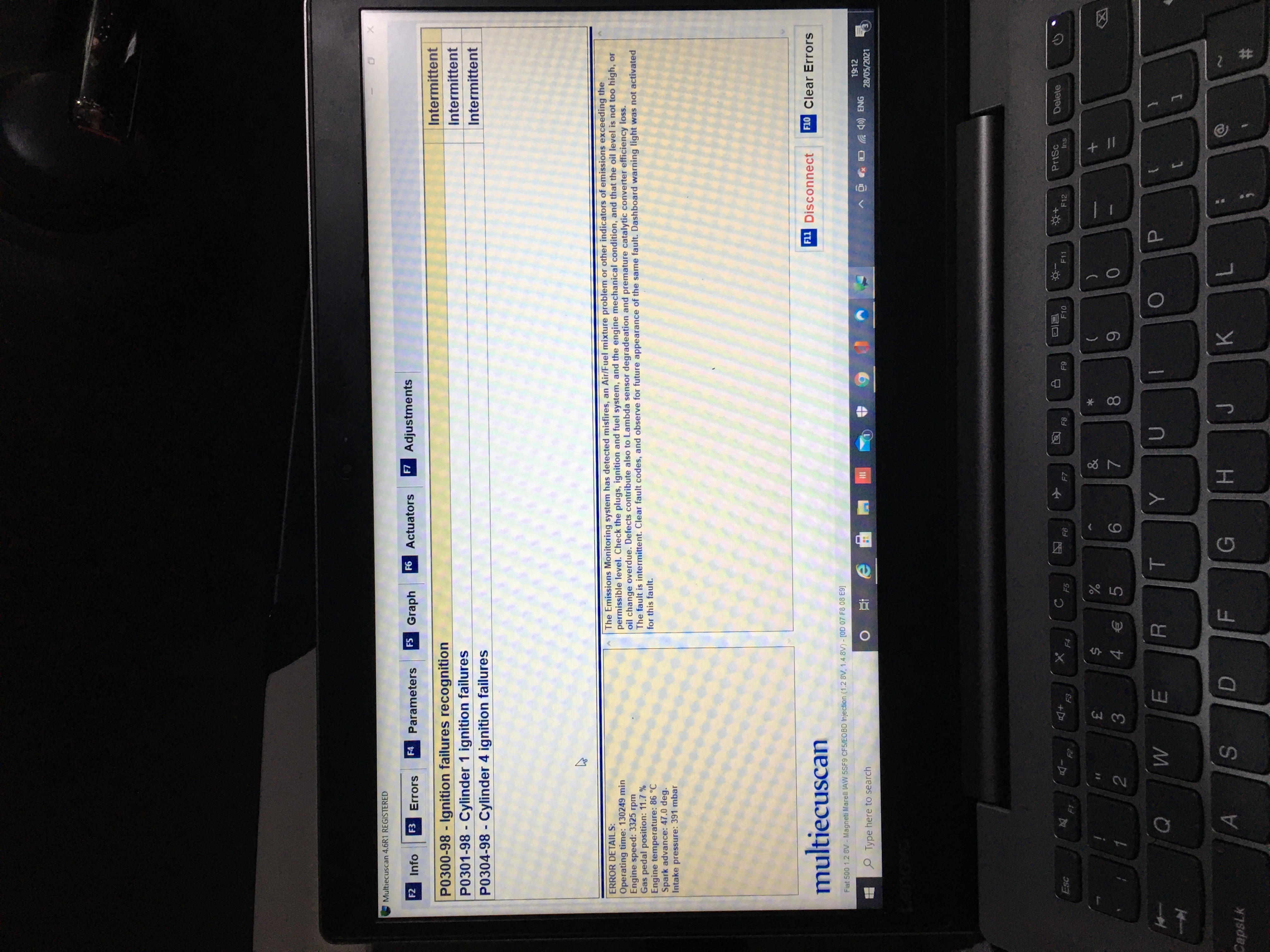

was on the m way this morning when I got ss unavailable when I got home I read various po codes on mes
I cleared them as intermittent changed the sparks coil pack and leads
just been for a spin down the mway again got ss unavailable and engine light for 10 secs then it went off
got back and again intermittent po codes just not as many?
ive added pics hopefully they upload all ive done this week is change the crankshaft pulley, im wondering what the hell ive done!? could it be down to my new exhaust? any help please chaps

Hi,
Does your crank position sensor generate signal from bumps on crank pulley?
On older models of 1.2 fire engine any time the crank position sensor or crank pulley were disturbed a phonic wheel relearn was required(phonic wheel=crank pulley)
I'm thinking misfire is related to replacement of crank pulley. Don't throw away old crank pulley just yet.
Check crank sensor too , maybe it was knocked/disturbed.
Best wishes
Jack
