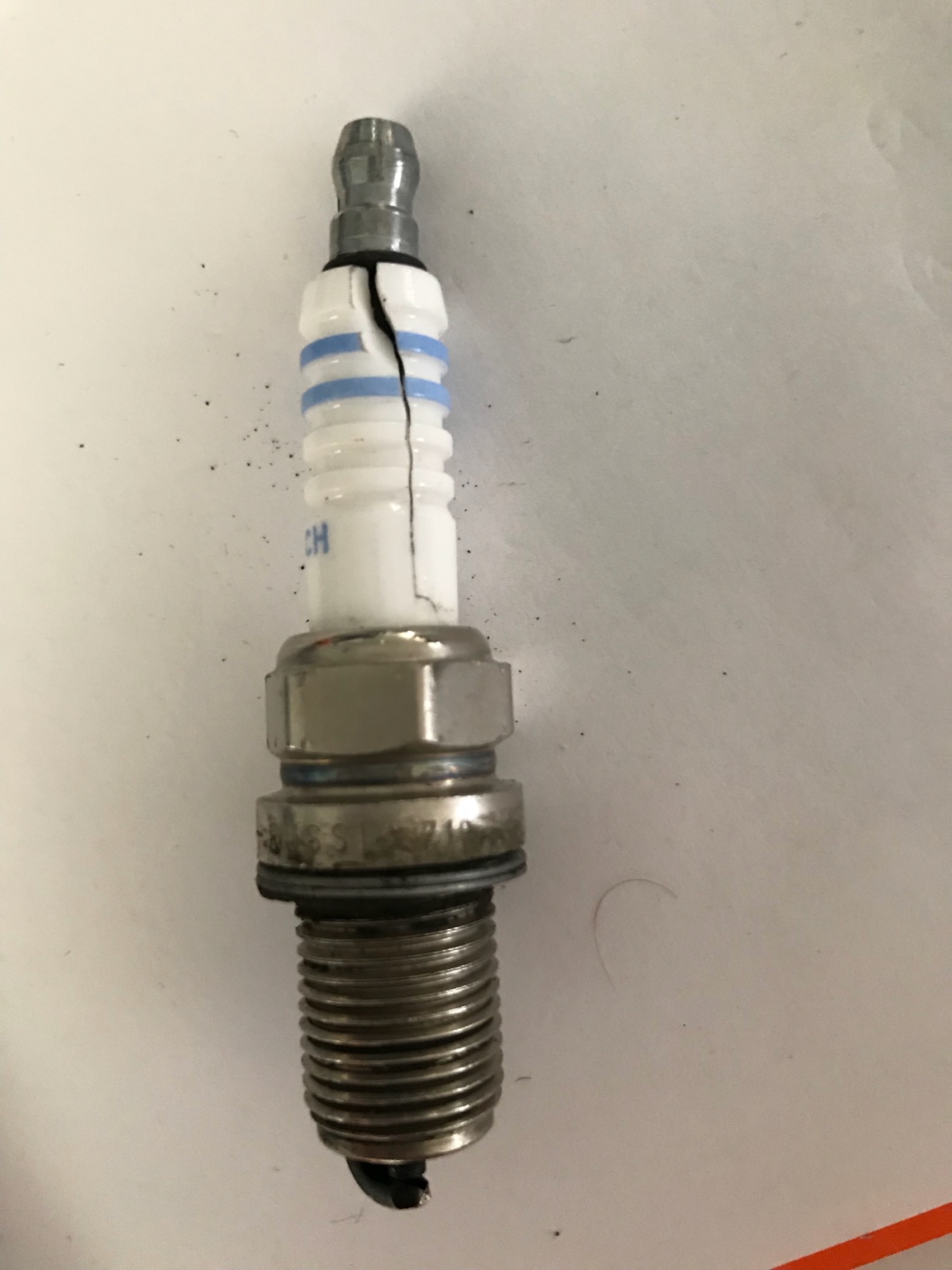

Replaced the vacuum advance unit and still no luck. Engine runs a bit better but is still rough. What I’ve noticed though is that the ceramic part of some of the spark plugs is cracked. Could this be the problem?
Yes that will defiantly cause a problem. Your first post said it had new spark plugs- you now need another new set and fit them carefully. Do not over tighten spark plugs.
Not the ceramic on the nose but the insulator on the outside. You think thats the problem?
hmm it could be, it may mean that the spark plug inside may be very low resistance. on ebay, if you type in the number on the side of the spark plug you should be able to get one single plug to replace it. or for testing, just use one of the old plugs if you have it.
That plug is one of the worst I have ever seen and should be discarded straight away.
Get 4 new spark plugs .
As previously said.

Update: so i replaced all 4 plugs and the engine is running much better now. It still has the idle a little rough. What else could it be? Could it be the mixture screw? Its got a small blow in the exhaust from what I’ve noticed. Thanks
