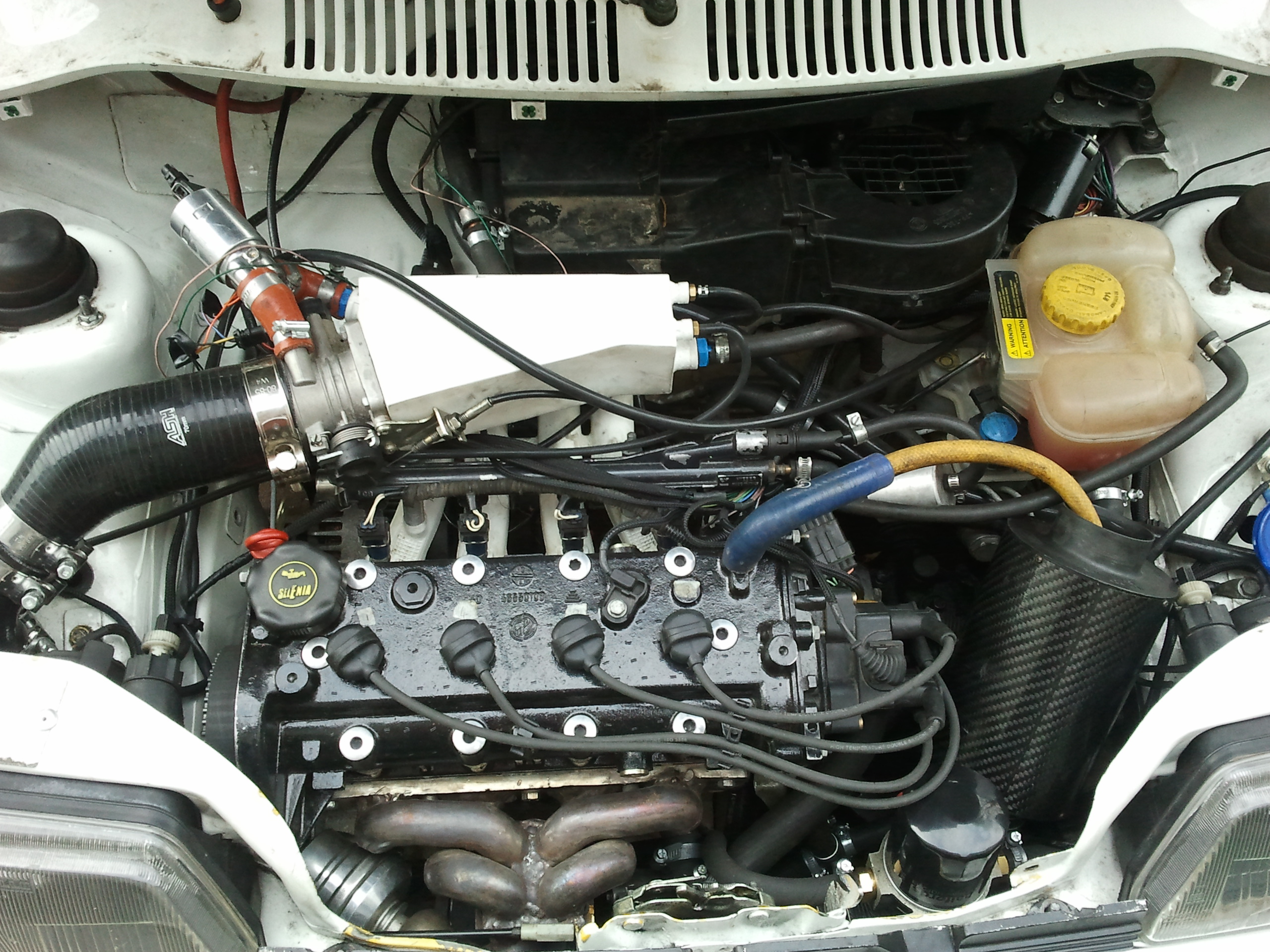

And you get cam signal from where? New 8V or 16V block with sensor on top, or mod?
new 8v and 16v have them built into the head.
you can see mine between 3 - 4
