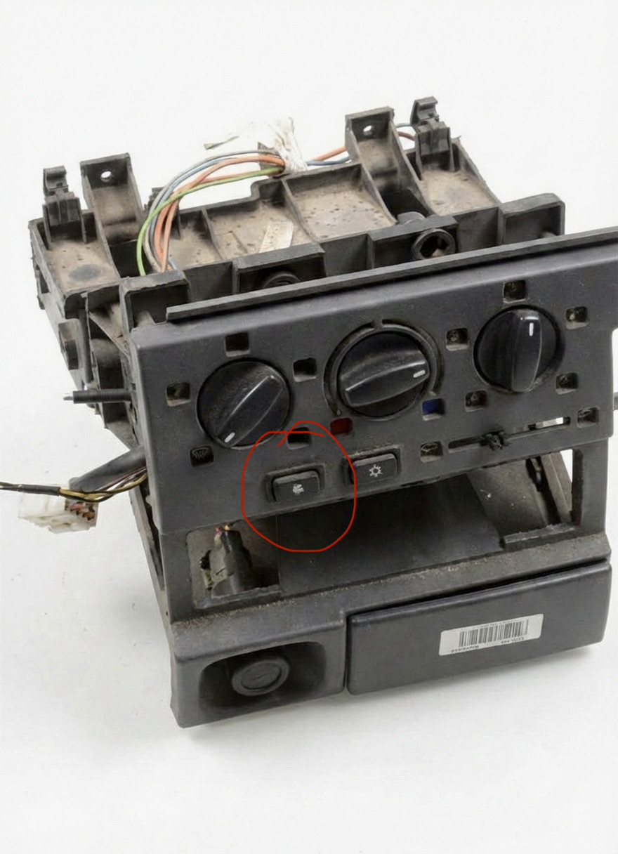

I believe the heater in the rear was related to minibuses the switch is a tiny rectangular one positioned under the three heater control knobs and next to the slider for air recirculation. I have circled it on the attachment. However, on mine it’s where the air conditioning button is as mine doesn’t have air con. I suppose we can do without it as there are just the two of us travelling at any time ( in the front) and the forced air system is used from the gas fired boiler when we are parked. It did work when we got the van.

Right , well that position is a real pain , obviously that's an original Fiat part . There is actually space for three switches in that location , though you're need to remove the cover panel to view them , but then that's also another story . I have to admit i wondered what other switches fitted in there , i already knew about the aircon . Now i seem to recall you said the switch had fallen apart , so i'm guessing that picture is not of your van . Ah missed that , no it's not your van .
Okay , so what are your options ?
Well you have two , and the first one is a breakers yard . Your chances i'm afraid are pretty low , as i was on a hunt for an aircon switch with no luck myself , a little while back . You've got no chance of ordering one from Fiat , and Coastal have never listed any switches for that location , my guess is , stock has long since been depleted . Trim is normally the first thing to go .
Now with that said , i did manage to locate an original fuse block for my van , again another stock long since depleted item , from a breaker in Lithuania , it did take three years , but it can be done . So all is not lost , as they say .
Your second option , is to follow the route i eventually went , think outside the box , and fit a different switch . I wanted a 2 speed , three position switch to control an electric cooling fan mounted on the dashboard . Now in my case i used a low amperage unit because i knew the fan , even on second speed was low consumption . I fitted a miniature on/off/on switch capably of handling , i think about 6amps (but it's fused to 3) in that location instead . The dash did need some adjustment , but as i was already doing some quite extensive custom work (fitting a full double din media centre) with the dash anyway , i was okay with that . I'm really chuffed with the finished overall result , but before you even consider this as an option you really do have to figure out the power requirement a new switch would have to cope with . But to make this clear , you probably will need to ream the original hole slightly , i didn't have a hole at all .
