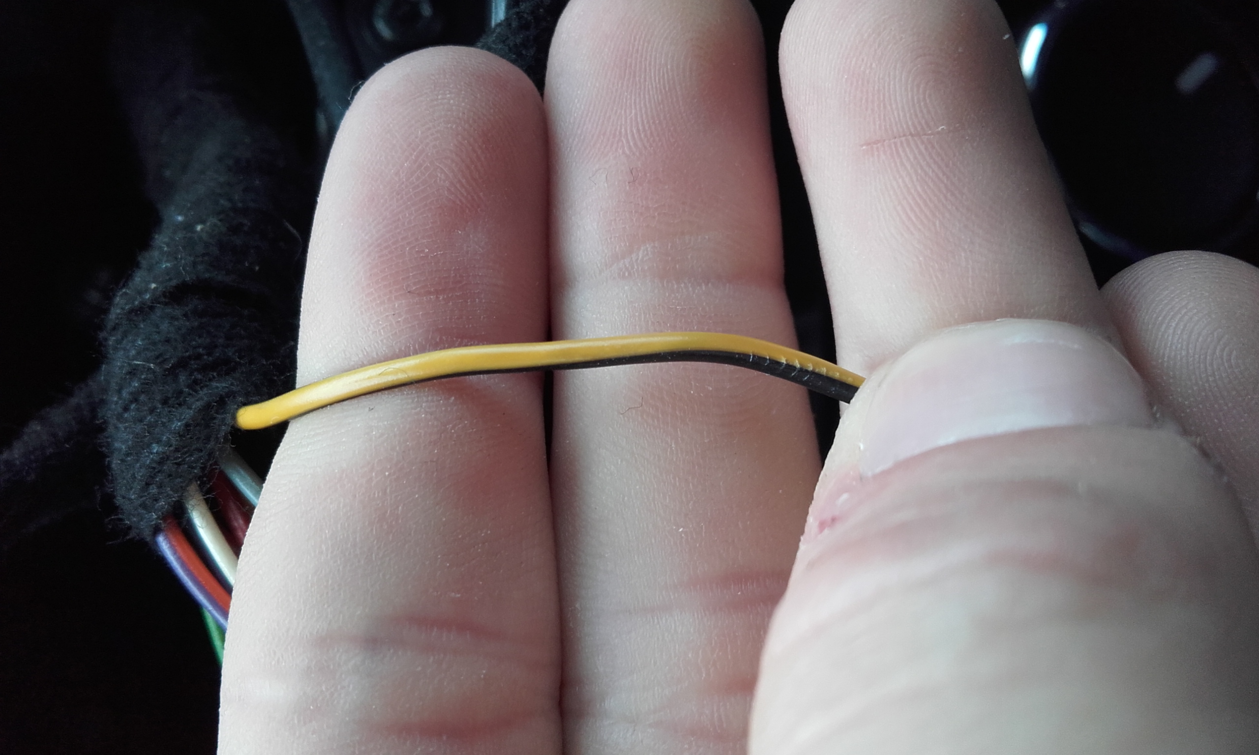

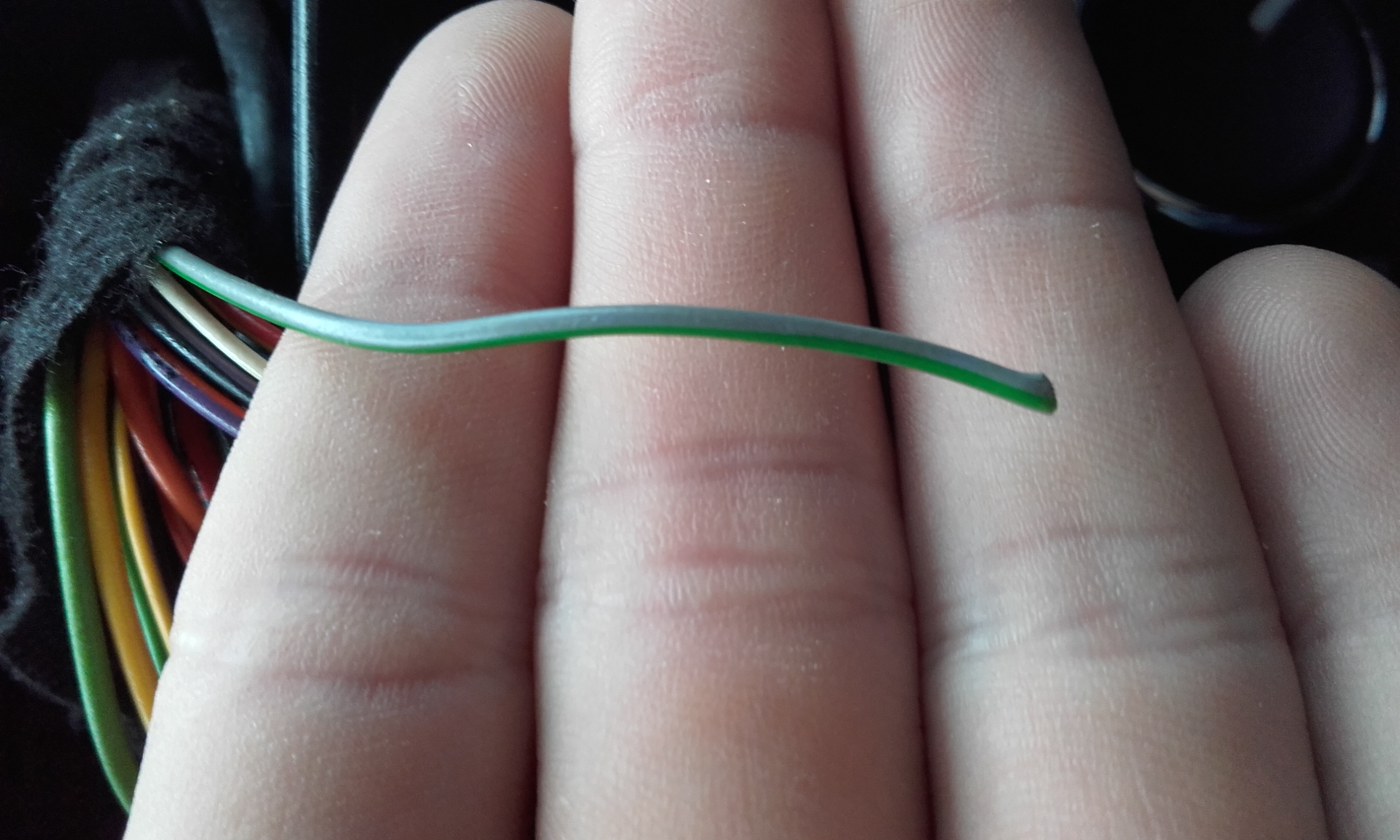

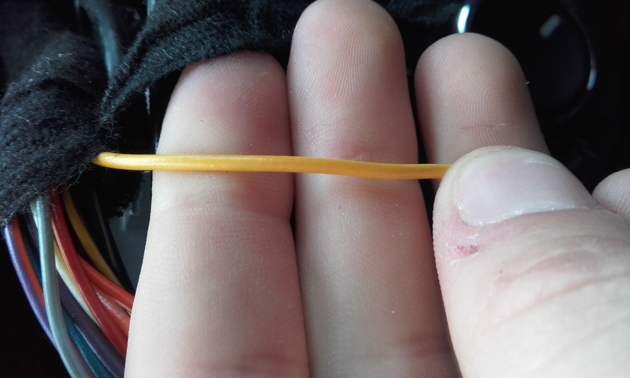

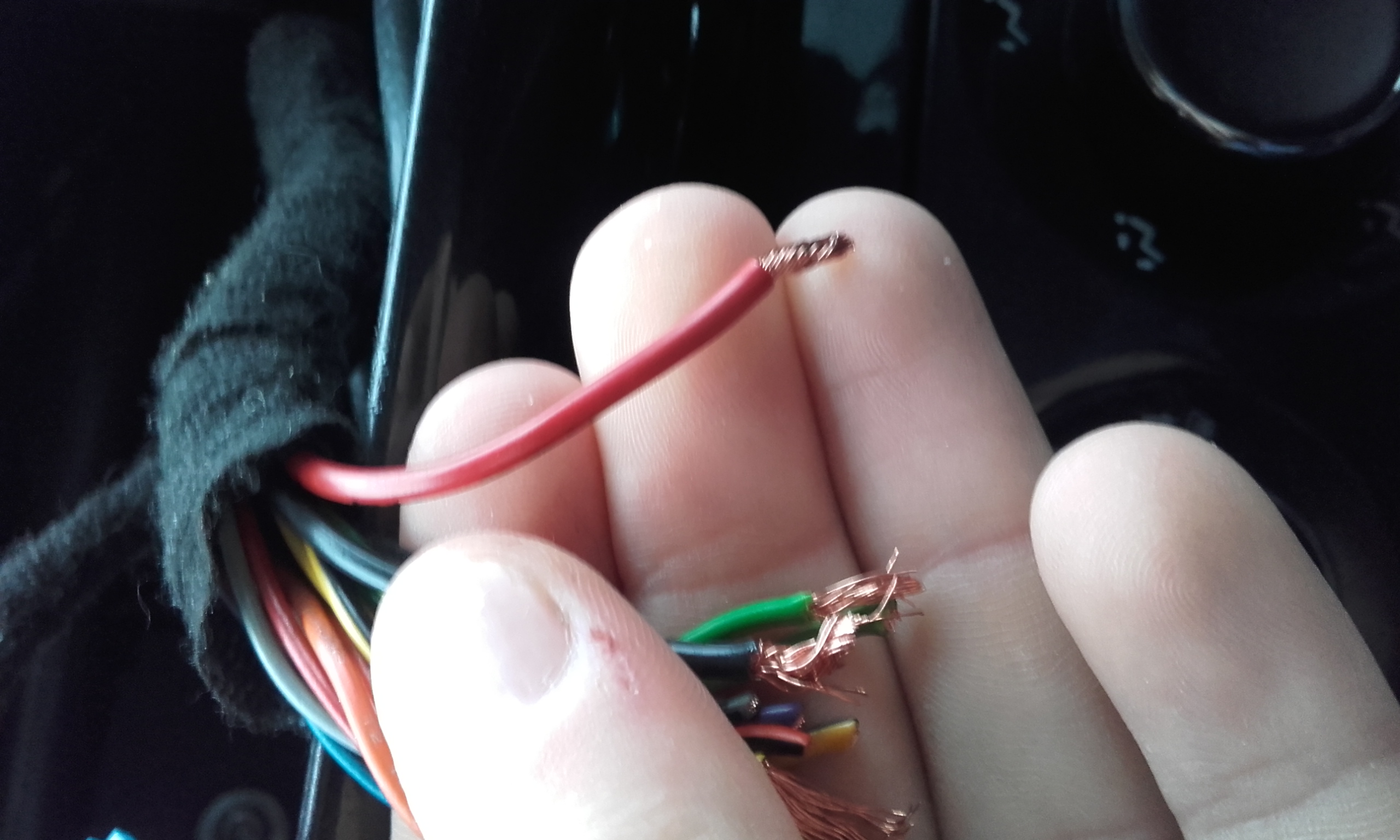

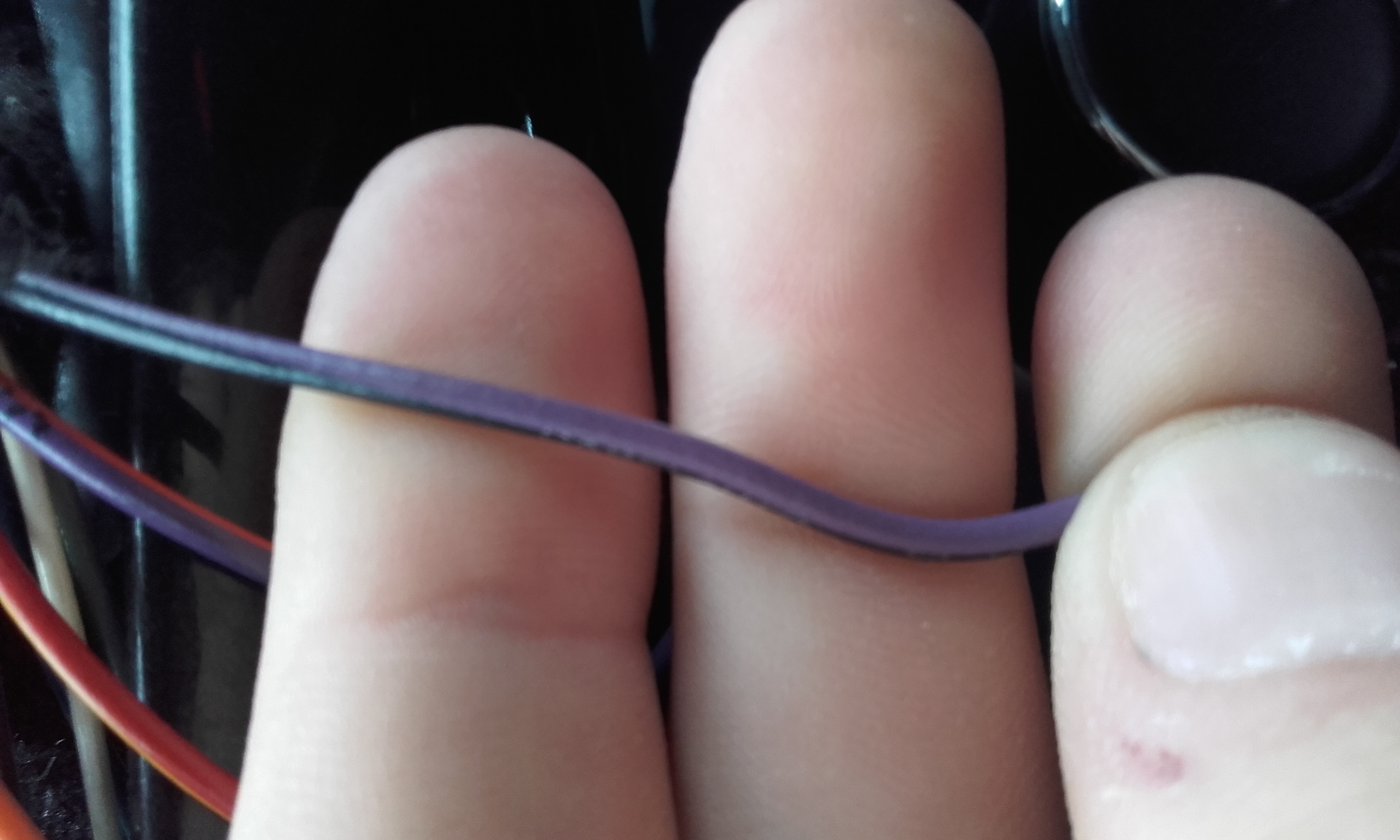

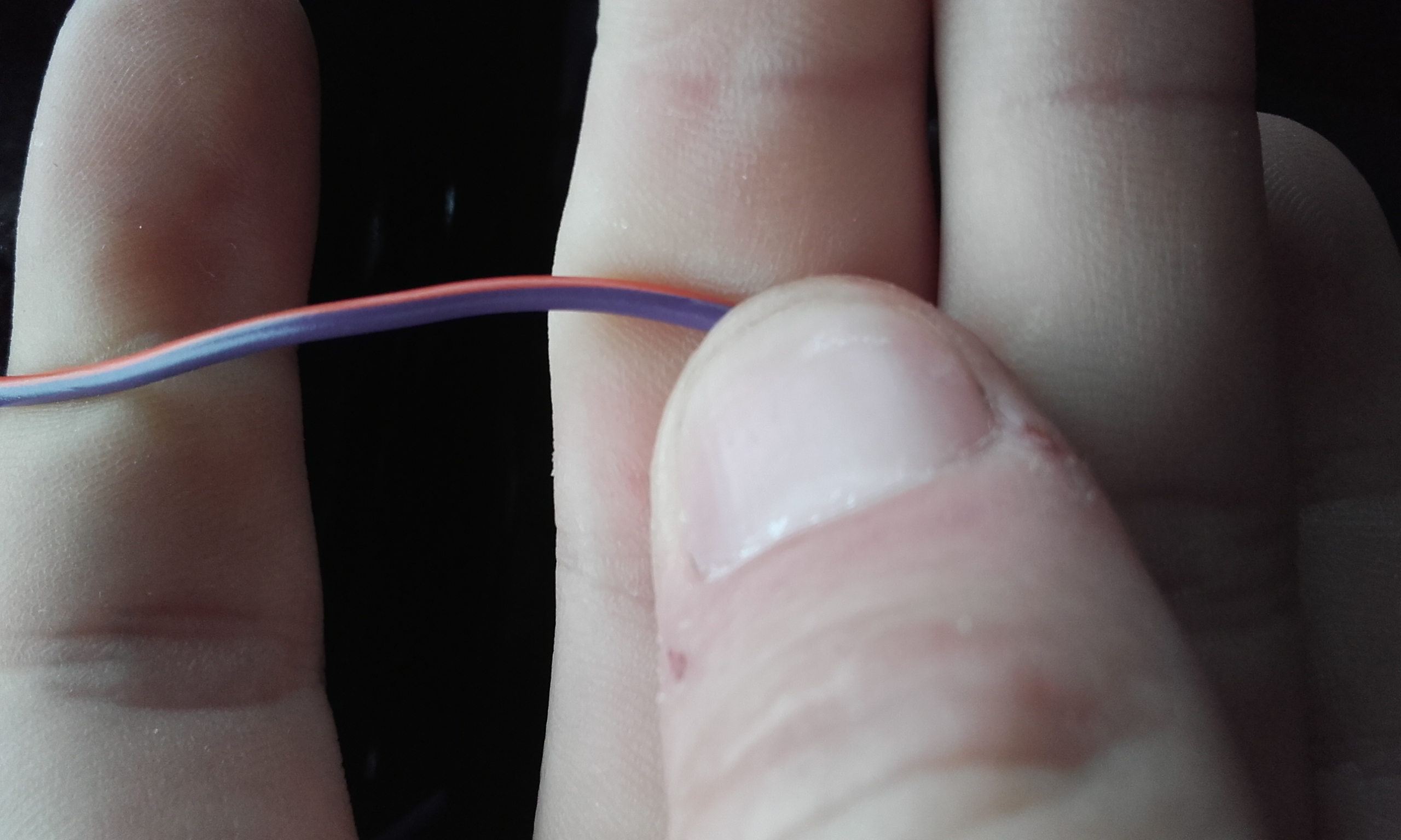

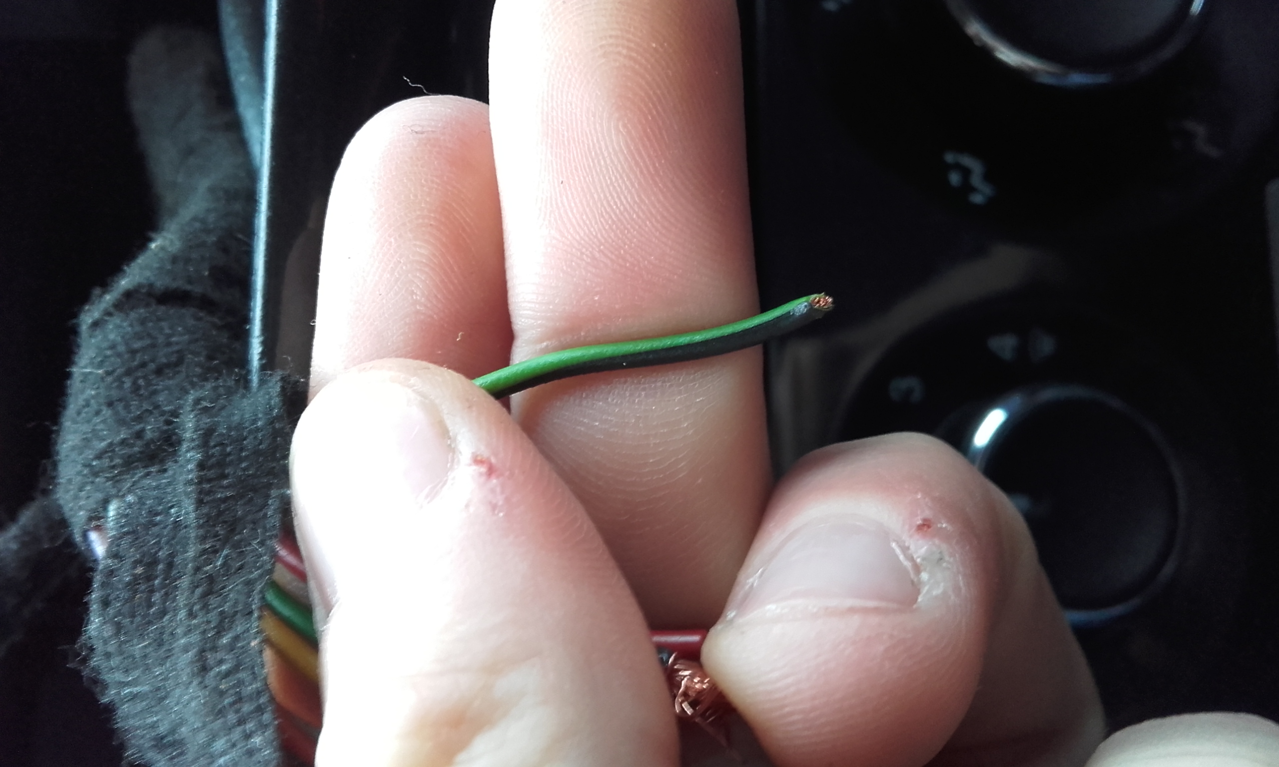

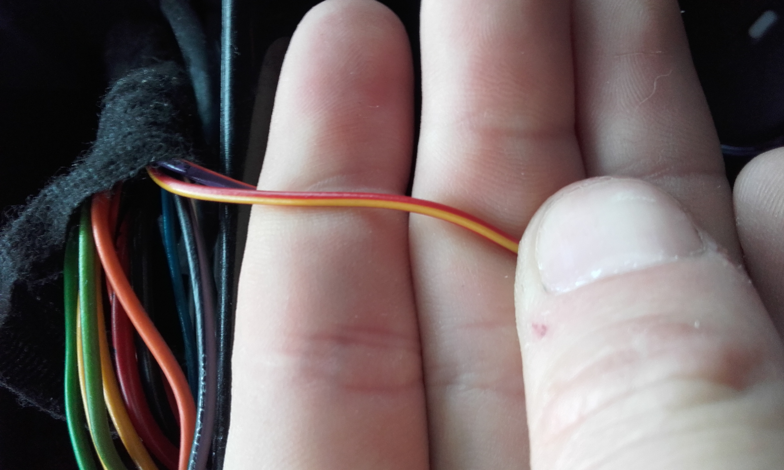

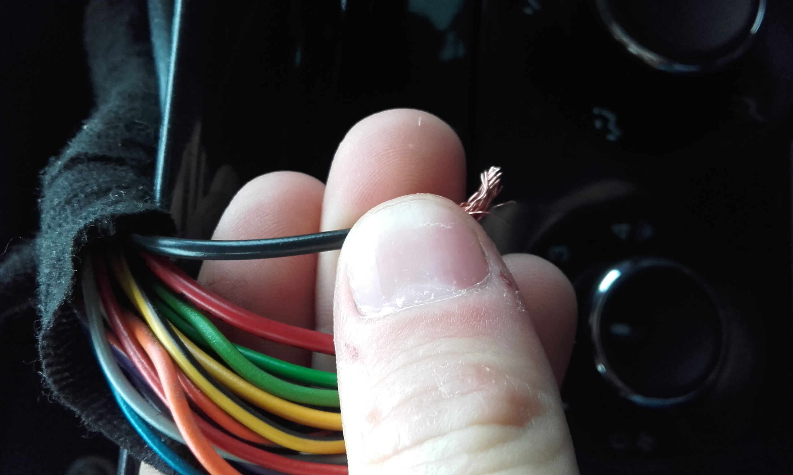

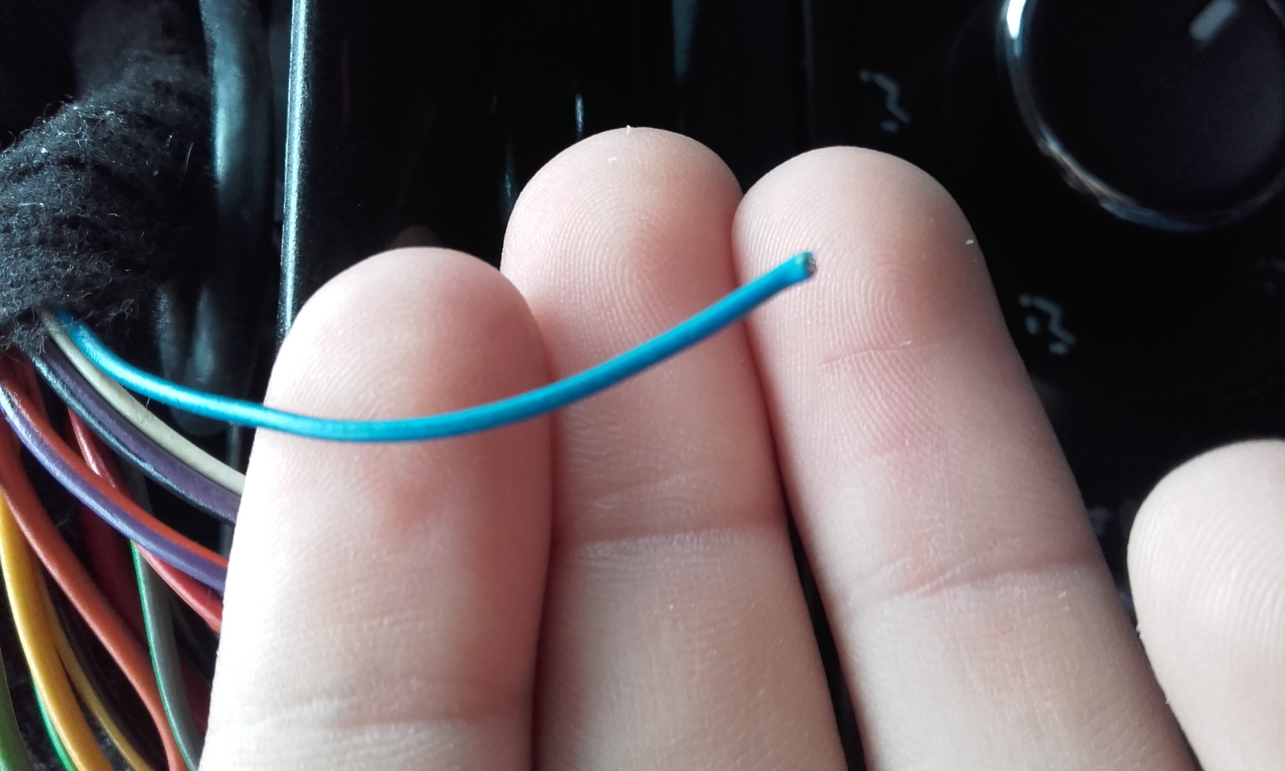

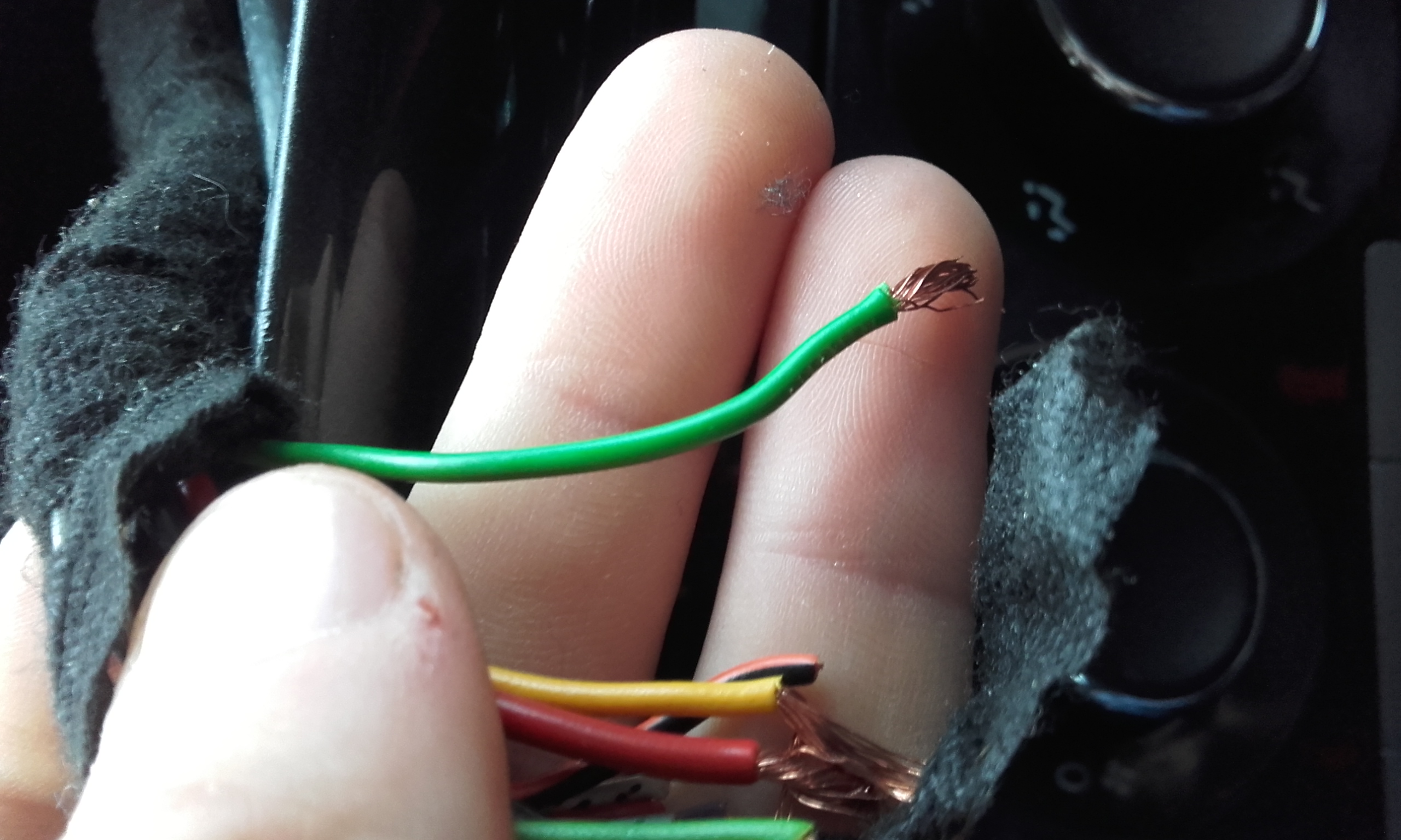

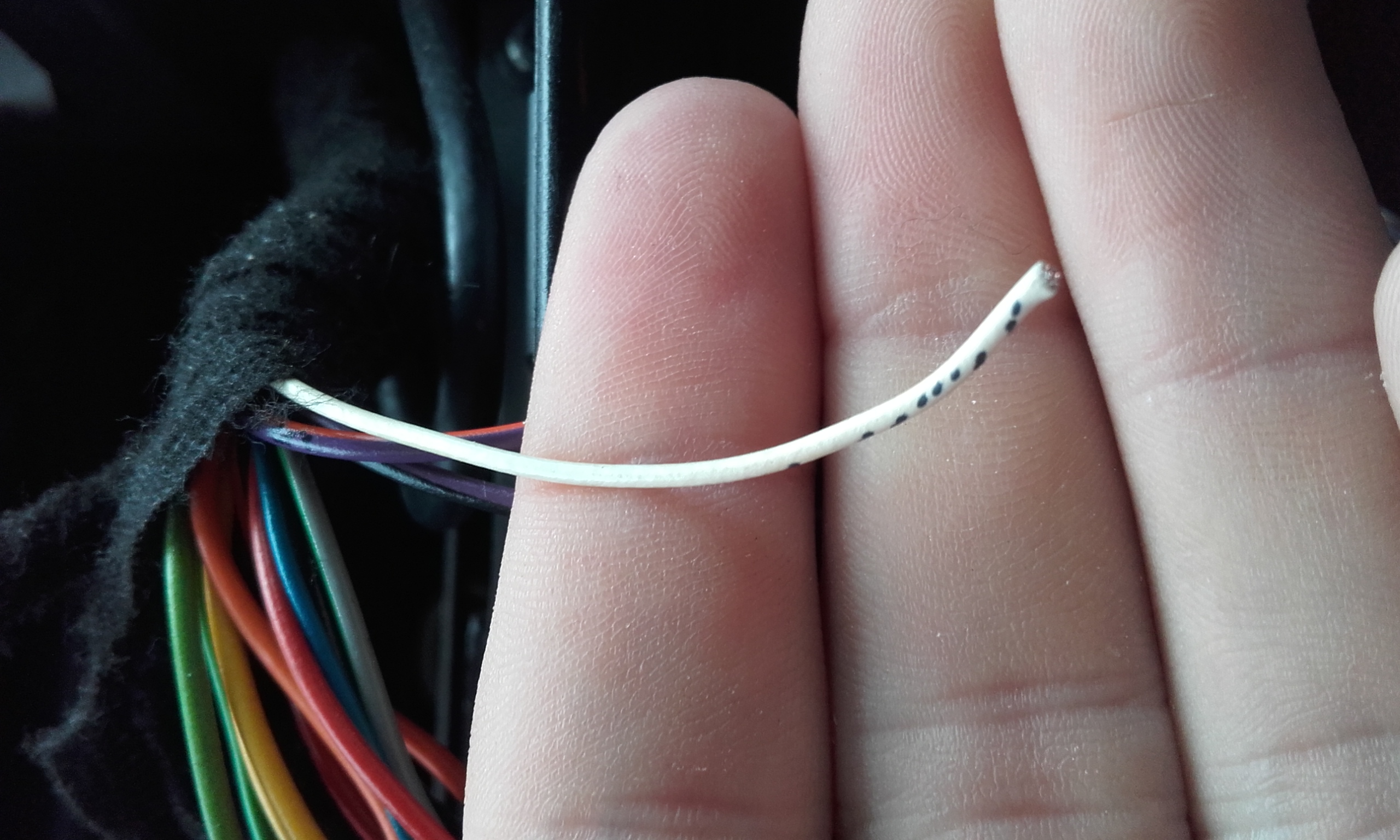

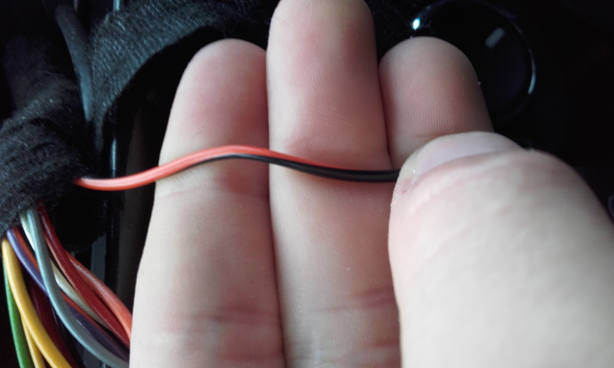

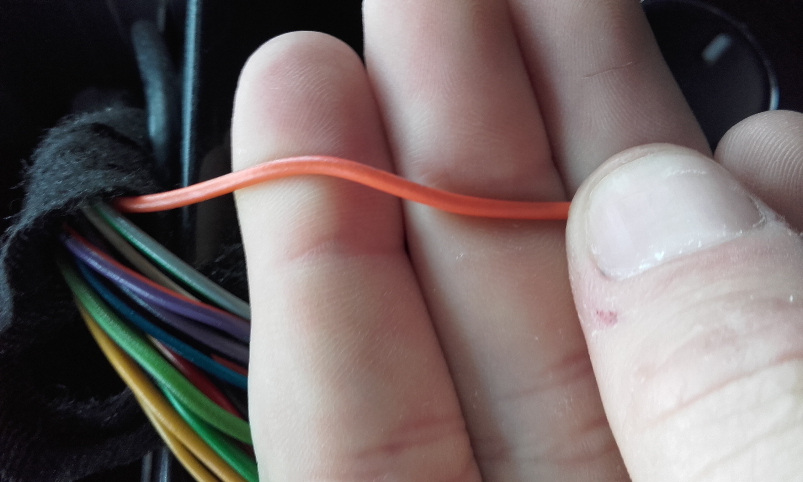

Hi there i really need to know what these wires mean it's from a fiat bravo. They used to be pluged in to the original radio. I wrote next to the colors what i think they mean. Pls correct if i'm wrong
Wires:
Red/green: power (ignition switch)
Yellow: power
Black: ground
White: ?
Grey/green: ?
Blue: ?
Yellow/black: speaker wire
Yellow/red: speaker wire
Purple/black: speaker wire
Purple/orange: speaker wire
Green: speaker wire
Green/black: speaker wire
Orange: speaker wire
Orange/black: speaker wire

Ok, my experrience.
blue and white are CAN wires. Comunication with ecu and i used those wires to make my steering wheel controls to work with aftermarket radio, but i needed connects2 universal adapter.
