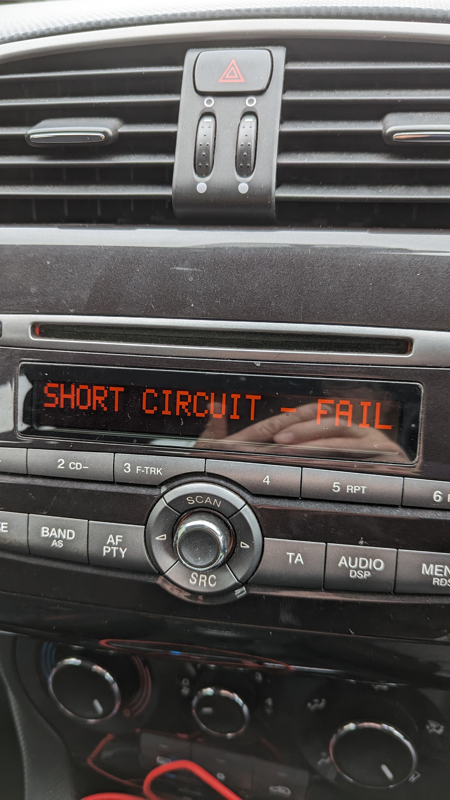

Hi all, having a problem with my radio in that it will not tune.
On the self diagnoses I get what is displayed on the screen, 1 short circuit fail.
2 Antenna open circuit.
Any help appreciated, and if this as already been answered before I'm sorry, please leave a link.
Thanks
Paul214B
Hello,
I'd check the connector and wiring - for the aerial, the common problem is the corroding thread on which it is installed on the car and the base, which is just behind. It needs a proper earth. In a 17 year old FIAT it can be a problem.
