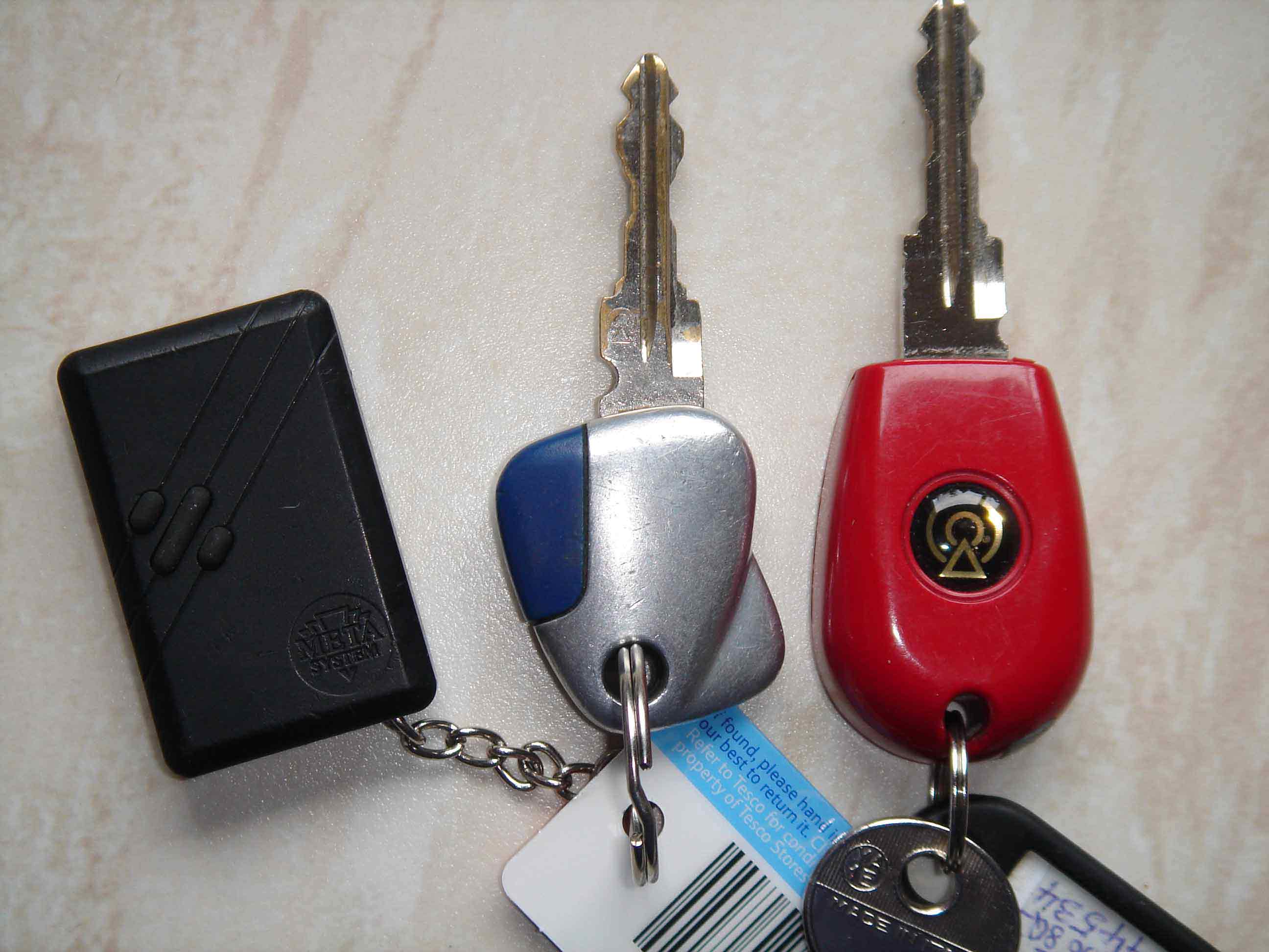

I have a silver and a red key, but it turns out not to be THE red key. It is a copy that happens to be red. Fiat dealer doesn't recognise it, but it has the little symbol with the circles and triangle. Anyway, I would love to have a proper red key as I will be in big trouble if I loose a key and can't replace it, or try to sell (or both). What you have posted is very technical, but in a nutshell, can I determin if the red key I have is a master key re-creation, and if it is not, can I get a real red key, without fitting new locks and ECU?, and who do I go to?

The red key you have is an after market clone of the working key and is quite ok for usage and also for copying from, so you have got back-up already.
The master key is a bugundy colour and as all genuine Fiat keys has "FIAT" printed on it.
You will probably never need a master key, so unless you want one to enhance the resale value of car then dont bother.
To test if its a master :-
turn key on and wait unitil code goes off.
turn key back on again.
If code stays on its a master.
If code turns off its a working key.
PM me if you want a master key, but as said you can live without it.
T.

I tested as above and turned the red key on, off, then on again and the code light went out same as the silver key. I don't have a problen with not having a genuine red master key, but only if I can be absolutely 100% sure that I can get a copy key made, so rather than waiting untill I loose a key, where do I now go to get a blue key made up.? I assume I go to the Fiat dealer to get a blank, but where do I take it to get it programmed as Fiat say they need the master key?

Just take it up you high st to a locksmith, most of them can do the whole job for £25 per key. Getting a genuine one from Fiat is going to give you a headache with programming into car.

Success! I now have a new key, (cost £30) which luckily is blue, so it kind of looks like I have the full set.
