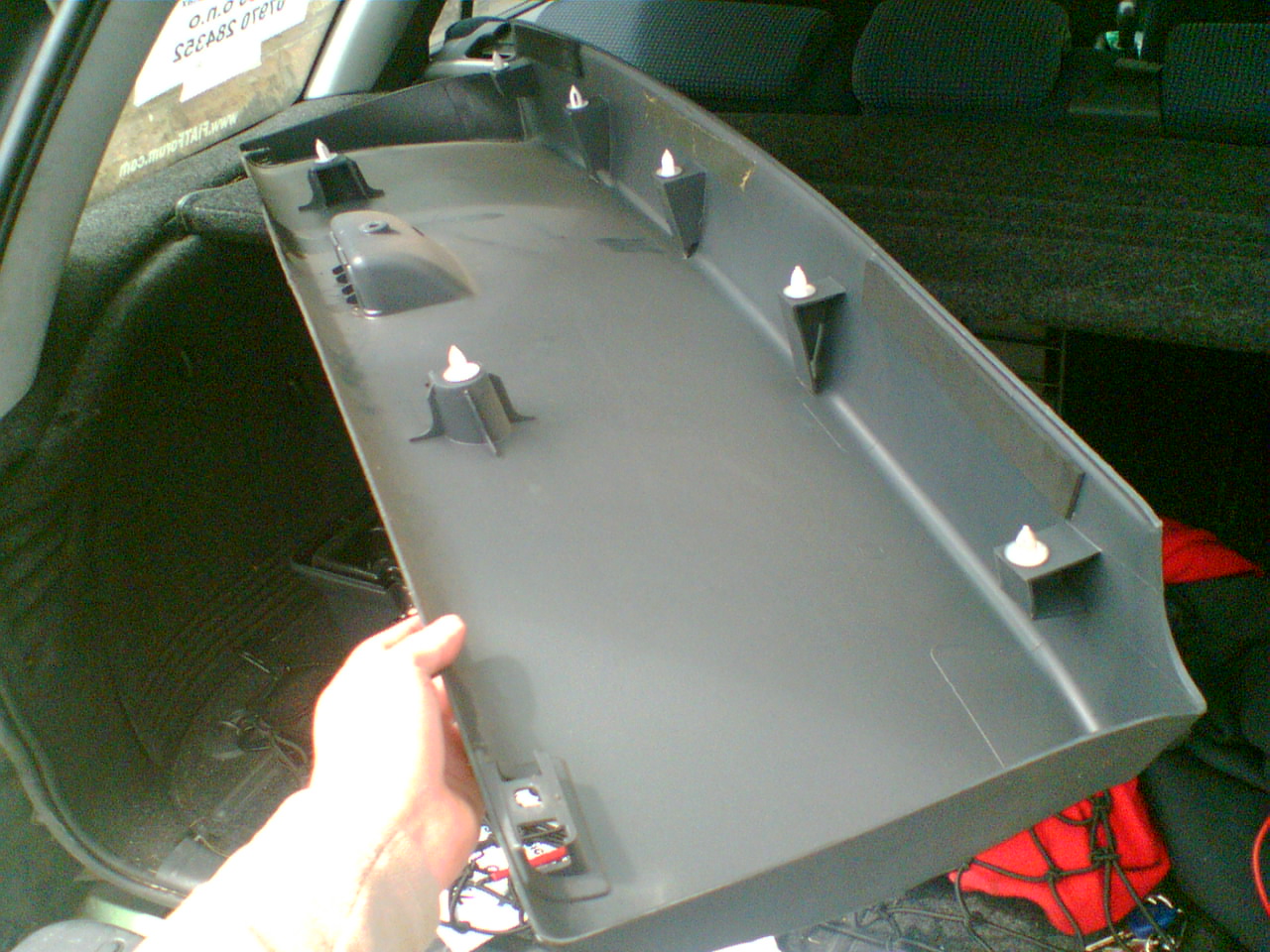

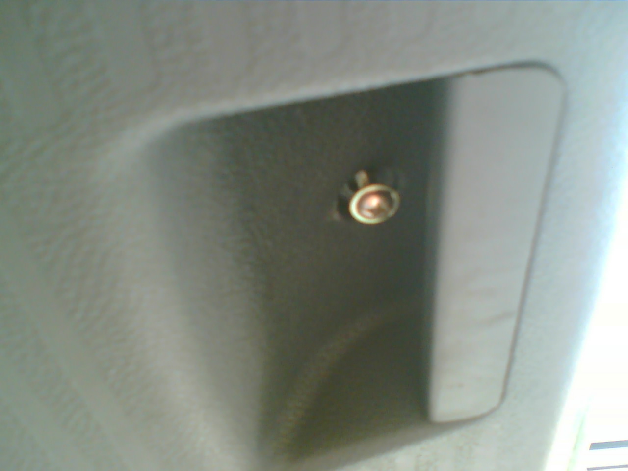

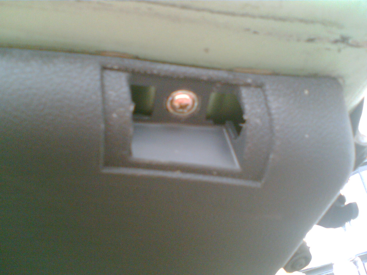

, take off the inner cover off to gain access to the motor (3 screws and pull off the panel to release from the clips) , remove the wiper arm and blade and then undo the 3 mounting bolts to release the motor from the tailgate. once the motor is off there is a small circlip to remove near to where the shaft comes out where the wiper arm is mounted (be careful as they are quite fragile
