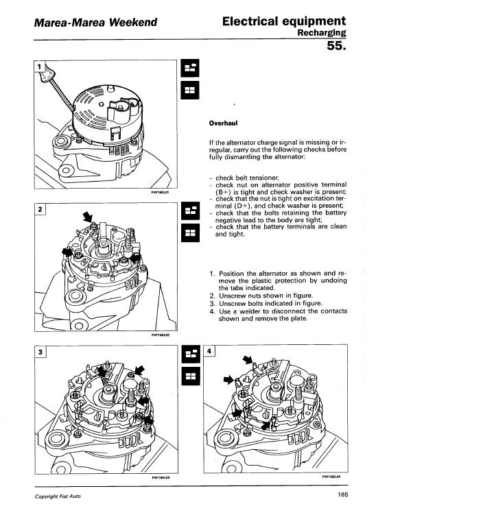

When i came to think of it, it was my old Ford Escort where the voltage regulator was placed in a socket on the rear of the alternator.
As you see in the enclosed files, it's a bit more complicated on Fiats.
You have to remove it from the engine bay to do the job.
One day the charging voltage on my 1997 1.6 16V Marea droped to just above 12V even on high revs.
I purchased a old rusty alternator at the scrappy (the only one he had) and swapped the regulators and that did the job (14,4V at idle).
It took some hours because the alternator is placed behind the engine.
