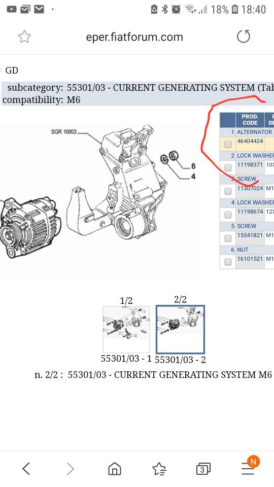

46404424 is the part number you need for the ac alternator Screenshot_20190611-184115_Samsung%20Internet.jpeg
thanks for your help. So the 85 one won't fit if different shape, or.......? I've just ordered the 85 one from autodoc!! Help!! Thanks, Tim
2.0 marea with aircon; any A127IR alternator will do, if you dont get the fiat one you may need to change the pulley.
The non-aircon has A115IR which has the mounting points almost opposite of eachother, the A127IR has them on the "same side".
