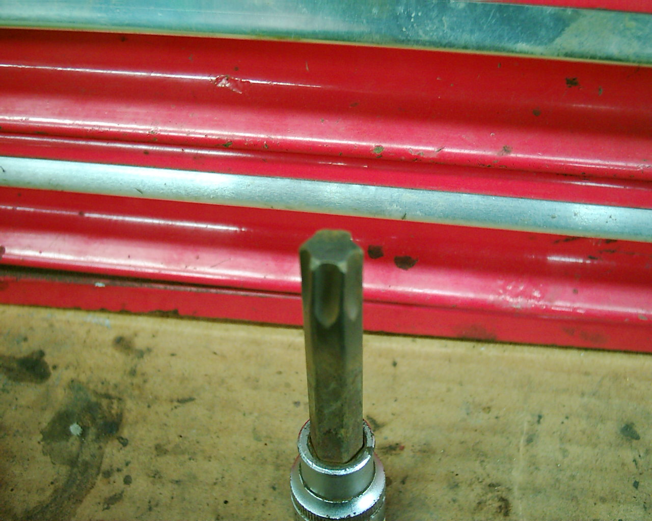

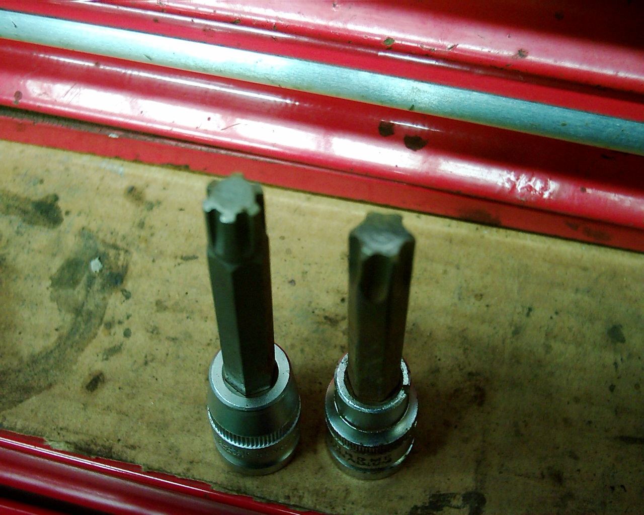

DSCI0006.JPGhi guys, got you pictures of ribe bits and torx bits as promised:)
the top picture is of ribe bits
the middle is of a torx bit (not a good picture i know:( )
the bottom shows them side by side (the ribe is the one on the left if you can't spot the difference by now:D )
hope this has been a help(y)
kev,
yeah...it is good enough. now i am looking for a set of ribe bit. searching online if any.

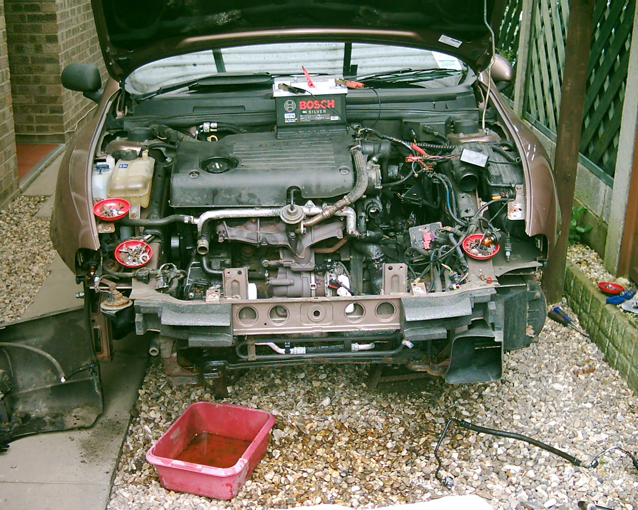

told you all i was gonna be busy:D easter sunday spent getting all the air con pipes and condenser removed for new items to be fitted:D

hello bulldog:D been watching your progress, fun isn't it:confused: keep up the good work, and remember to grease all those bolts when you put them back in(y) your bound to have to take it apart again sometime in the future:bang: :bang: :bang: keep smiling:D :D :D
kev :eek:
what a job u got there? fixing air con system too! u got all the 134a gas and a vacumn pump to suck all the air inside the air con piping before pumping in the gas again.
what actually wrong with your air con system? i had mine recharged with proper pressure and amount. before that it was a bit heavy when the compressor kicks in.
good luck man. may be it is also a good time to service your turbo as well since you have good access to it now. :rolleyes:

hi all, don't worry i haven't gone mad yet:D the air-con situation is all under control:eek: , honestly(y) when i bought the car i was told there was a cracked pipe which was why the air-con wasn't working:eek: question - when does a pipe stop being 'cracked' and officially be snapped in half:confused: anyway i had replaced the offending item with a new one from fiat (£50 odd quid:mad: ) and took it to local air-con place to get regassed only to be told i needed 2 more pipes and a condenser (radiator):bang: just took it apart to make sure what i needed before getting parts ordered, might seem a strange way of doing it but i wanted to make use of the long bank holiday weekend to strip it down to make sure i could get rebuilt in time for work;) i will get all parts sorted and fit them next sunday(y) i took the time to free off most parts i came across( i had already found the radiator cross member was loose and the bolts were siezed) so all was not lost and everything went back together after liberal use of tap&die set and copper grease(y) kev.:D
