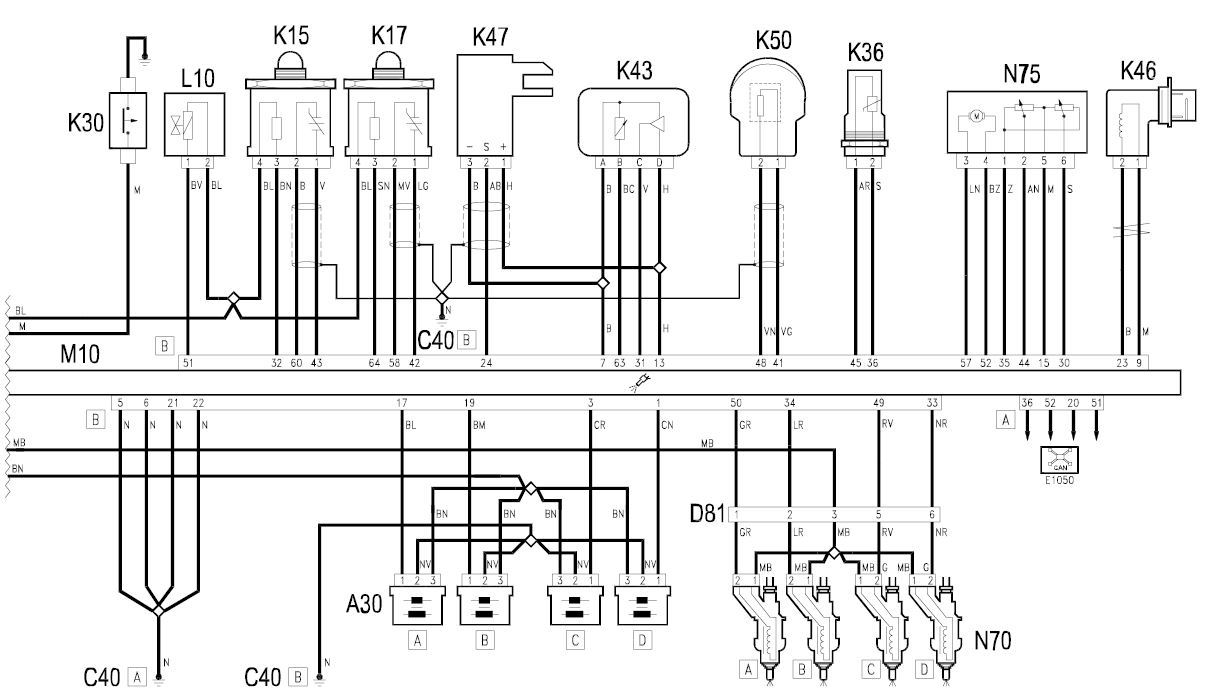

P paulsinger New member Joined Sep 14, 2014 Messages 1 Points 1 Oct 20, 2014 #1 Anyone know the Pin out locations for a 1.6 16v Stilo 2003 please
Davren Moderator Staff member Uploaded 10+ resources/downloads Joined Jul 6, 2008 Messages 16,367 Points 3,858 Location London, UK. Oct 20, 2014 #2 Table below is the pinout diagram for the 1.6 combined air temperature/pressure sensor. Wiring colour codes are: B = White BC = White/orange H = Grey V = Green The sensor is K43 on the wiring diagram. M10 is the engine management ECU. . Attachments 1600 K43.JPG 48.6 KB · Views: 218 1600 Engine Sensors.JPG 115.4 KB · Views: 240
